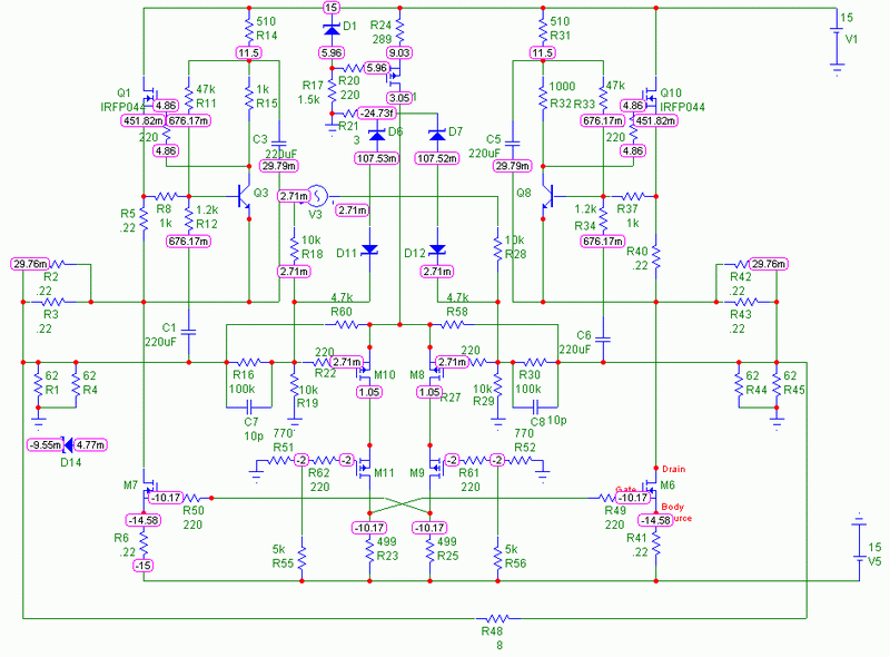

Netlist said:
I guess you mean the -10.16V?
Should be Ok IMO. In the original Grey's sim it also is -10.17V.
Taking in account a supply of -15V, source resistors of 0.22ohm give you -14.58V. Then the Gate is fed with (-14.58V) - (-10.17V) = 4.41V Vgs.
Or I'm I missing something?

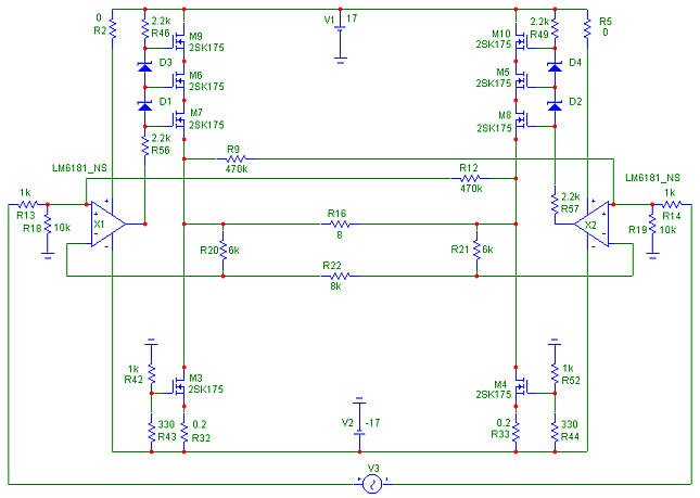

its very simple, R46 and D1 shift the gate voltage of M6 to a higher value against the gate of M7.
As both Fets are source followers, the gate voltages appear shifted on the sources and the drain-source voltage of M7 is held constant.
R56 just compensates a ~4V offset on the output of the op amp x1 that would limit voltage swing otherwise.

Ok here is what I have with the same number as your schematic: simple differential with cascodes and open loop.
10k at the input 10k to gnd of the gain mosfet. The CCS has a 1 500 ohm tpot in place of r24,26,59.
r23,25 =500ohm
r55,56 1.5k
r51,52= I played with values of zeners from 5.1 to 9.1 they all seem to do something. No idea of what's best.
I think I got something like 4 ma running through the cascode reference.
NO r53,54
A few stupid observations: the gain increases with increasing bias up to a point after which it starts to distort. I am running like 12ma bias per side, I think.
The voltage on the loads is unbalanced, i didn't match the mosfets. Looking on the scope the square wave looks alright up to ~70kHz after which it starts to tank.

Looking at the post with the picture of the schematic you will see a major mistake, apart from R53/54.There is one junction between the drain of the left cascoding mosfet and R23 that should not be there.

I did exactly what the theory says. Put at least 2V across the gain device. It is now 2.02V
Trimmed resistors so the voltage is exactly -2V at the gates of the cascodes.
All I get is a nice oscillating amp.

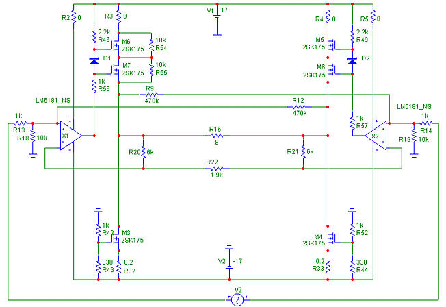

Hugo,
did you already look at my cascode (?) ?
It works perfect on the sim.
In your circuit are M9 and M11 the cascode Fets ?
If yes, how should that work ?????? No connection to the signal...

Basic circuit is a single ended classA monolytic susy with 15V rails and static current source for simplicity.
It idles @ 1.85A per Fet and dissipates 110W.
Modified circuit still operates in single ended classA and still idles @ 1.85A per Fet and still has static current sources.
No kidding:
The circuit dissipates only 60W 😀
And this is just first try, no tweaking yet.
I believe it can go down much further.
Schematic soon...

Stefano
The picture is not the best I have but:
Take a look at the gates of the gain devices: 2.71mV.
This is not 0V but close to.
The drain of the current source mosfet is at 3.05V.
The drain of the gain device is at 1.05V.
3.05V - 1.05V is 2V across the gain device.
I can change the gate voltage quite a lot without effect on the source voltage. I tried 20mV without change.
No way I can do that without a complete unbalance of the other voltages. Especially the 2V over the gain devices.
