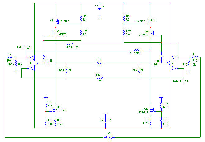

stefanobilliani said:I would prefear to cascode the diff pair first , before of do it for the power section.
Comments are welcome🙂
Do the bjt work better here? I was thinking to use all mosfets for also use a single voltage source for their gates (each with its usual 220 ohm resistor) to get more of a symmetric differential.

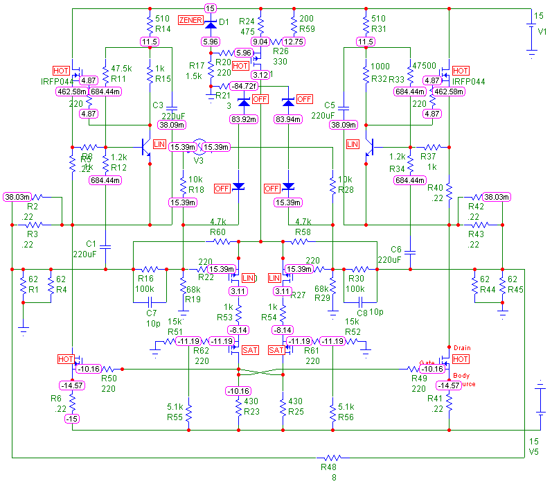

Grataku, I agree, if we don't try we will not know.
That's why I spent a few hours more and came up with this.
I managed to get rid of the DC. A couple of mV is easily trimmed if necessary.
Now can some cascode guru tell me what's wrong with the input diff-pair and cascoding mosfets? (All irf9610) Why do the four mosfets not turn on? The drawing is a bit difficult to read. It shows the status
of all mosfets: HOT, SATurated, LINear and the voltages.
/Hugo
/Hugo
stefanobilliani said:Hey...!
What are those R53 and R54?
Let them out, please.
I did. Probably a misinterpreted sentence from Nelson saying to 'load the Drain's with 1k or so'.
stefanobilliani said:The gates of the "cascode" fets should be at a higher voltage ,something like -5 volts.
I guess I'll need another way to implement this thing.
No way to make this work. With cascode gate voltages of -5V and diff-pair gate voltages of -1.94 all Mosfets are on. But then again the DC is untamable:7.57V absolute DC. Fiddling again with the DC adjustments results in shutting down the mosfets.
Thanks for the help anyway.
/Hugo - not giving up...yet. 🙂

Hugo,
thanks for taking the time while other are out grilling and chilling.
I noticed the 11 V across r23 and 25. WHy is that so high? That could easily cause the conduction mismatch and the high DC.
Should be Ok IMO. In the original Grey's sim it also is -10.17V.
Taking in account a supply of -15V, source resistors of 0.22ohm give you -14.58V. Then the Gate is fed with (-14.58V) - (-10.17V) = 4.41V Vgs.
Or I'm I missing something?
/Hugo - Had his Grill-and-Chill yesterday. 😎

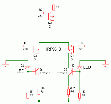

Some time ago I had the idea to put Fets in series, but for other purpose: To half the voltage across each transistor and thus half the power dissipation per Fet.
So it would be possible to have much higher bias per Fet and stay in the linear area.
With very little mods this may be does not look like cascode, but works like.
See schematic.
Voltage swing across the lower Fet is only 1/20 of voltage swing of the upper Fet.
I also tried to connect a zener from the gate of the cascode Fet to the output and a resistor from the gate of the cascode Fet to the + rail.
Did not work, no idea why...
See schematic.
