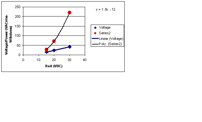

Here are the results of my measurements for the AX with single output device per side, with 0.22 ohms rource resistors. Everything was readjusted at each voltage before measuring, the AC gain resistor was recalculated and replaced approriately to produce the 50% current gain. My circuit does not have protections on the gain mosfets.
I ended up measuring the output voltages right about .5 V from clipping for +/- 15V rails and for +/-20 V rails on 8 ohms load, only. The input was se, oh yeah, I forgot to measure the gain but who cares? I used a differential probe to measure the outputs...what else am I forgetting in my experimental section?? 😉
The graph shows the power and the output voltage. Extrapolating to Nelson +/- 30VDC rails gives 220 W vs. 200W declared by Nelson. 10% error on a two point fit is more than good enough and suggests that my measurements of ~27 W at 15 VDC and ~72W at 20V rails are reasonable.
The agreement with the calculation spreadsheet (Berekening.xls) is very poor for the 15V (~25% discrepancy) rail but it becomes better at 20 V (~13% dicrepancy) rails to suggest that there are elements of non linearity at low voltage that ar not properly being accounted for in the calculation.
