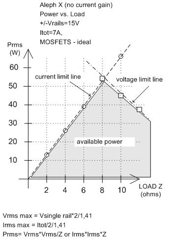

Ohms and limits
jarek said:
how Nelson got more then 30 W at 4 ohm before clipping with 2 A biased The Zen Variations - Part 2?
My understanding of the key point:
  1. When Zen (and Aleph) has no Aleph current gain circuit, the maximum output current is independent of the load impedance.
  2. But, when it has Aleph gain current circuit, the max output current is dependent upon the load impedance to certain degrees.[/list=1]
    Therefore, there are differences in power calculation between Case 1 and 2.
    JH
  2. But, when it has Aleph gain current circuit, the max output current is dependent upon the load impedance to certain degree.[/list=1]
    JH
  1. Not quite.The current gain is simply the ratio of Idle Current divided by Peak Current and is independant of load impedance etc. In a normal single ended amp biased by a constant current source, Idle Current = Peak Current but with an Aleph with AC Current Gain = 50% The peak current avialable is twice that of the bias current.

AudioFreak said:
Put simply, No.
Good morning.
You are right. Not + more, but + 0.
When the output peak current reaches double the idling current, the voltage figure across the Source resistor is locked.
Therefore, the size of peak current is independent of the load impedance whether it has the constant or Aleph current source.
JH
PS. It is pity that I have no copy of the Aleph patent.
You've got it 🙂
I might also point out that given that the sensing resistor/s is in series with the load, the feedback to the current source is relative to the current thru the load not the voltage across it as you stated a couple of posts back. The sensing resistor/s would have to be in parallel with the load to give feedback dependant on the voltage across the load. In any case, the peak current is fixed.
