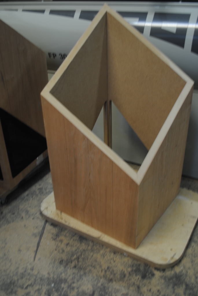

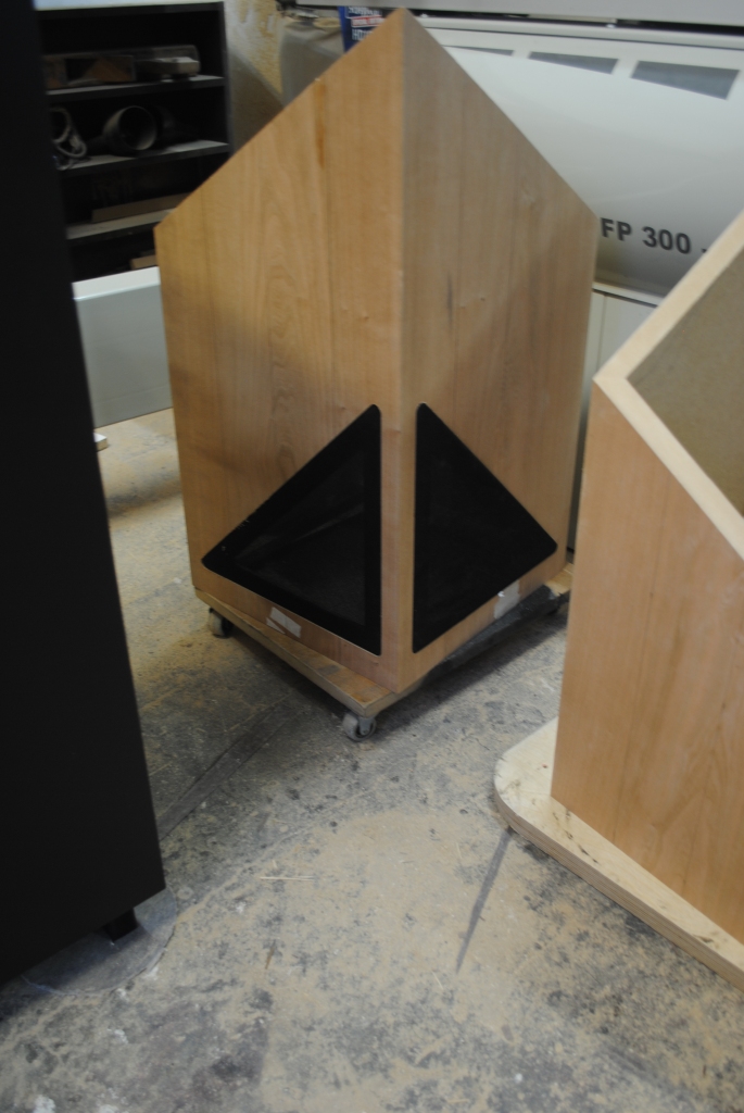

After a few failed attempts at constructing a shorter and wider Shahinian Starter-like speakers. Attempts at cooperation with a few cabinet makers proved to be too difficult. Myself I am no carpenter, and the "diamond" shape in wood is too difficult for an amateur hobbyist.

By the way, you can easily get the the "diamond" shape inside the square box, by simply adding strips at the corners.
Okay, if you say so. 🙂
? What do You mean?
I wanted it outside - it's about the angle and diffraction
If you want the diament shape, meaning the look of the volume, you add strips at the corners inside, you get 8 sided cross section (~ like the WLM Duo). If you want the look of the Shahinian Starter, make the square tall box and cut it at an angle, starting from one corner to the opposite corner.
