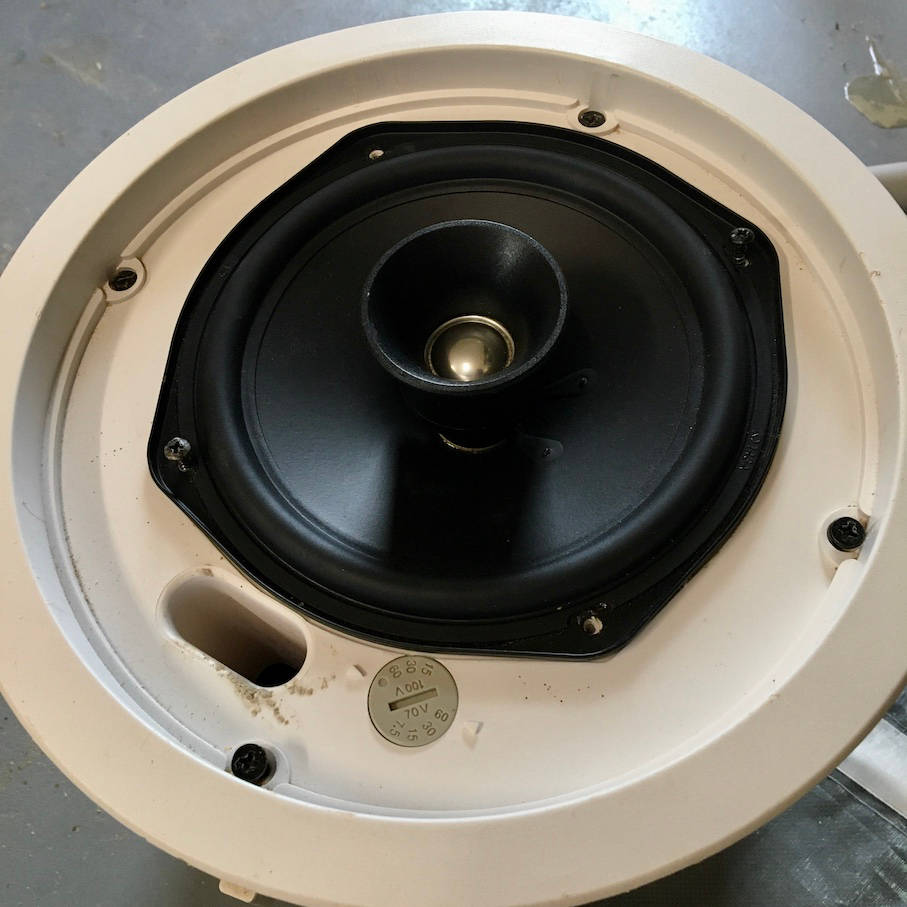

I tired my JBL ceiling speakers is an up-firing mode. They worked and were reasonably omni directional. Getting off to one side where a speaker was between me and the other speaker wasn't great. But that's extreme.
Overall I didn't feel that they imaged well and they sounded dull. Not too surprising with the tweeter in a little wavegude. See photo below. Might have been missing some upper mid from the cone, too. Played in a normal mode facing the listener they were much nicer.
They probably need a cone shaped reflector above them, like so many omnis use. Interestingly the metal grills do have a thin layer of poly batting on them which does help spread the sound a little.

Which is odd, because they are designed for down firing use. That's just a 180 degree flip. Many up-firing omnis use sound spreaders, probably for good reason. I'm not sure that would work with these speaker, tho.
It was worth a try, for sure. :checked:
