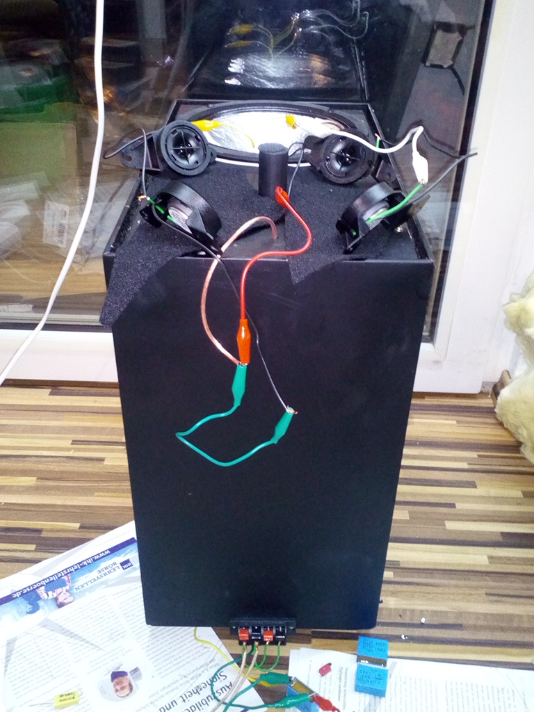

Sonab OA-4 enclosure with new drivers. Loudspeaker for being put against a back wall.

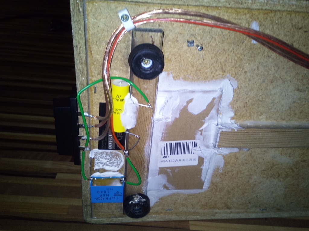

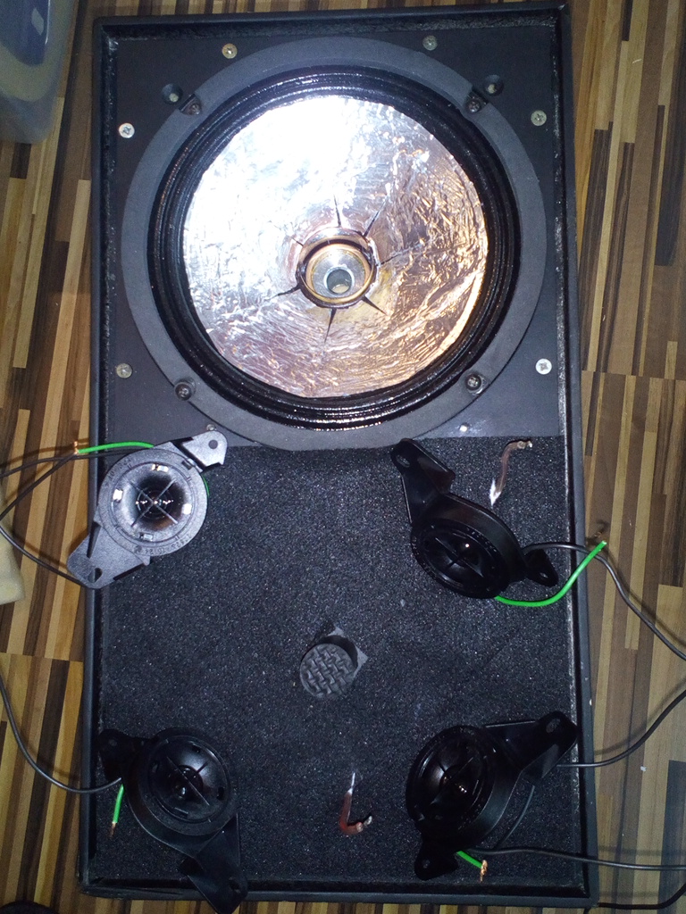

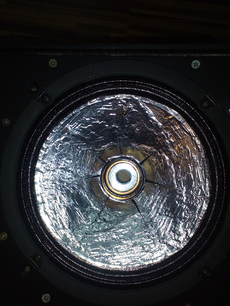

20cm driver fullrange driver with copper ring (working up to 4khz naturally) with aluminium foil on both sides (sandwich-design) and four tweeters in 2-2 design - 12 Ohm each (impedance total 12 Ohms) with only one capacitor. Tweeters are legendary Audax copies known for being able to work just with one capacitor (ferrofluid and diaphragm a mix of cone and dome).

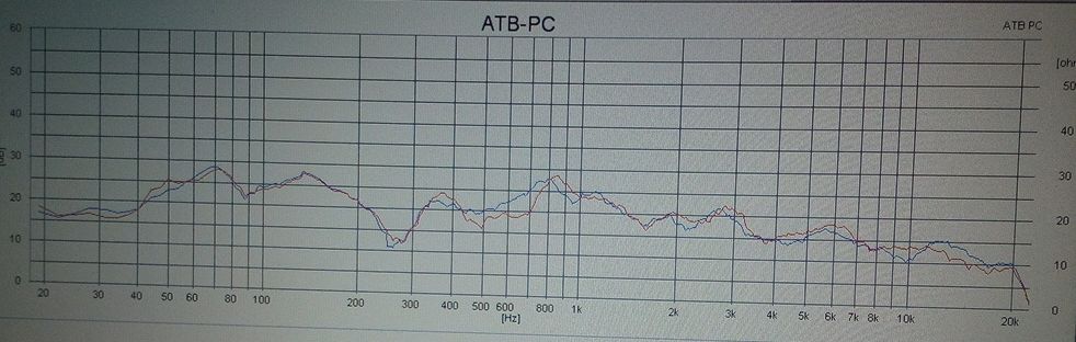

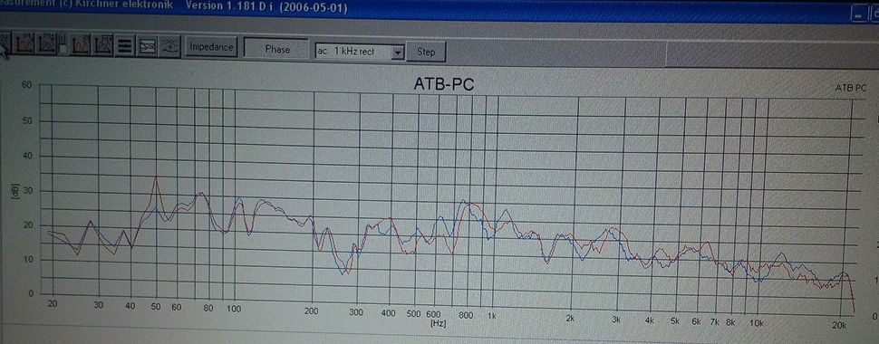

Works nice with driver against the wall but some suckout at 260 Hertz which is the only part where I use dsp control to fill it up. Maybe this depends heavily on your room and if you have a resonance from floor to ceiling.

Measurements are far field approx 2.5 meters away in listening height. This is the true in room response.
Quite important in my listening experience: below the the tweeters I added some thin absorbing felt. I usually always put on the loudspeaker fronts some damping as known from loudspeaker manufacturing history for better imaging, eliminating some of the first reflections from the cabinet itself
