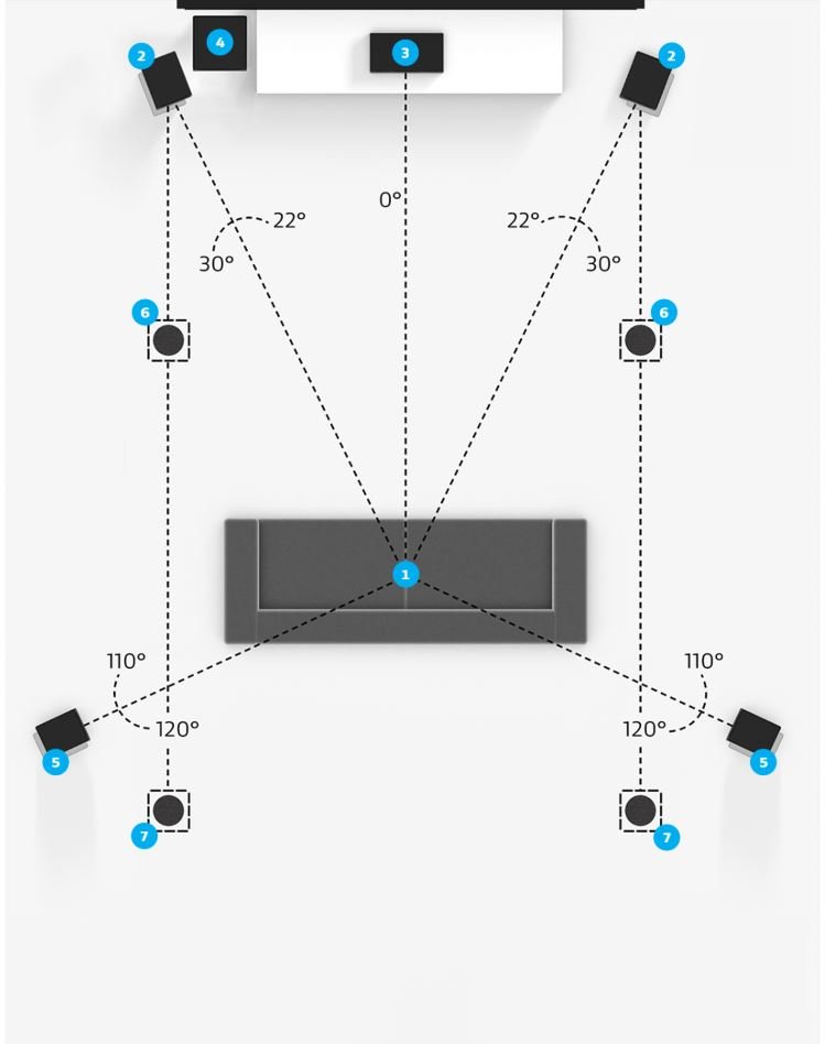

As an update on this.
I "finished" the "soundbar" about a year ago (or is that 2 years???), but have been working on the other aspects of the HT ever since then.
.."other aspects" being a large riser platform for the HT Recliners.
Anyway, I did come across a DISADVANTAGE to Floor Coupled Up-Firing Loudspeakers. (..and it's something I thought would likely be a problem when I started it.)
The problem is when you have a Dolby Atmos setup AND you have a setup with front drivers that have a naturally "diffused" (combed result) and/or a naturally lower pressure (even if corrected with DSP) treble response.
In my case I've got both: no tweeter and a horizontal line of up-firing 4" full range drivers (salvaged from an array). Note: the pressure is corrected in DSP at the listening position, so it's not like treble is basically missing.
It's OK if I do NOT engage the FRONT ceiling speakers (which are "downward-firing").
However when activating the FRONT ceiling speakers: dialog tracking becomes at best "swampy" - resulting in very indistinct dialog tracking across the screen.
A tweeter should solve this problem (and I've got them to do an additional small tweeter "bar" right behind the main "sound bar"), but I'm still working on the riser platform. 😱
-yes, definitely a disadvantage for Atmos ..and probably a disadvantage for ceiling speakers OR other up-firing speakers designed for those two L & R front effects speakers that Atmos provides. See #6 in picture.
I think Atmos is essentially trying to achieve what an up-firing loudspeaker does (increased monophonic emphasis and later arrival of treble giving a greater sense of height), and having that effect "doubled-up" screws-up the sound (..or rather dialog tracking on-screen).
