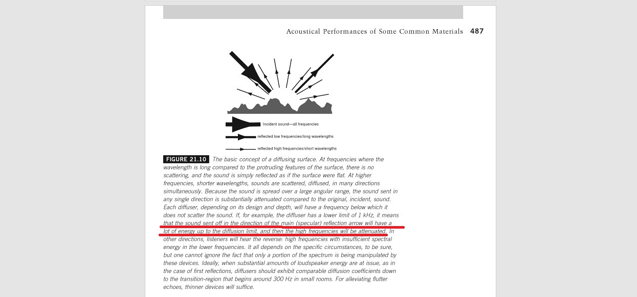

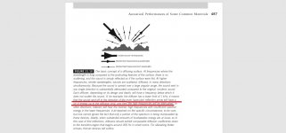

No single reflections - e.g. from a booshelf placed at a side wall - will be "smooth" in spectrum. Even if the loudspeaker was radiating a "smooth spectrum" towards the shelf, in an appropriate angle to be reflected to the listening seat, that will not yield a reflection being "smooth" in spectrum: The spectrum of a single reflection will be "scattered" instead.
by "scattered" You really mean "filtered"? If not then what else?
Do You believe in a typical living room it would be "scattered" in the most important frequency range of
from 200Hz to 800Hz or so

If you want the early reflections and reverb to have similar spectrum - averaged over eligible directions of arrival and also time - like the direct sound but at the same time minimize (also destructive) interference, then making use of diffusivity seems a much better advice instead ...
But isn't it that it is not that easy to achieve a sufficiently broadband diffusion? I mean effectively covering the important frequency range of 200Hz to 800Hz?
OTOH if it is not broadband enough then judged from perspective of an early reflection spectral content it just acts as a filter, not very unlike an absorber (see attached comment form Floyd Toole).

graaf said:OTOH if it is not broadband enough then judged from perspective of an early reflection spectral content it just acts as a filter, not very unlike an absorber (see attached comment form Floyd Toole).
Diffusion seems only practical, say from midrange on upwards, that is true.
