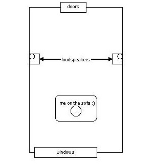

Concerning "floor coupled upfiring" position, which is the topic of this thread:
"Floor coupled upfiring" means: Edge position of the loudspeaker in the room.
Idealized edge and especially corner positions reduce the number of mirror sources in proximity to the loudspeakers.
When using monopole sources , this is an option to generate more coherent wavefronts as would be possible using monopole soures having distances to the walls in the order of low frequency wavelengths and fractions of those.
It is reasonable, that by this "room constructed directivity" an advantage in coherence especially from above the Schroeder Frequency until midrange can be achieved. That frequency range say from 200Hz to 800Hz or so is most important in localization because of
- the stereo system working well here (above about 2Khz does not give very proper cues depending on signal shape)
- there is spectral dominance in localization cues
But the "edge or corner" placed speaker has potential difficulties or drawbacks also:
- in providing an adjusted stereo triangle to the listener in every room's situation. In fact this is hard enough, with speakers that can be placed rather freely ...
- in having a - positive or negative - angle of elevation, exciting HRTF cues regarding that angle
- real edge and corner positions may not be ideal at higher frequencies, where practical distances of sound sources become relevant for interference, as real sound sources (drivers, tweeters) have non zero distances to the adjacent walls and the floor
- and possibly also in exciting the room in a balanced manner below Schroeder Frequency due to "non neutral positon" regarding LF mode excitation in many practical cases
The competitors of "edge or corner" placed designs without "inherent directivity" are naturally those systems that provide "inherent directivity" even and especially from the lower and mid frequency range on upwards.
Such systems like dipoles and cardioids (but also other concepts having higher DI like arrays and larger waveguides), may also provide more "coherent wavefronts" from upper bass to midrange, but may be placed more freely to make up a stereo triangle to match individual geometrical restictions of a listening room.
Opting for "edge or corner" placed designs in the end is opting for "DI around 6dB" in upper bass and midrange (e.g. dipoles and cardioids have DI around 4.8dB, monopole in front of a wall has 3dB).
If a well made "edge or corner placed" design can make up a proper stereo triangle, then it may also be a cost saving alternative to systems having "inherent directivity", which has to be payed in terms of higher cost in construction especially for the lower frequencies.
Of course this is not true as a generalization. I was referring to the sketch decribing the loudpeaker's positions in the initial post of the thread:
http://www.diyaudio.com/forums/atta...ges-floor-coupled-up-firing-speakers-room.jpg
BTW most loudspeakers may be considered as "floor coupled" in the bass ...
Edge or corner position is IMO like "wave guiding" the loudpeaker just using the room's walls. Aligning the radiation axis of the drivers at higher frequencies with the radiation axis of the wave guide is just kind of consequent here.
The improper match of the drivers to the "room corner waveguide's" throat at higher frequencies - which is ineviteable especially for the tweeters in that approach - would result in even more severe reflections otherwise.
