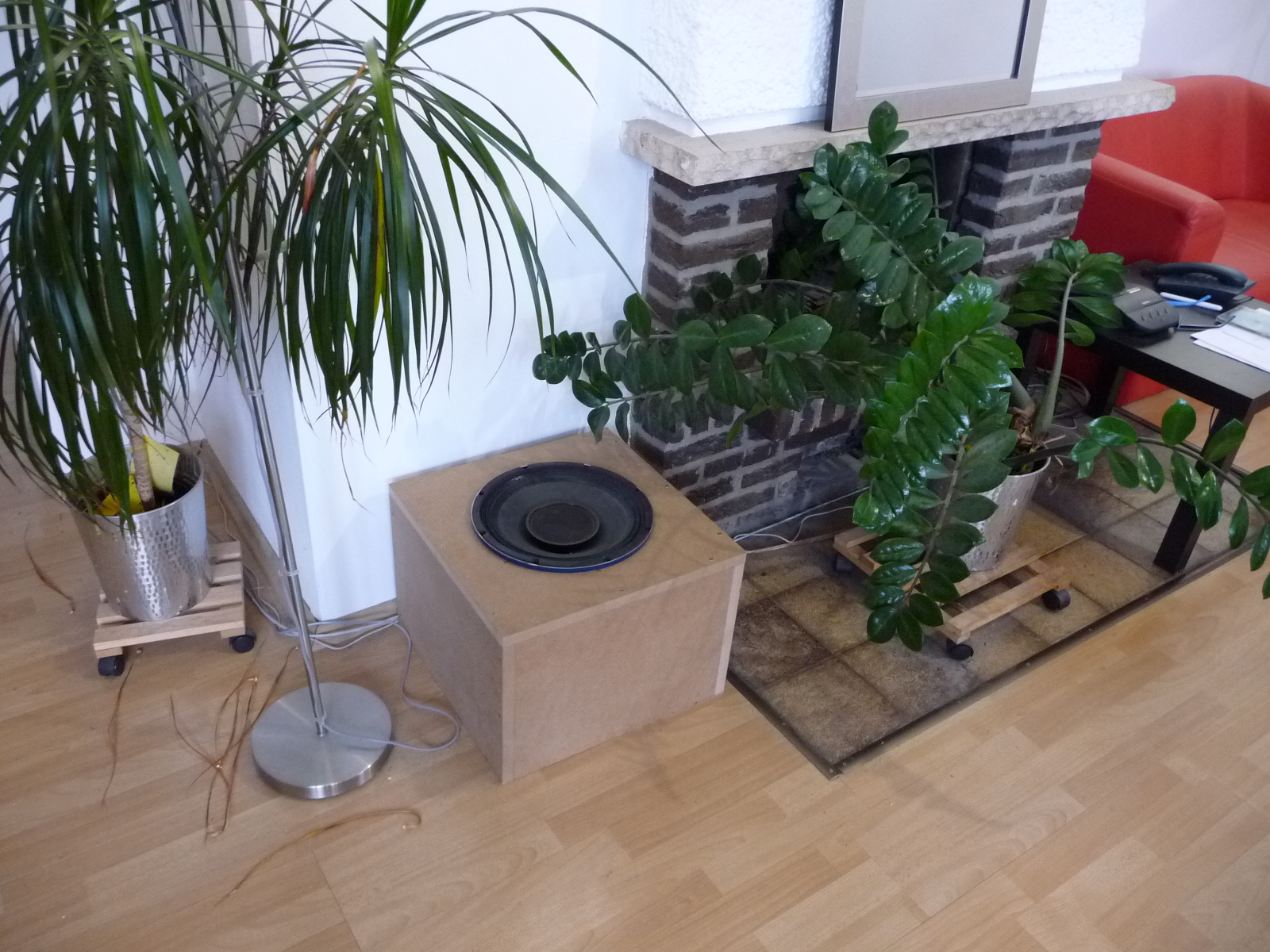

A flooder with 12" full range Monacor SP-30PATC
Breitband-Lautsprecher mit Lambda/4-TL | 4gang
I've tried that, with better mechanical isolation between driver and desk.
With some helps of EQ, it can be very good actually. Much better than those plastic boxes.

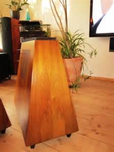

Kibri Naima
Lovely looks. I just stumbled upon this thread and it is pretty long to read all of it but I always liked Walsh type loudspeakers. I think John Strohbeen's Ohm makes them now.
