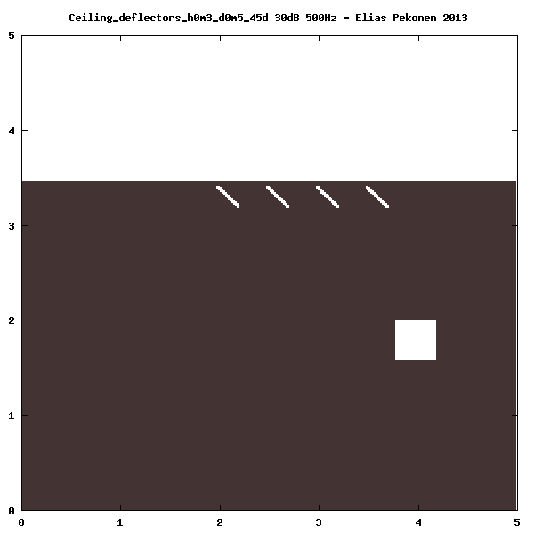

I tried ceiling deflectors in FDTD simulation.
The speaker is 40cm box with 30cm radiator. Freq 500Hz. Floor is removed and vertical walls are absorptive. x and y axes are in meters.
This type deflector does not remove ceiling reflection at the listening position, but it breaks the wavefront spreading the energy in time domain. A diffusor ;)
Thanks! What happens when you place them like this:
attachment.php
Also try longer panels and/or closer together.
For normal living room environment, the situation I'm most interested, I think the ceiling deflectors are very unpractical and not appealing. There should be found another alternative method to achieve low floor (and/or/or not ceiling) reflection at the listening position.
Could you run a simulation with the deflectors oriented like shown in my last post?
