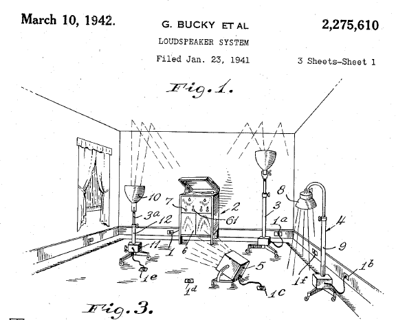

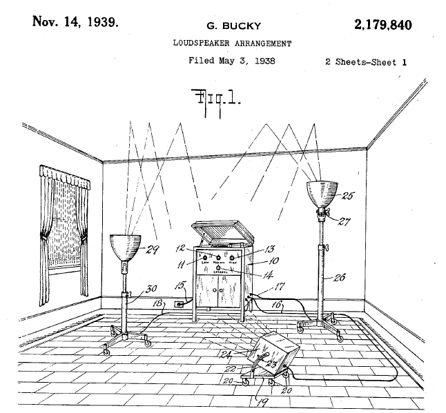

Here is some early flooders. In 1938 G. Bucky visioned the sound to be coming from ceiling reflections.
attachment.php
