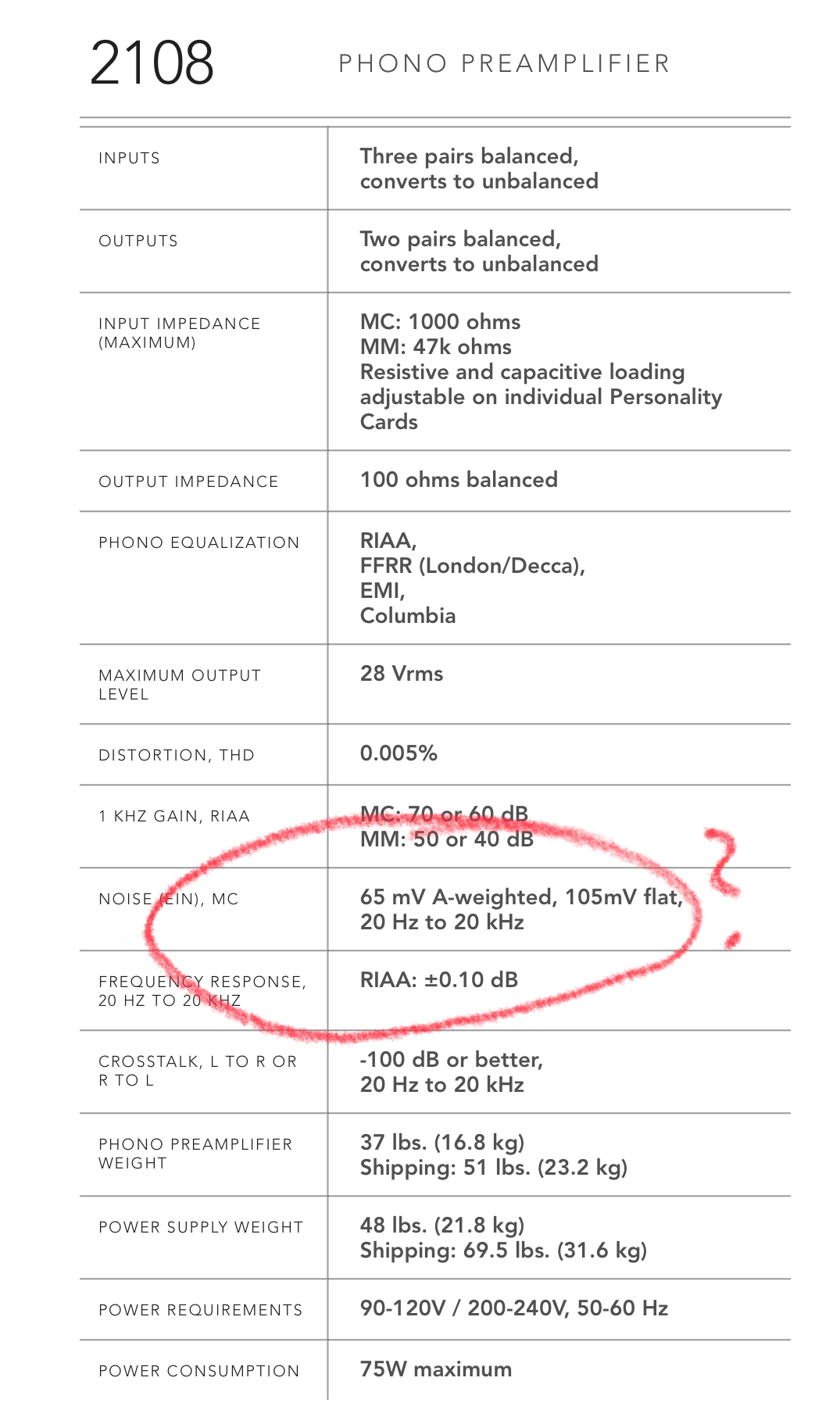

Specs. Noise not specified properly and no overload info. Doesn't fill one with confidence. A lot of the other specs are fluff.
Fir the Boulder the literature says fully balanced throughout. It's difficult to see on the product images, but i can only see 2 wires connected to the xlr input? And the specs say converts to unbalanced? Not criticizing, just trying to understand.

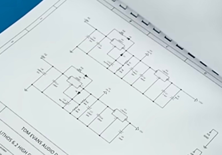

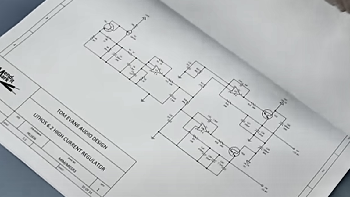

Well, that’s just too bad for Tom Evans and co., as I’ve already got some clear screen captures of the entire Mastergroove signal path. Although the individual component identifiers on the Lithos regulator screen capture are not legible, it still makes it possible to see the regulator topology and component types. From there, it’s fairly easy to figure things out well enough to build a close clone.
To be clear, at least in the U.S., it’s not a copyright violation to use a schematic of a back-engineered circuit to build a device. Selling of the schematic is what is copyright protected, not the building of a physical circuit from it. As for patented circuits and other innovations, you are free to build the physical object, but only for non-commercial use. In fact, the government’s interest in granting patents is to encourage further innovation based off of commercially protected ideas. Experimentation/development is therefore encouraged. So, our DIY efforts are free and clear, at least, here in the U.S.

There seems to be two Lithos regulator topologies. A simple, higher power regulator formed by cascading an LM317 adj. and 780X three-terminal ICs identically for both the POS and NEG regulators. This is done so as to not utilize their negative counterpart devices, the LM337 and 790X, which perform worse. (Or, perhaps, they are the LM337 and 790X, I can’t read them.) This is fine, so long as separate transformer secondaries are utilized for each. The benefit of such cascading is the doubling of power supply rejection. This has been done many times before.
The other Lithos topology is more complicated, yet still doesn’t seem like anything unfamiliar, judging from my blurry circuit capture. It looks like a bipolar regulator utilizing NPN and PNP Darlington pass transistors, which are controlled by two op-amp error amplifiers. The one unexpected feature is the production of the voltage reference, where it looks like an LM334 type constant current-source feeds a resistor to produce a positive reference voltage. That voltage is conditioned by RC filtering, and then buffered by an op-amp. The output of the buffer is then utilized by both the POS and the NEG halves of the Reg. The POS half configured as a non-inverting amplifier, and the NEG half as an inverting amplifier. I’ve attached the blurry screen image I was able to grab.
