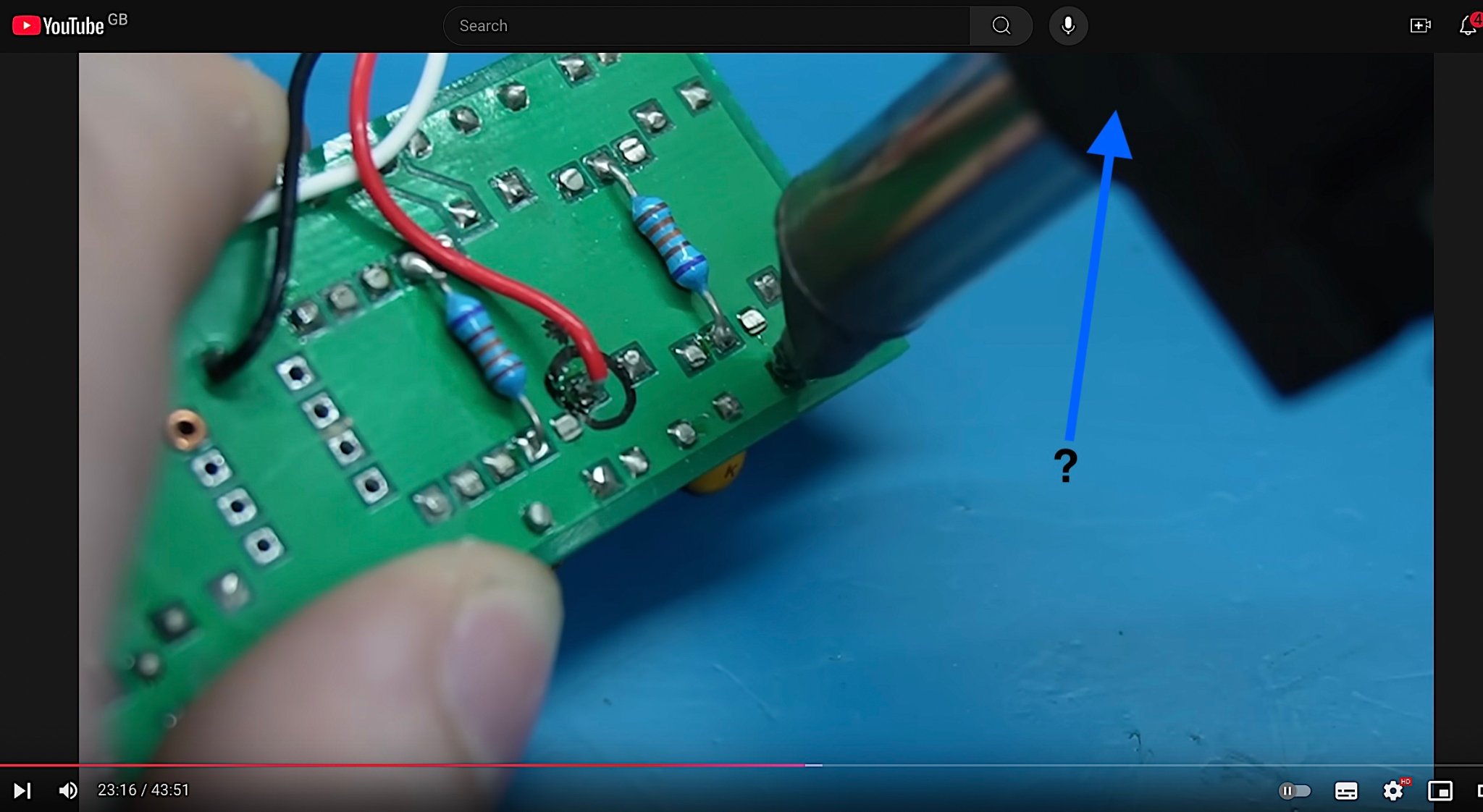

Apologies if this is a stupid question, but after watching him a bit, I'm mightily impressed with his desoldering tool, does anyone know what make and model it is?I'm watching this guy on YouTube that repairs all kinds of audio stuff
I think the video where he uses it is sped up, but it appears to have a marvellous hoover action - desoldering is one hurdle I always struggle with - and this video gave me new hope! 🙂
Globulator: Have watched all the videos now and there are 3 desoldering tools Mark uses. A manual tool that sucks pretty well, a piston driven pneumatic with huge wires, and a modern automatic similar to the Hakko 301 (forgot the name).

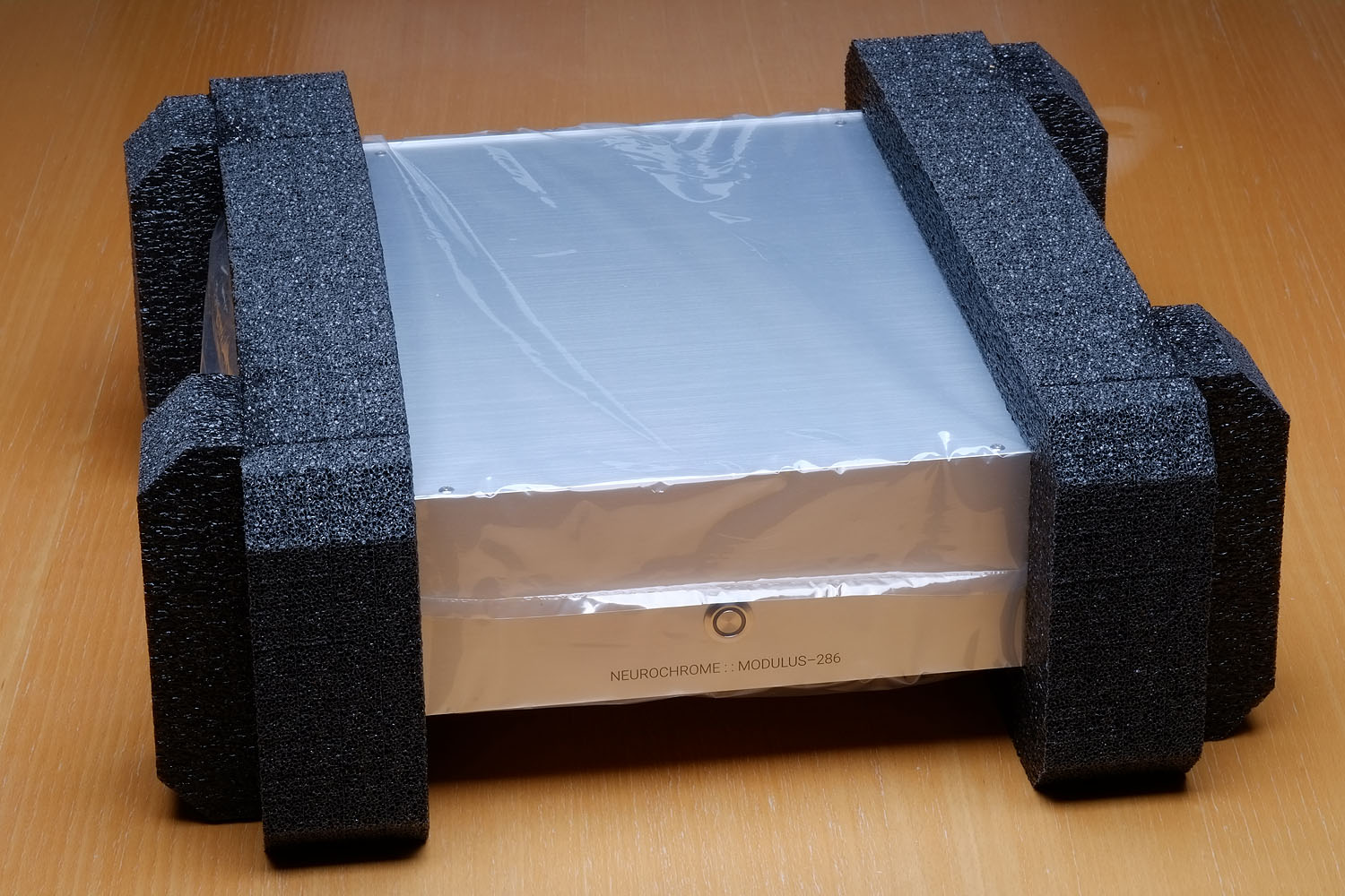

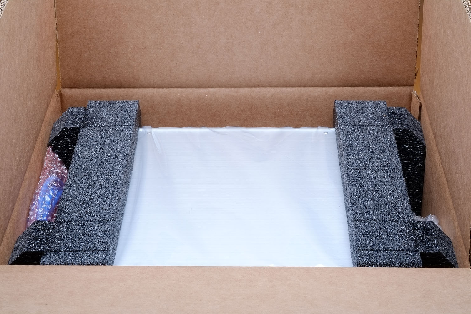

At least it looks like good bubble wrap. As long as there are no sharp edges on the amp, say, heat sink fins, that should work just fine. He could potentially save himself a lot of trouble by having some foam end caps made, though. That's what I do for my fully built amps. I also use a heavy duty box. The cardboard is 1/4" thick. You practically have to drive a forklift into it to puncture it.The internal packing material was merely bubble wrap, though.
I have the foam end caps made locally. They're not exactly cheap, but they're not exactly expensive either. I seem to recall paying around $400 for 23 sets last I ordered.
