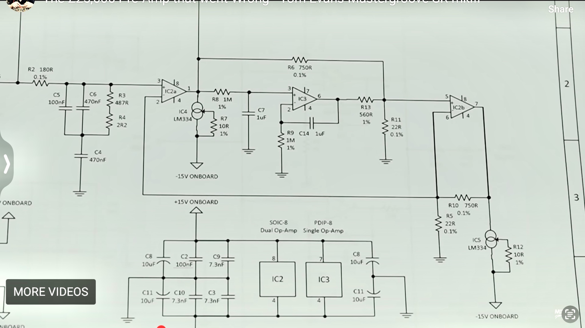

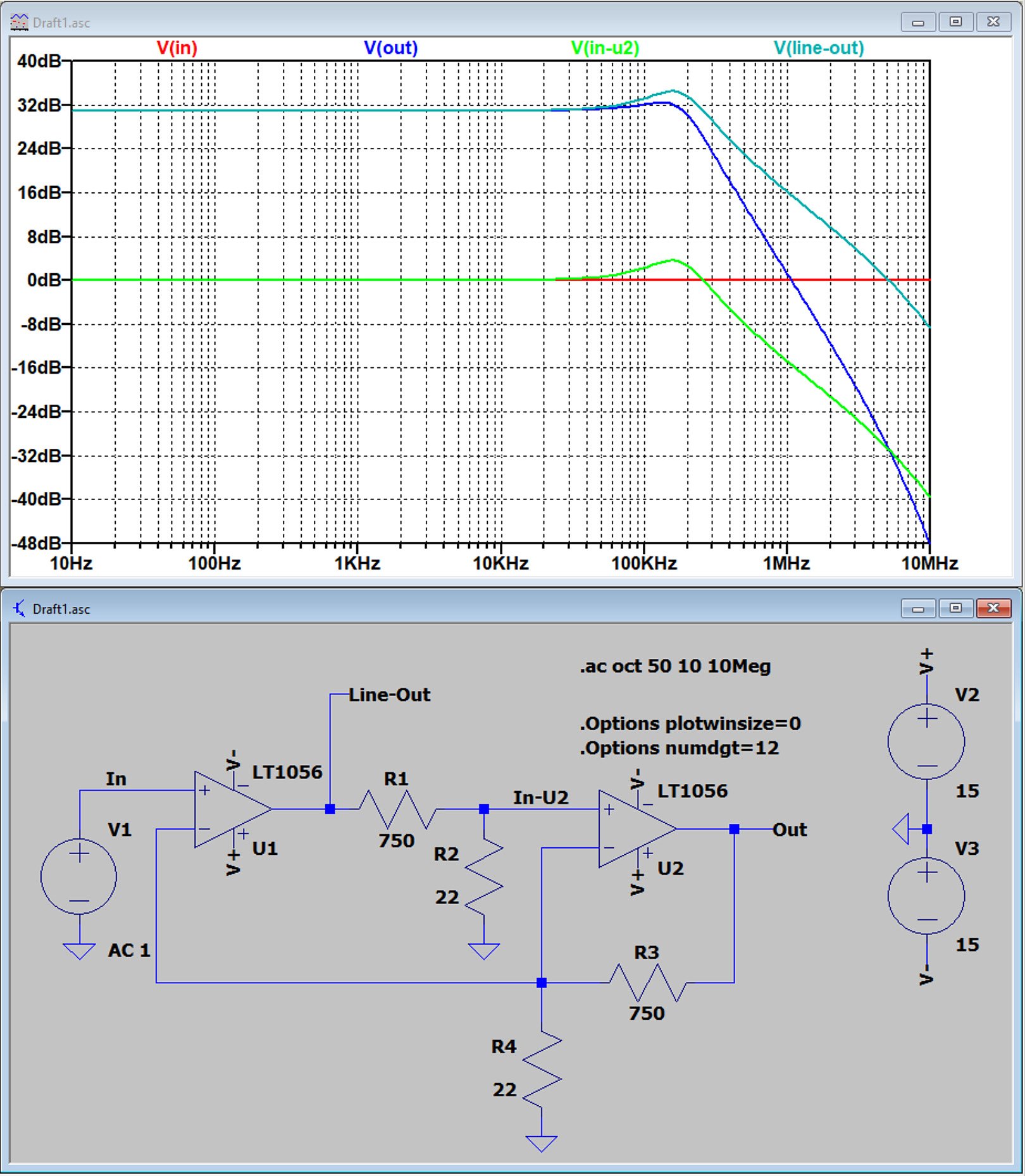

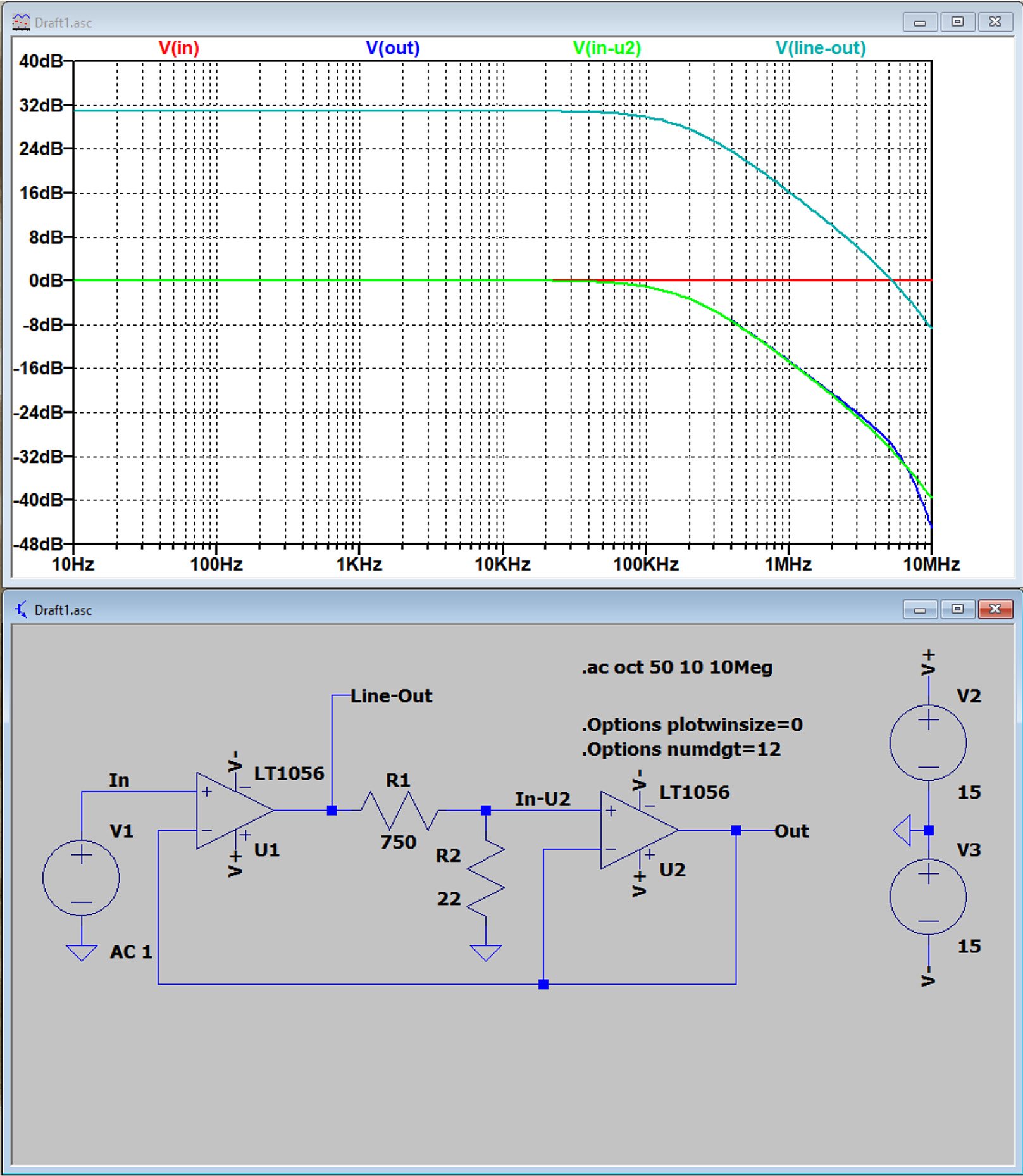

Okay, I think I see how it works. Those four resistors determine the AC gain of the closed-loop. Which is equal to the R6,R11 and R10,R5 divider ratios. So, 750/22R = x34 = +30.6dB closed-loop gain.
Hi Ken,
I think your question is quite valid.
Look at the two attachments, the first being the circuit as is, but for simplicity without servo, the second version is without R10/R5.
Both deliver the same 30.6dB output gain, but the difference is that in the original version, the line output after being divided by 34 by R6/R11, is then amplified again by a factor 34 by IC-2b and finally attenuated again by 34, resulting in the same amplitude as Vin.
When giving IC-2B a gain of 0dB, its amplification and attenuation is removed, but still with a Line Output that has a 34x amplified input signal.
By purpose I didn't use a very fast 5Mhz op-amp to show that the original version's only benefit is that you slightly increase the BW at the cost of some peaking at HF.
In terms of phase turning, version 2 has a group delay of 886nsec at LF and 876nsec at 20kHz, so this fits the most critical bill.
But on the other hand, IC-2b with a gain of 30.6dB will have a much higher THD as with 0dB gain, and while it's signal being fed back to IC-2a this will result in a higher overall THD.
Unfortunately, THD for opamps in LTSpice are not well implemented in their models, so I can't demonstrate the effect.
Hans

Thanks, Hans, for that analysis. No doubt, my following conclusion regarding that particular design feature will get the thread further attacking the unit, but here goes. The purpose for IC2b, is the overlaying a certain distortion character/profile on to the stage. That’s just a logical presumption, of course, but your circuit analysis helps to further solidify that thinking. As you indicate, its presence degrades (contours?) the distortion.
While I don’t automatically have a problem with a philosophy of distortion character contouring, I’m also not looking to get into the usual objective vs. subjective performance fight with anyone. I do, however, suspect that certain dynamic distortion behaviors are the reason why some equipment, typically tube gear, often is said to sound more realistic. Particularly, against components featuring subjectively undetectable distortion. A notion which, while not yet proven, does make some logical sense, but I don’t know. For what they may be worth, I read several product reviews of this model. All of which focused on the subjective realism of reproduction as its most outstanding feature.
For the benefit of others, here is a more easily read image of that line-output amplifier section of the schematic:
I think the idea of this circuit is error cancelling to the degree the opamps match as both amp run the same gain and see the same load and pin potentials.... I might to a sim with real distortion in the input stage of the opamps later tonight to check what is really happening....
Errors created by the first amp can never be cancelled by a second that's behind the first one.
That would only be possible when the second amp received input + output signal from the first amp in a nested feedback.
