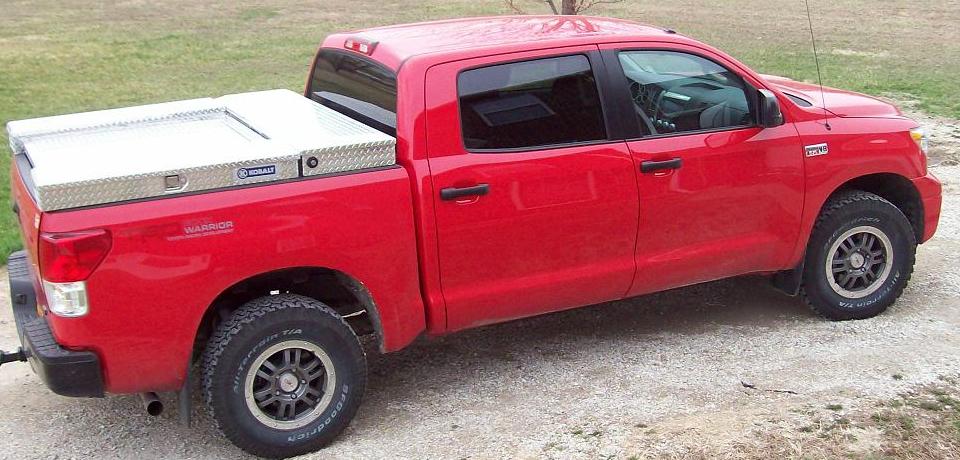

i know! horsepower or db's...hmmmm.... i like both! ^nice truck! but the bed is useless now (i'm guessing you just trailer stuff...?)
wait..is that a horn i see in the back seat? haha
na... the bed is perfect (for me) Lots - o - room for tools, space under the aluminum for speakers and wire. Ability to haul lumber, and tons of room for the family.
Now... about that toyota supercharger that bumps me over 500/500... hmmm....
TRD 5.7 Tundra Supercharger Specs – 504 HP and 550 LB-FT Torque! | Tundra Headquarters

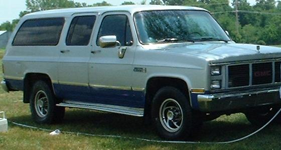

nicee! and yes it is possible, it's called a diesel! 700 ft lbs + 20 mpg highway with a 6000lb truck
Now... not all diesels are 700ft.lbs... case in point. (1985 woo hoo!! with a diesel 700r4 swapped in place of the TH450 so that I could stand the 4.1 gears....)
but it does get 20.
