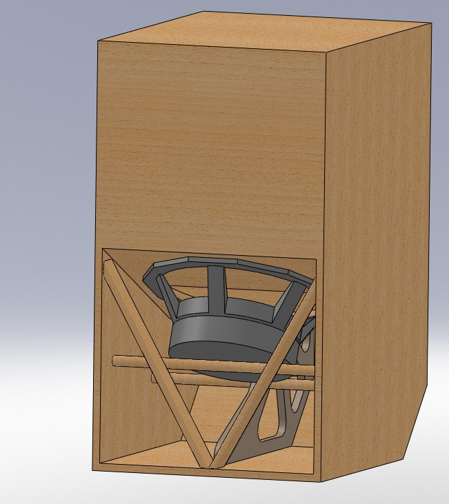

Why didn't we make the brace come all the way out to the front of the mouth? Wouldn't that have helped with the deformation of the front part of the bottom panel?
Extending the brace would help of course but would of probably involved another sheet of material.🙁
The doubling of the bottom panel is an option more than a requirement - The amount and sizes of bracing is always going to be an individual decision.
If a reinforced grille is used then the doubling of the bottom panel is probably not needed, but not everyone will have the resources or funds to source a reinforced steel grille. Without a grille doubling the base will improve things without additional cost.

**** I could have made the brace come all the way to the front i had enough wood to do so (because of the way i cut the pieces from the third sheet), i just figured you designed the brace the way you did on purpose! (I guess it was because of wood limitations)
Ohh well, I will on the second one.
Martin, quick question. What was the original target "knee" (frequency in which it starts to roll off) for this box? I mean before all the bracing, corner reflectors etc? All of these which take up volume inside the cabinet reduce the cabinets ability to play lower, correct? I know your original design only included one corner reflector and didn't have any bracing in place.

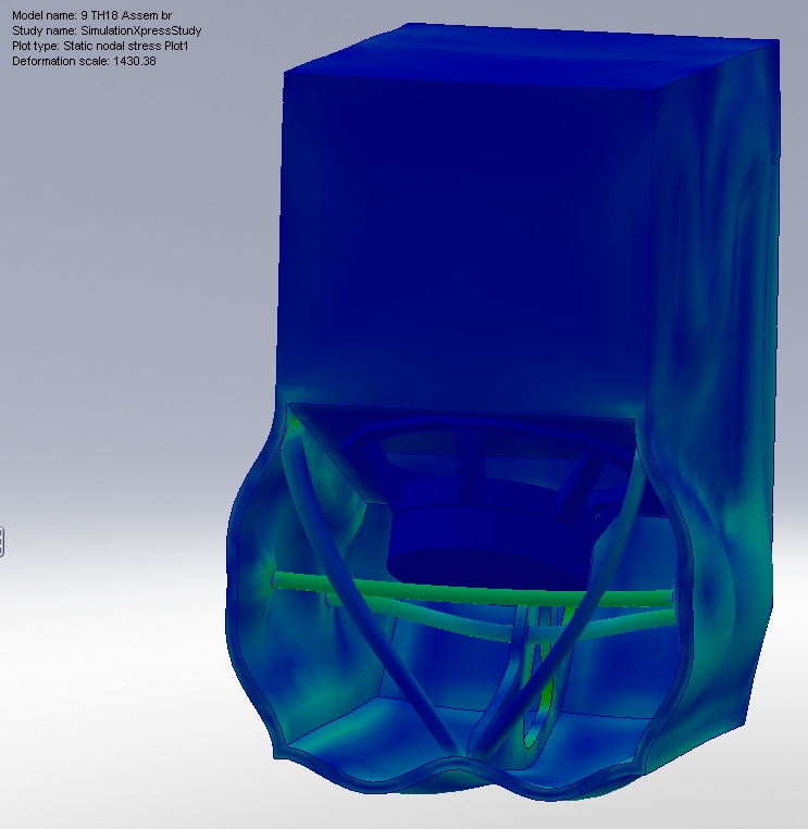

I tried extending the bracing to the front today. Although it makes a difference it is not much. To make it work it would need to be a lot heavier than the current brace.
I have tried out a few options and still the best performer for stiffness would be a V shaped bracing to the front of the horn. I will keep on plugging away at it to come up with a decent solution. Hopefully one that pushes the boundaries a bit with TH design! See pics for the way I am thinking about at the moment. Note the scaling factor compared with previous postings. Maybe I can make this work with the tube & threaded studding construction if I design some sturdy brackets??

was not really designed to any target values. Instead it is the result of setting out a fold and tweaking. This at least avoids the endless hornresp fantasy sims that will never be folded into a usable box.
Don't forget that the cabinet that you have is probably closer to the actual hornresp data than most TH cabs built before. How often have we seen claimed hornresp sims that are a bigger volume than the actual box.:usd:
In past discussions adding reflectors has been a bit of a black art with some claiming they are not necessary. No doubt in this case though they are stiffening the cabinet, which could be handy given the high sound pressure levels that we are going for.
