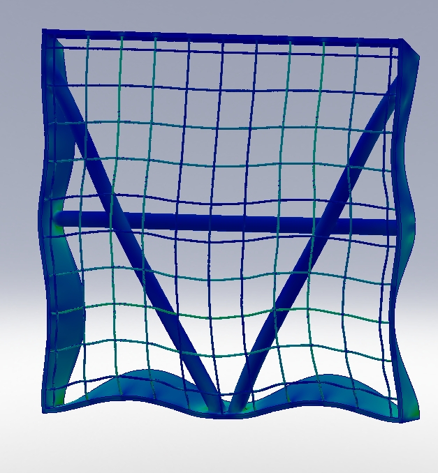

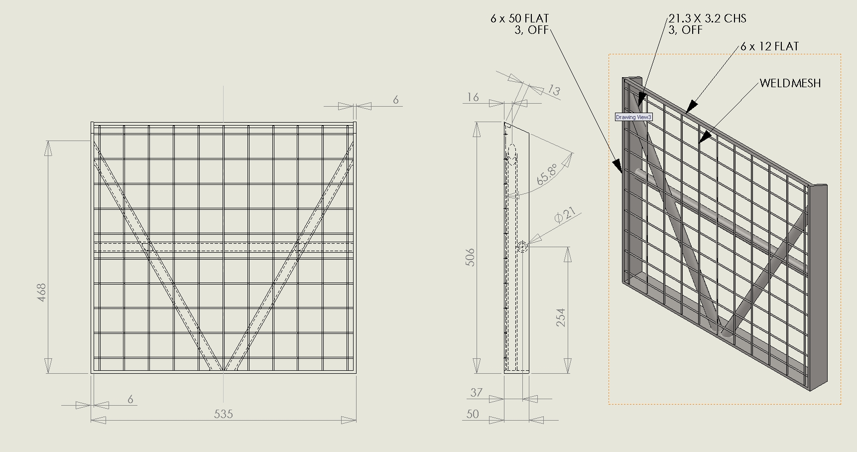

I have put together a proposal for making a grille.
Main points are 6mm (1/4") X 50 (2")flat outer frame - no inner flange to restrict the opening.
Tie bars integrated into the grille frame - I used 22.3 x 3.2 CHS tube.
Weldmesh for least crossectional area. Weight as drawn with 2" x 2" X 1/8" weldmesh is 6.6 Kg.
The Stress calc shows minimum movement where it is needed.
Have a think about it.

The stress charts presented bring to mind prior experience with stress analysis using acrylic models with polarized light.
The bracing I chose for a horn was quite similar to the triangular truss style in the models shown.

Hi Xoc1,
"...no inner flange to restrict the opening."
I doubt that a 1/2" wide by 1/8" thick flange will have a major effect on the SPL, same for the extruded mesh. Maybe somebody can figure out how to model this in AkAbak (?can one add acoustic resistance to the radiator, with a very short reduced cross-sectional area duct?), and see if it makes a difference? Maybe it'll make it better 🙂.

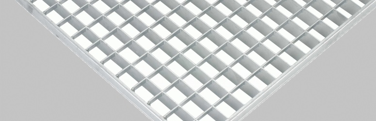

i think factory floor stuff would be as stiff .... as anithing 😛I know, so don't use perforated steel. Look in the industry for weaving-wire. It is used in filter technique a lot. Here in the Netherlands we have Averinox in Haarlem.
Another option is concrete mesh with small openings (10x10cm). On the ends you iron rings for attachments. It's very cheap and very strong.
As a third option, at gardening shops they sell steel plant-holders for wall attachment. It doesn't have the relief on the steel like concrete mesh but it is more expensive.
this is what i mean.
you can get them in varius thicknesis and size's
Epa, we used the same stuff from aluminium once that we took out "ouwe postbank hokjes" it was claimed 'hufterproof' and served as safety screen above the bullit glass windows. But 'sjonges' that stuff is expensive if you want to buy it new (over 100ballen per vierkante meter).i think factory floor stuff would be as stiff .... as anithing 😛
this is what i mean.You can get them in varius thicknesis and size's

OK now to the point. The grill if going over the outside edge of the mouth only obstruct it 1/4" on three sides, Akabak shows only a MAX 0.13dB drop and I can live with that for the added rigidity. Another thought is that vibration looses you some SPL so you may make up that minimal loss and then some in reality

I had concidered mounting the angle framed grill on the external face of the box by rebating the edge but see two practical issues.
1: How to finish the top edge of the grille where you have a rough open edge?
2 : The external edges of the box would be fairly square and sharp - with no way of rounding them off. This won't be a problem untill the first time you trap your fingers between the steel and a door frame.
I know from experience what happens when moving a heavy bass bin and trapping my hand on a square edge. A 90deg edge will cut through the skin with enough inertia behind it😱
Anyway the information on the dB drop with the mesh is very interesting.
What was the percentage open area that you calculated this with?

I just ran a sim with only 50% open area at the mouth and it still only drops 0.51dB @100Hz. As far as the 'Bubble' I believe that is because Akabak only calculates as if it were in a 2Pi environment
