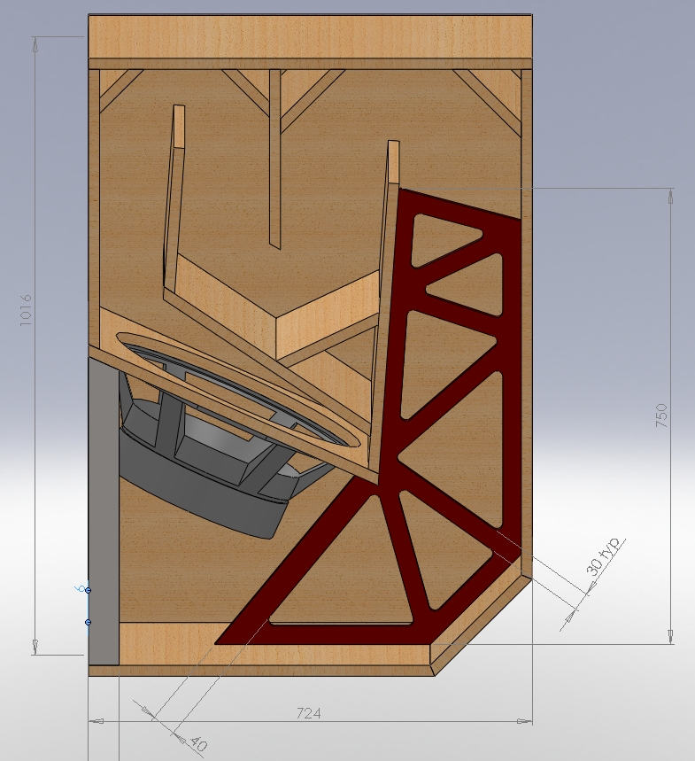

I don’t get a lot of time to keep up with this thread - and this thread is taking up a lot of my time... Never less I still consider this design as work in progress, and I sure that it could be improved on.🙂
At the moment I am considering the bracing of the cabinet.
It would be nice to be able to use the spare material from the cut sheets to brace the cabinet. I am a little unsure how using 18mm wide material would affect the performance of the speaker.
It occurred to me that the bracing should be angled to the horn path within the speaker to reduce the cross sectional area reduction at any given point.
Also I have tried to connect the strongest points of the speaker to the weakest points.
Is this bracing to thin for the material? The ribs as shown are 18 x 30 typically.
I will probably add some more bracing yet – but thought I would post this for some feedback
Regards
Martin

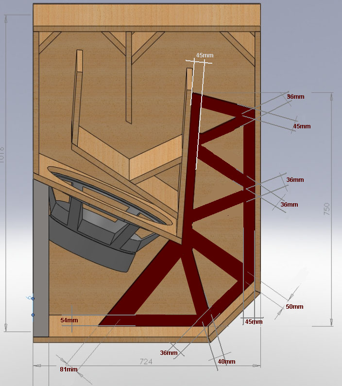

Martin, with bracing you have 3 different issues;
Suppression of resonances in the panels (can be achieved with relative thin braces).
Suppression of deformation of panels under the pressure of large and intensive sound waves (needs much stronger braces such like the bottom brace).
Structural reinforcements to make the cab resistant to (extreme) external forces from accidental drops and transport. For example small square braces behind the wheel attachments are no luxury, I think.
But somehow I believe you can teach us more about structural reinforcements and how panel thickness works in relation to brace thickness and their position to endure forces from all sides 😉. The enlarging of the first brace section to 81mm is roughly based on its angle and the total surface of the bottom panel. Oh, I made a small correction (suggestion) in the back where the braces are 'attached' to their vertical brace.
I know the force from the front brace at the bottom is the extension of it in your suggestion but I'm worried more about the back panel to be honest. Wondering if you can model all these things more precisely, if you ever find the time to do these things…

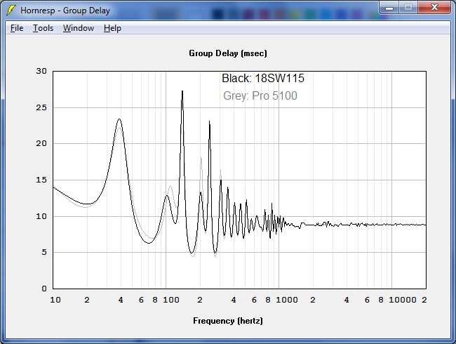

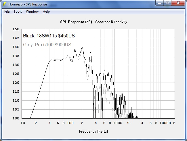

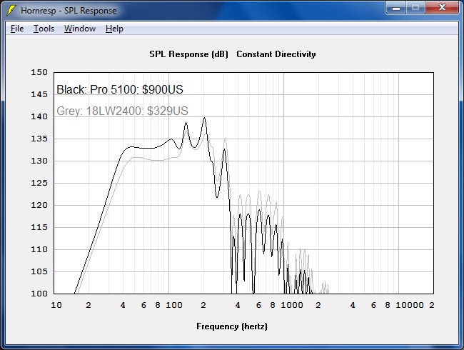

Anyone want to model this TC sounds pro 5100?
TC Sounds Pro 5100 18" Neo Subwoofer Driver
xmax is kind of nutty at 31mm
Left: 18Sound 18LW2400 vs Pro 5100 (SPL)
Center: B&C 18SW115 vs Pro 5100 (SPL)
Right: B&C 18SW115 vs Pro 5100 (Group Delay)
(In Hornresp, the Pro 5100 reaches its AES power rating of 1000W way before xmax)
