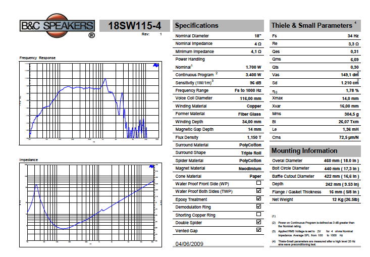

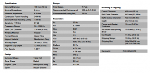

There are quite a few minor differences in the specifications.Both should be working in the Xoc1 fine although there could be a small difference in Group Delay. I haven't seen any PDF about the 4 ohm version but I'm working on it. Maybe Art has the Thiele-Small for the 4Ohm version since he uses them.
The heat dissipation the BC-18SW115-4 is quite impressive, in side by side high power testing of some Eminence drivers the ceramic magnets would be hot to the touch, while the BC seemed to not have raised in temperature hardly at all.
There are very few amps (unless bridged mono) that have enough power to utilize the peak potential of the 8 ohm version.
The 4 ohm version is not really half the impedance of the 8 ohm, I am using Crest CA-9 bridged mono into a single speaker, but it is just tickling the speaker at clip levels (perhaps 3000 watt peaks). I think amps capable of 7000+ watt peaks would not be at all out of line for this speaker.
Here are both the 8 ohm and 4 ohm versions:
Thanks Art for the info. There seems to be no difference in the gap between the 4 and 8 ohm version which means some distributors
need to correct their Thiele-Small parameters.
I made both HornResp to compare the difference between the 8 and 4 Ohm version. Based on 1 watt calculated for each driver.
Eg for the 4Ohm version = 1,8V
Eg for the 8Ohm version = 2,3V
As you can see there is no difference between sensitivity and a very minor difference in response. As suspected the minor differences you only will see back in Group Delay and impedance.

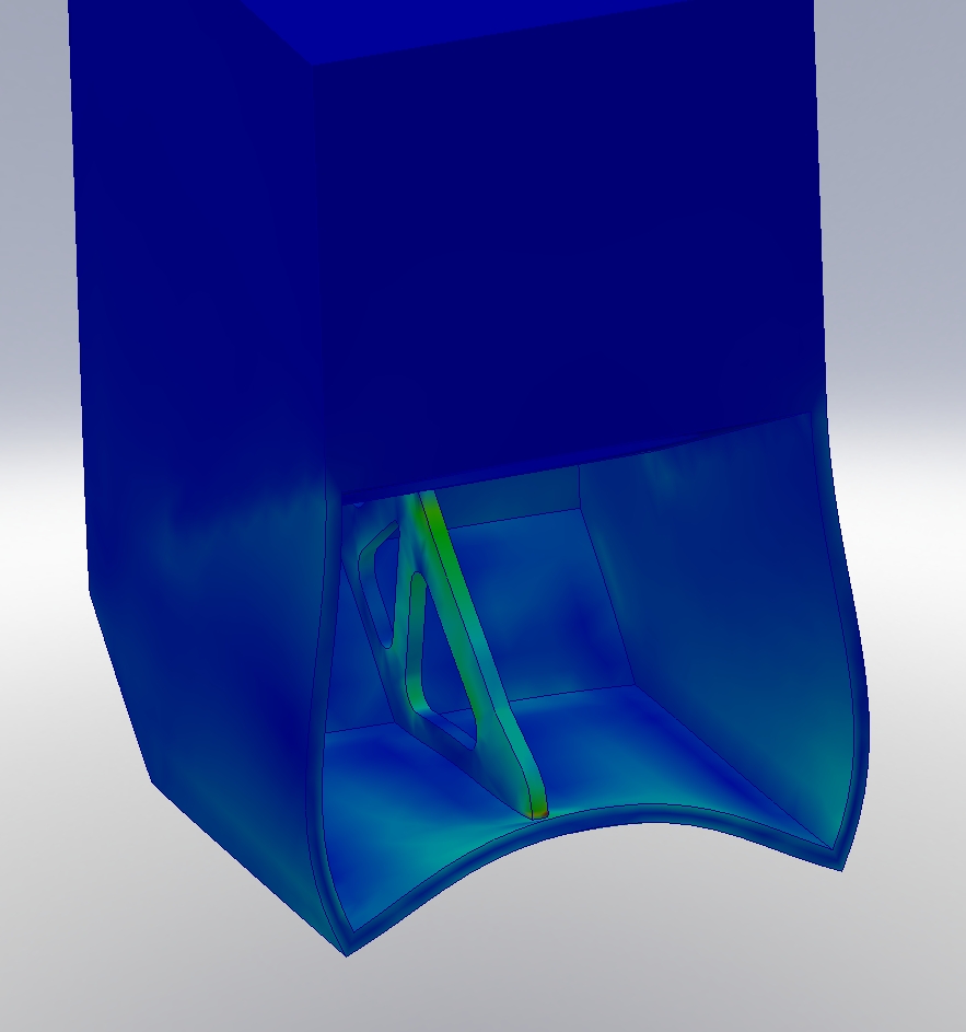

Quick question...are these all strips of 18mm ply? Or is this brace cut from a single piece then the triangles are cut out to reduce the volume the bracing takes up?
Of course the best way is to use one single piece as it gives the highest strength but I think Martin also wants to use left over parts. (Btw the cut outs are not only for reducing volume or weight)Quick question...are these all strips of 18mm ply? Or is this brace cut from a single piece then the triangles are cut out to reduce the volume the bracing takes up?

If you look at the page 3 of the cut sheet drawing. there is plenty of material left over to cut a one piece brace. This is the 1/2 sheet in the cutting plan for a single cabinet, so You would need to nest the 2 braces to get the pair from this sheet.Quick question...are these all strips of 18mm ply? Or is this brace cut from a single piece then the triangles are cut out to reduce the volume the bracing takes up?
I have been using stress analaysis to try to optimise the bracing but of course the more complicated I make it the more difficult it is to cut.🙁
I have applied forces to the base, and the reflector where castors are likely to be fitted and I have eliminated most of the stress concentrations.
The thin braces in the back triangulate to the centre of the unsupported back panel area.
Regards
Martin
Martin, try to model them with the 'broomsticks' that are side-to-side mounted. One cuts trough the big first brace half way between driver panel and bottom panel.
The other one should be sits somewhere under the magnet.
Btw the one piece brace looks great, as usual...
