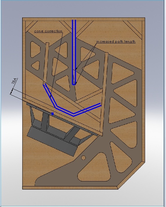

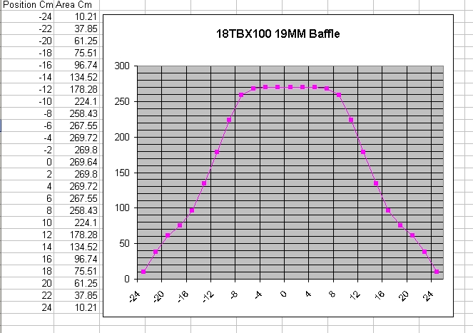

I made a start on measuring the cross sectional areas across various sections through the speaker driver. It immediately becomes apparent that the area is virtually constant over a distance roughly related to the diameter of the dust cap.
This means that the shape of the cone correction should have a flatttened area not just a V point as DJims last suggestion here
http://www.diyaudio.com/forums/subw...30-ft30-pa-th-awesomeness-72.html#post3017801
When we add this to Arts comment in post 528
http://www.diyaudio.com/forums/subwoofers/190635-th-18-flat-35hz-xoc1s-design-53.html#post2936917
it makes more sense.
If we put all these observations together what we end up with with the TH18 / SS15 folding is something like the attached sketch.
Regards Xoc 1
Hi Martin,
True, but in practice we didn't notice much of a difference. We just rounded the point a little by the thickness of the panels, to prevent turbulence.
Another mind buster for you, how you are going to correct the wavelength differences between the left side and right side of the driver? (and the wrong positionned S2 point). Cone correction cannot be used above an S-shaped throat and the V correction makes the difference between the sides even worse... Just a small reminder, other drivers in the Danley TH18 didn't seem to have a long life time 😉
(Edit: we tested V-shape cone corrections only in the symmetric folding lay-outs that don't have a S2 issue...)

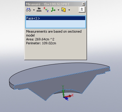

Hi All
Analysis of the cross sectional area of a 18TBX100 on a 19mm baffle with a 48.3cm dia cutout. The first pic shows the section measured at the centre position, Zero in the spreadsheet. The second pic shows the spreadsheet of the areas every 2 cm across the speaker cone.
The graph shows the shape.
Regards
Xoc1

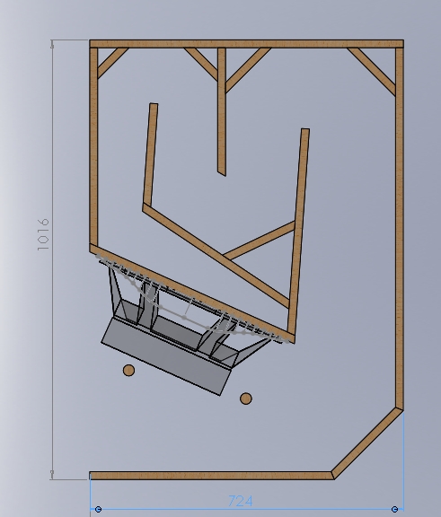

I see what you have now, that makes better sense.😱
Well if there is going to be a flat centered over the driver as proposed here:
If the V cut out for "cone control" seems unappealing and or you feel the need to deviate a bit to separate the DIY from the commercial design - why not make use of the scrap from the driver cutout and make a loading disc centered on the driver? I think it could potentially be the method to produce the most even load on the cone.?
You are suggesting this 🙂 ?
Probably a single flat disc as the cone correction is now incorporated into the horns path and the more layers you add the more path length you have to give up.
Actually now that I think about it your suggestion of a ring would make the most sense as it will displace the least volume and allow for the longer path length. I would make it a optional add in for the test cabinet.
The sketch is closer to "almost exactly" than "something like" the DSL TH-115.
Loose some of those volume robbing corner ramps you are so fond of and it would be even closer 😉.
Art
