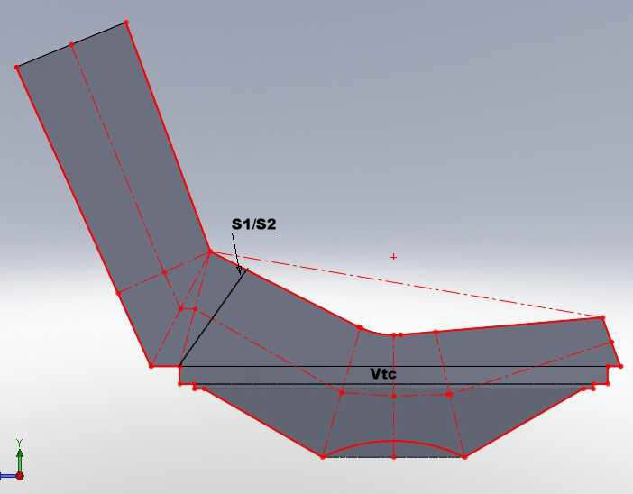

I still think that the throat is the key to getting the last bit of control out of the TH18 design. Squeezing down the throat area is definitely possible. Josh Ricci has shown that higher compression in the throat is practical. Also reducing the throat opens up the possibility of increasing the path length.😉
David McBean recently posted on the Hornresp thread that VTC should include the cone volume, but how many of us are even bothering to do that!
I think that the offset nature of the TH throat is more complicated than the Hornresp model.
Imagine a sim where S2 is reduced to almost zero. The reported compression ratio would be massive, but in reality there would still be a conciderable cross sectional area at the S2 point, due to the baffle cut out and the actual shape of the speaker cone.......

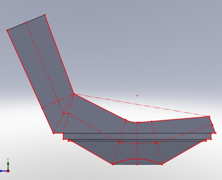

You mentioned that you measured your B&C 18SW115 driver. Any chance of posting the dimensions I requested. I don’t just want to calculate Vtc & Atc.
I want to be able to measure the cross sectional area of the throat, at different points in the horn path, including the volume of the driver and baffle that are usually accounted for by the Vtc and Atc figures.
I will then use the data to try and shape the throat to get a linear expansion throughout.
It’s going to take some number crunching and tweaking to get anything sensible. Then it has to be rationalised to take account of driver excursion, and timber construction, so I would rather start with some decent dimensional data for the driver.
Attached is a screen grab of what I think it might look like.😕
Regards Martin (Xoc1)

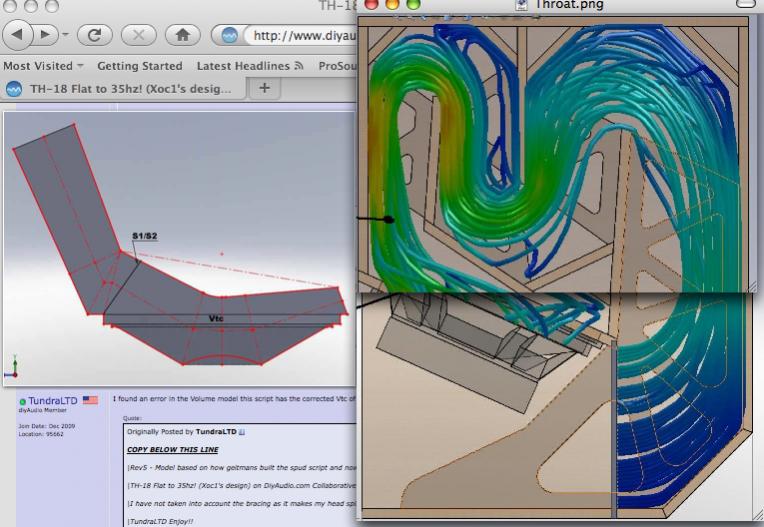

Hi Xoc1,
With your example in Post #523 you might be redesigning the throat and S1/S2 area into an enlarged throat chamber, that would be modelled more correctly as I'm showing in the attachment(?).
It may be more beneficial to stay with a small throat chamber with an adapter plate with an aperture that size-wise reflects S2.

I've playing with Sketchup more today and it is giving me inconstant numbers on the volume calculation so I'm going to have to figure out whats up with that. But here is the basic model of the 18SW115 cone
I found an error in the Volume model this script has the corrected Vtc of 7873cc for a B&C 18SW115

Oliver,With your example in Post #523 you might be redesigning the throat and S1/S2 area into an enlarged throat chamber, that would be modelled more correctly as I'm showing in the attachment(?).
If you simply do what is shown in your picture below, using 45 degree angles on the "V" centering on the cone with about a 3 inch flat spot in the center, your copy of the DSL design will be complete😉.

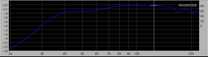

Usually it does but it this case I don't expect the cone volume correction will improve low frequency response. I also don't believe it will improve excursion stability since that is related to another problem. Fill the Xoc1 with a B&C 18SW115 and it will be stable. However, the cone correction could improve the response above 100Hz.
This is how your measurement and that of GS3525 integrate. Of course it stands or falls with the accuracy of the measurements. Nevertheless, it does similar in modelling so I don't expect huge differences. Also, at high power the 18NW100 is no competition to the 18SW115 🙂.

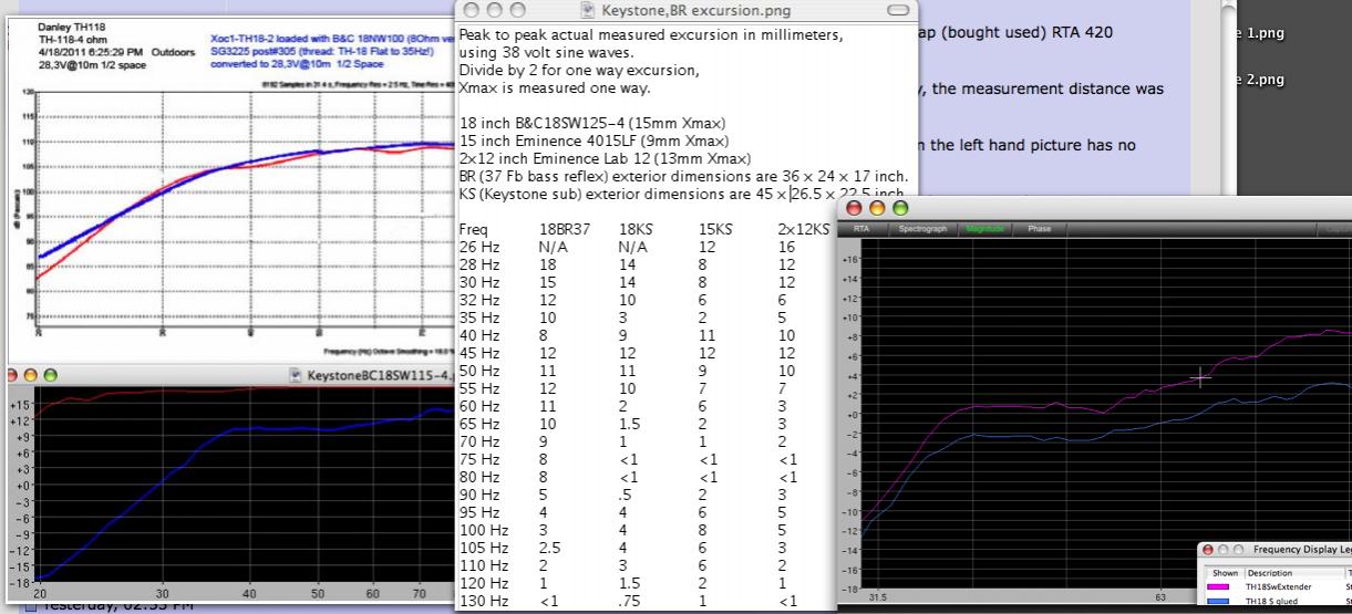

To be internally consistent within the Keystone thread, I chose to use the charts using a cheap (bought used) RTA 420 microphone at 2 meters for all the posts.Hi Art,
Below is the Keystone measured with a much better microphone, a B&K 4004. Unfortunately, the measurement distance was not noted, but since the upper response is different, it probably was not at 2 meters.
The same trace has also been included with smoothing similar to what DSL uses, the trace in the left hand picture has no smoothing.
It is apparent the Keystone SPL drops off more rapidly below 35 Hz than the DSL TH-118 or the Xoc1 TH18.
Whether the Keystone's extra cabinet volume, 25% larger frontal area and different tuning approach result in it having more or less output at 40 Hz could only be determined if all three cabinet test set ups were identical.
At any rate, the difference between the cabinets does not appear to be much, other than shape and cone control.
The Keystone is 5 inches taller, 4" wider, and 6" more shallow than the other cabinets, which works better for my PA needs.

Hi Art,Whether the Keystone's extra cabinet volume, 25% larger frontal area and different tuning approach result in it having more or less output at 40 Hz could only be determined if all three cabinet test set ups were identical.
I don't think a 25% larger reflective front in advantage of the Keystone is large enough to make its Fb drop or show significant increase of the SPL at 10m. The effect of reflective panels/front is limited by its 1/4WL.
I have studied your B&K measurements and I see a 3HZ drop of the Fb in the left plot (see picture below). The right one is close the measurement with the cheaper mic so I guess the left B&K measurement is from very close range or maybe measured with a second Keystone next to it, I don't know.
When I line up the right measurement of the B&K 4004 with the Xoc1-TH18, they are looking quiet close indeed.
It looks like that the Keystone, Xoc1-TH18 and Danley's DSL TH118 are all very close in system volume and response. In other words, the way of folding or changing the shape of the mouth are of relative influence on the subrange response.
Both left and right are the same measurement, the right plot is smoothed, which distorts the LF knee point, making it look softer than it is, which looks like less LF. The left response is correct.Hi Art,
A larger frontal area definitely makes a difference all the way down to Fb, as shown in the tests shown on the right of the graphs below. The extender, with about a 50% increase in frontal area increases level by 3 dB or more. The larger frontal area does not decrease F3, but increases forward directivity, increasing level down to Fb.
One difference in the Keystone compared to the XOC1 and DSL design is it has a slightly lower tuning, about 34 Hz Fb (compared to about 38 Hz). That can be seen in the actual (measured) excursion measurements below.
The Keystone stays "on the pipe" a little lower, but unloads more rapidly below Fb.
