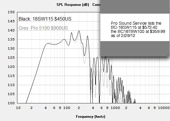

Have you guys posted those numbers anywhere?
tundraLTD in post #3 of this wrote:
http://www.diyaudio.com/forums/subwoofers/207771-new-lower-cost-b-c-18-a.html

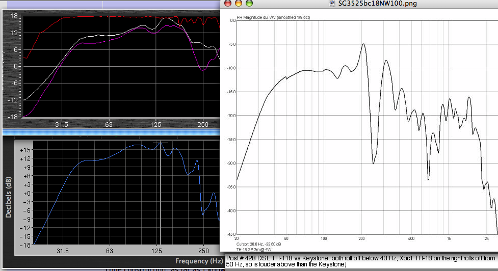

“Just plugged it into my Akabak script of the TH-18 Flat to 35hz! (Xoc1's design)
It sims great hitting Xmax at just over 900w. I may have to order a few! Thanks for the find.”
The Xoc1 TH-18 as built rolls off below 50 Hz, the Keystone (like the Danley TH-118) rolls off below 40 Hz, closer to "Flat to 35Hz!" 😉.
The higher LF knee of the Xoc1 TH-18 allows it to play louder higher, but excursion goes up below Fb, so it can’t take as much power without sounding, a bit distressed.
The sim’s below show very little difference in output at Xmax for the new BC18TBW100 and the BC18SW115.
The BC18TBW100 has an Xmech (where mechanical damage will occur) of 28.5mm, Hornresp says it would take 138 volts (5874 watts in the Keystone sim) to reach that, and it would hit over 135 dB.
In real life with music, thermal compression and the stiff compliance would probably not allow hitting Xmech and long term power of around 6000 watts would probably smoke the driver, but the BC18SW115-4 has no problem with 120 volt peaks, I expect the BC18TBW100-4 would not either.
Art
