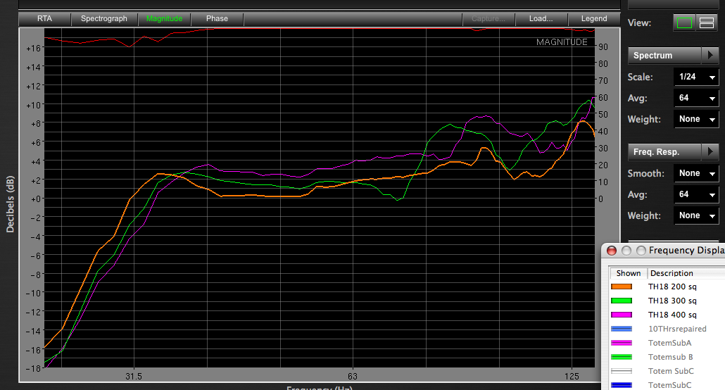

Hi Djim!
Where have I stated continue sine wave?
I'm not crazy yet. Maybe a little bit, but...
By me sine waves are only used to make sweep tests to see what the response (around 1W), to take T/S parameters, and to brake in a driver, but this at 1/4 Pe limit = AES amount (that numbers made or made up, with low cut of 40Hz-more than 3dBs bellow using pink noise... to rise SPL = sensibility numbers for the incautious who cannot interpret it, be impressed).
Cleared that, I would say that time that the 18LW2400 barely can take 1200W, with pink noise or music, also obvious with the low cuts stated (38Hz till 96Hz LR 24); increase power and the cone travels insanely; don't try low cut at 30Hz with that kind of power from real amps capable to sustain and surpass 2300WRMS continuous, 8 ohms p/c, not that today's ms ****;
After 18LW2400 we tried 18TBX100, which allowed more power, with better control, but final SPL would be around same program (pink noise and music).
Than put the 18NLW9600 in and cone control was OK with same band, with around a dB peak more than the 18TBX100. If you had the money for 18 Sound 18NLW9600 and or a B&C 18SW115, 4 ohms would be my choice. If not, play 3 dBs less at power amp and you will have near same.
Keystone, I tried only with the 18NLW9600, which with mouth restriction allowed 2300WRMS easily, peaking above 128dBs, with good cone control.
Also tried other low cuts from 25Hz above till 200Hz, cone control remains and sound was always Hi-fi, nearly flat.
Sorry for no good picture but was the only one taken when band was 25 till 200Hz
http://img1.uploadhouse.com/fileuploads/15697/15697991444701e63930c6dffaac2cf781d5df5b.jpg
So think it can be used for DJ and live music.
Would not use a sub past 100Hz.
Made THs for 6”, 12”, 15” and 18” drivers, and always cone control was the problem in box; that's why a restriction at throat or at mouth will give results; think only a few drivers from the candidates will actually do well innit, playing all the bass guitar notes at same level and defined as they are played live; why? because I will hear music thru the loudspeaker.
So a friend, bass guitar player, will help me to make good choices.

Thanks for all the replies Lots to take in and concider!
We all know that Hornresp has limitations when it comes to tapped horn design.
It is relatively easy to take the Hornresp model and export it into Akabak to add extra sections.
Perhaps a more simplistic approach would be to ignore the Vtc and Atc settings but compensate for the physical volumes of the speaker cone and baffle board by the shape of the throat section.
As I have said before the compression ratio reported at S2 by Hornresp seems wrong to me. At this point in a offset TH horn if we imagine the piston of the speaker moving in and out, 50% of the air that is displaced /compressed in the throat does not even get to the S2 point in the horn.
Also to use a ramp that tapers from S1 to S2, as in the Othorn for instance, seems wrong to me. It might give better efficiency higher in the passband in a hornresp model, but why does the taper not continue right across the face of the speaker - as it does in some classic FLH designs. Is it because it performs better, or is it because it is easier to sim?????
This might take some time to resolve. Not much spare time at the moment.😱
A good start might be to get some data together on the actual physical shapes of some of our favourite speaker cones,
Regards Martin (Xoc1)
Driver Dimension Request
I have sketched out the throat area of the TH18 and the PDF shows the cross sectional area at S2 - Hornresp calculated S2 area being 460 cm sq and actual area being approximately 729 cm sq!
I say approximately as I do not have any 18" drivers at hand to measure.😱

Just for the heck of it it measured the 18SW115. Taking into consideration the the volume of air in the 18mm (circular) baffle cutout and the Air Volume (Vtc) in front of the driver is approximately 4920cc. I know the discussion lately has brought up that none of us have really taken Vtc into consideration
Played with my Akabak script a little more tonight. If anyone want to play with it I added some drivers. Just remove the block on the T/S line for the driver you want to run. Added the VTC from measuring one of my B&C 18SW115 drivers. I'm still learning things in Akabak so don't be to hard on me if you find mistake let me know
