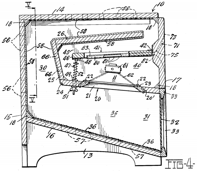

R.G.Pruden
@ PASC
Re US 3,047,090
WoW what a great catch, thanks for posting :)
Actually is was patented by R.G.Pruden in 1962, but applied for in May 1957. Just over 55 years ago ! As we can see from the image, it wouldn't look out of place if posted as a design in here, for eg.
Yet another almost forgotten tech, from way back when, along with so many others that seem to have been overlooked etc ? Even if there "might" have been not much call for lots of bass, low or otherwise in the Fifties or Sixties, by some in certain quarters, there is NO doubt that plenty of records, emerging and continuing on from back then and afterwards, contained decent bass, and would have benefitted imenseley from such a design.
The rock n roll era had been in full swing for a number of years already, and the sixties explosion had already started to happen. PA/Band systems at the time were in there infancy, and with more and more groups/acts touring etc requiring more db's to fill larger and larger venues to cater to more people, several of these designs would have made a Big difference.
Quite why he wasn't able to capitalise on his invention, is a mystery ? and a great pity ! Even if sound companies in the sixties hadn't taken it up, his patent would still have been in force up until 1982. So in the seventies and onwards when sound got a lot more serious, i'm amazed nobody "appears" to have snapped it up !
Maybe he got rejected for years and gave up trying ? Another one that got away, at the time anyway. Thank goodness Tom Danley independently discovered this gem, all these years later. Because otherwise it might have been a long time before we were able to enjoy this brilliant invention.
R.G.Pruden, if you're still alive, you've made a Lot of people very happy, so THANKS for your genius :)

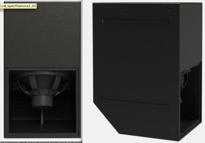

After I PM'd the main contributors here I also PM'd Tom and Ivan to congratulate them on the snazzy new website and "eye candy". I had a sneaking suspicion that they would not be happy with what was exposed on the site. I think we ought to continue to show some respect and not post the removed images out in the open.
