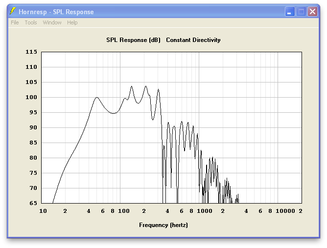

I measured the TS parameters a while back and they were NOT nearly what was claimed, I don't think this is going to work out well.
As measured the BL²/Re was 69.13, that's less than 1/3 the motor force of the B&C 18SW115.
Leaving you with something like this
So don't use the peavey use a B&C ?

Yea the B&C is a good option, the force is strong in that one
I would wait a minute on the cutting if possible there are a few ideas floating in this thread that have not been incorporated into the final drawings and cut sheets... The Chef is still cooking methinks.

For the limited power and non industrial SPL requirement you can get by with a lesser driver than the 18SW115, however the LR18 is still not a good candidate. CNC and dado's are your friend on this one - lucky guy u. It'll be an amazing good music sub but 30Hz is not in the cards. Lower cost driver - B&C 15PS100-8 is looking good, and if you really are not needing more than 120dB the super budget dark horse is the Dayton PA380-8.

I dunno - it's Martin's deal, but I think it won't be long now that he's had some feedback from builders. I think it would already be done weeks ago if it were not for the "political" BS.When do you think a finalization of plans might be?
IMO you would be so much better off with the pair of 18SW115's then if you were to spend $500 a pop on comercial pro subs. Like light-years ahead.I found some used mackie's with 18 in them ,but he's on the fence about price ,He wants $ 750.00 each and their 2 years old and in Austin so It might be awhile before I go ,If I build I know what's there and how long they will last ,
