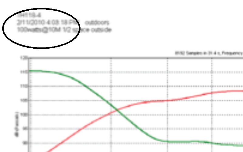

Looks like the difference is in the TEF measurement setup, I see a super LOOOONG time window and one octave smoothing. IMO a properly windowed reflection free 10m outdoor measurement won't need smoothing, this leads me to believe they are cheating as is generally done in audio marketing. Probably the same reason the cabinet drawings were exposed - so marketing could showoff at a trade show. 🙄

I applaud the use of 28.3v as a reference as it removes alot of ambiguity..... however even in the latest published spec that Tom just referenced. http://www.danleysoundlabs.com/danley/wp-content/uploads/2012/04/TH118-spec-sheet.pdf
The Text says 28.3V at 10M -- TEF graph says 100watts at 10M...
It's that pesky confusing watts and volts in the same spec page that kinda throws folks.

The reason why I myself mentioned the ambiguous wattage spec, is because you measure a "nominal 4Ω" load, or in other words a minimal impedance of 3Ω (as I can't find an impedance sweep, I'm guessing around 2.5Ω DC Re) using a 28.3V signal, which corresponds to a lot more than 100W throughout most of the bandwidth of the speaker.
This is not a problem as such, seeing as you state both impedance and voltage clearly, so one can adapt to such.
For fair comparison IMO, one should measure an 8Ω design at 40V/100m or 4V/1m, the latter of which would correspond to the hornresp input. But even accounting for this power difference due to impedance, I still can't manage to simulate these 108dB/2.83V/1m in any way. Not with any existing driver I've tried, not with changing the specs to make some kind of ideal imaginary driver.
