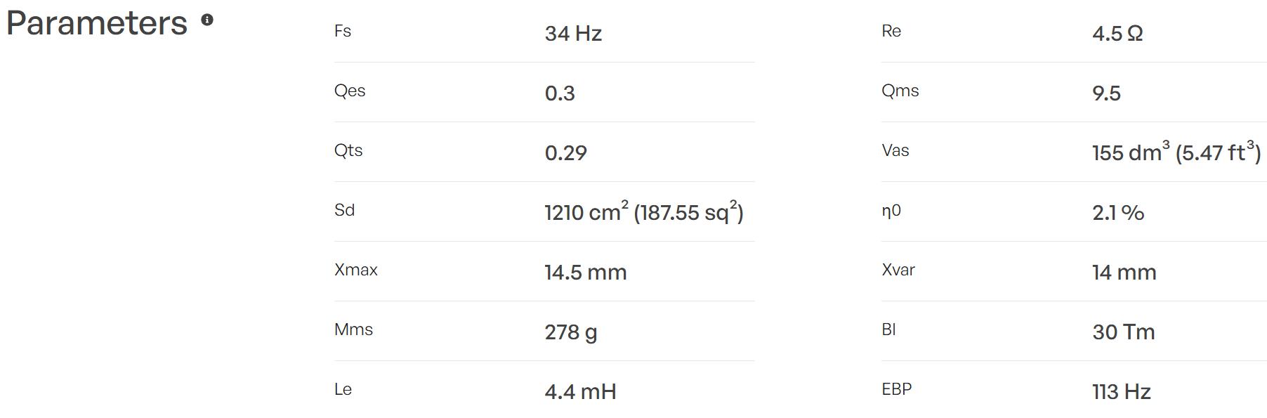

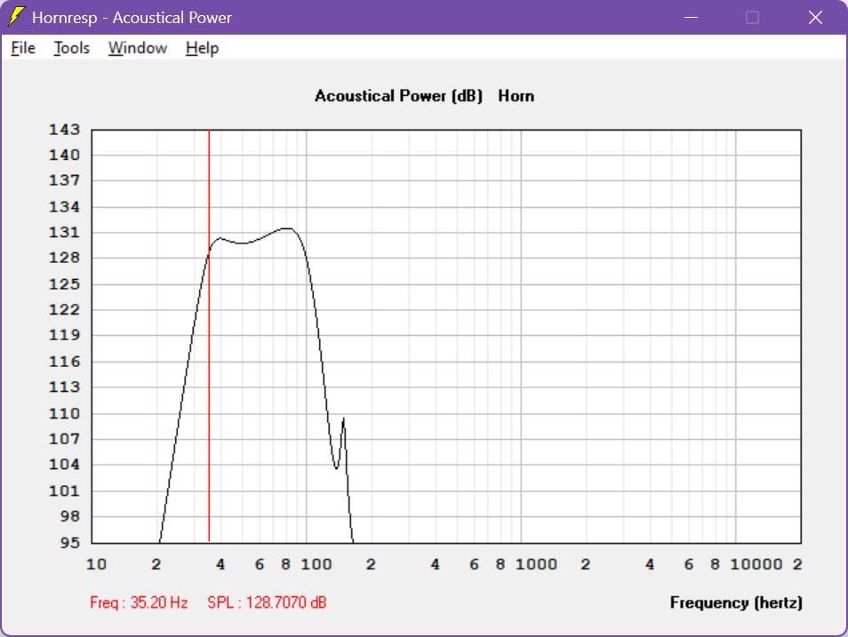

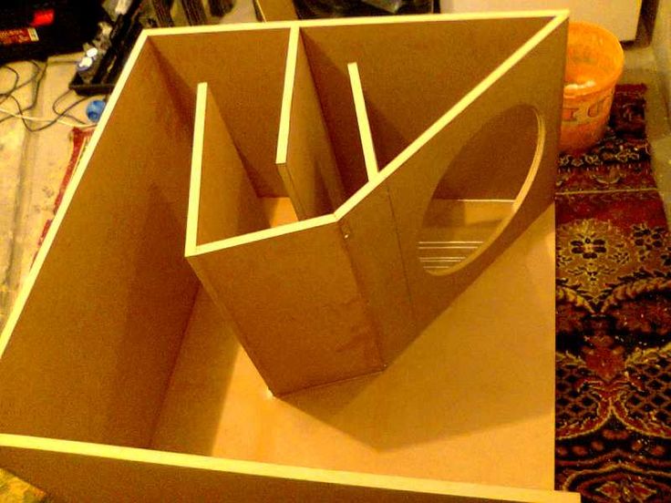

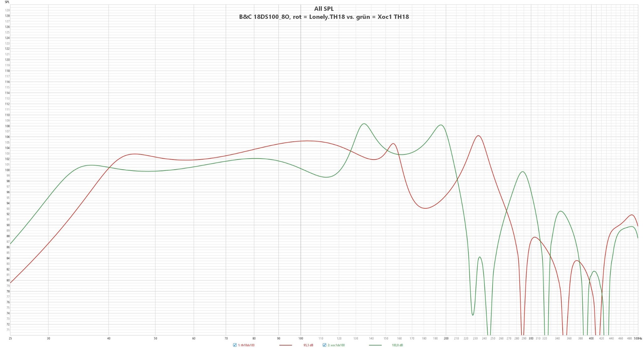

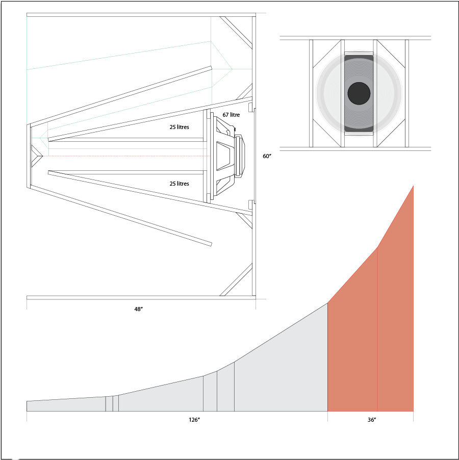

Hello
Im really new to to the pa sektion and want to build some subs for my rcf art945.
I want to build the lonely th18 from Victor https://www.lautsprecherforum.eu/viewtopic.php?t=9487
And to compare the xoc1 sub.
Just to know what sounds bitter to me because yeah im new and dont know wich sound will be the best for me
But i only have 2 of the bc ds 100 8 ohm and a lot of 15mm ply.
Anybody tryed to Use the ds100?
I never used hornresp so i dont know and also no computer is avaible at the moment..
Mabey somebody can tell me about that.
And really sorry about my bad english🙂
I hope the link is ok in the forum here..

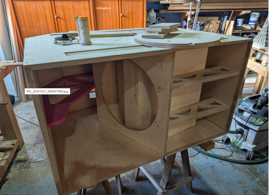

If you are referring to this model found there. Air opposes resistance at a certain speed/pressure, to understand for yourself take a sheet of paper and push half in the open air and the other half to an obstacle and you will notice imbalance and this imbalance is felt in the speaker excursion at high power, this can be felt in the ring next to the magnet and not the outer membrane more or less likely. and about the mouth of the enclosure it is different being flat and not inclined which offers different sound wave propagation.
Here too, I unfortunately didn't understand the intention behind your post. If you have any criticisms or something isn't clear, then feel free to say so. I have no problem with that.
so you want to build 2 different models ? and compare ?
then from the 2 you will pick the one you like most
and duplicate it so you will end with a pair of those cabinets ?

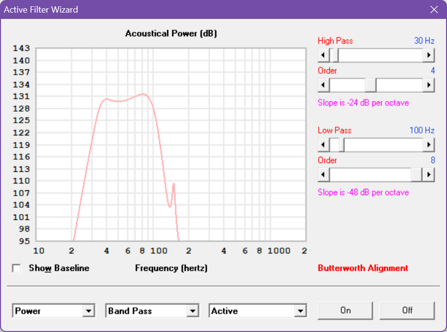

Yes like that. Because im really a newbie i want to collect experience.
And also want to find out what im like.and the best thing I have a good connection for cheap wood🙂 so not a problem with costs. So if the ds100 fit i will try it. At this moment I will say thank you Viktor!

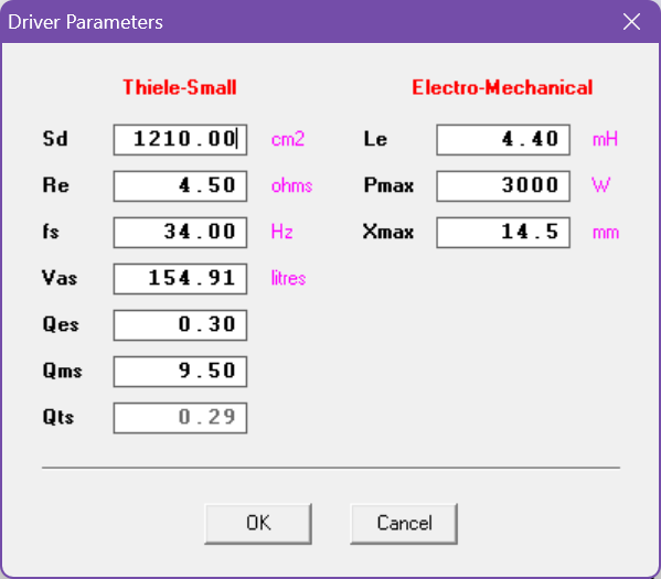

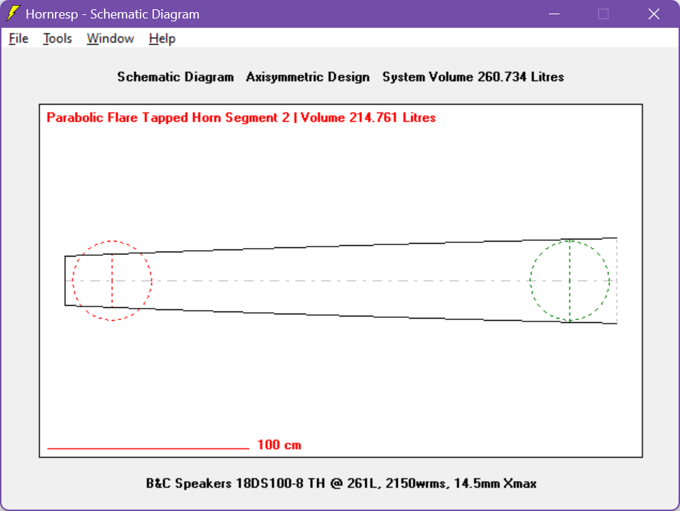

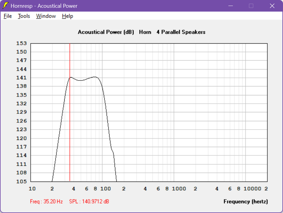

He helped me a lot and also did a simulation for the xoc1 for me. You are the best!

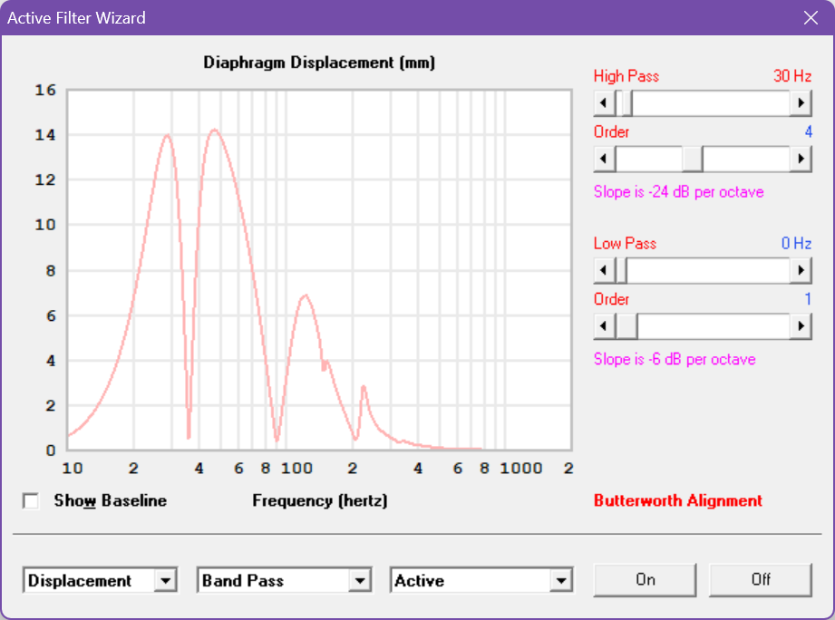

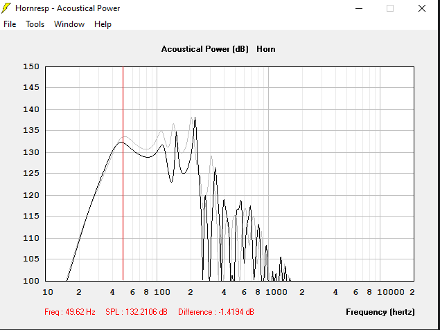

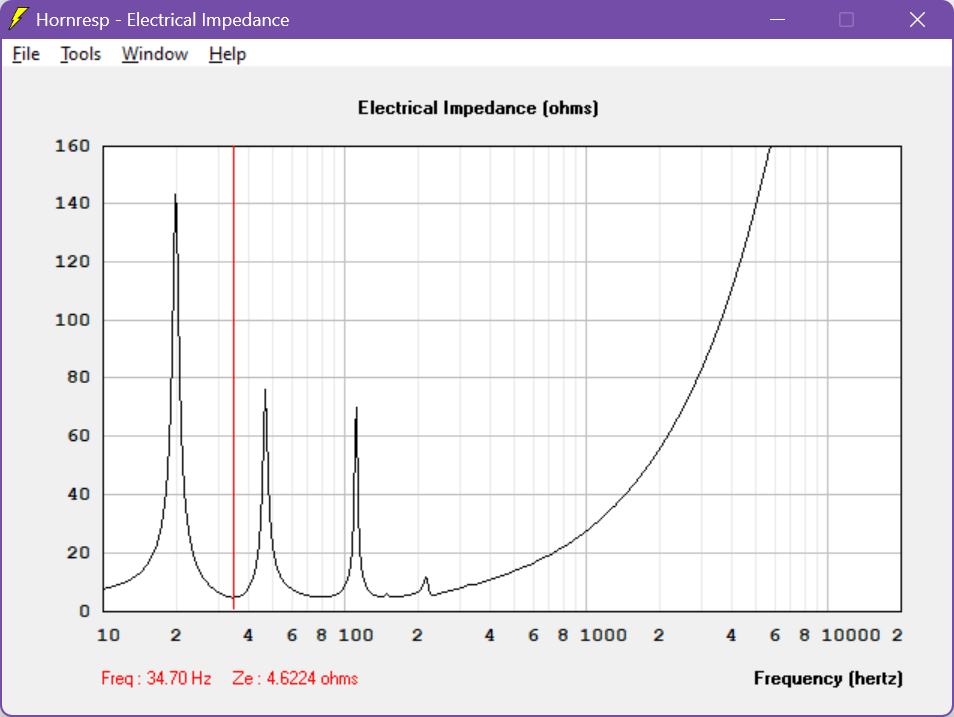

well, the shape mouth of horn can spread the wave sound in different angle. if you can build hog scoop, lonely.th18 pro and xoc come back here with review, will be very interesting. use the same driver for measuring.

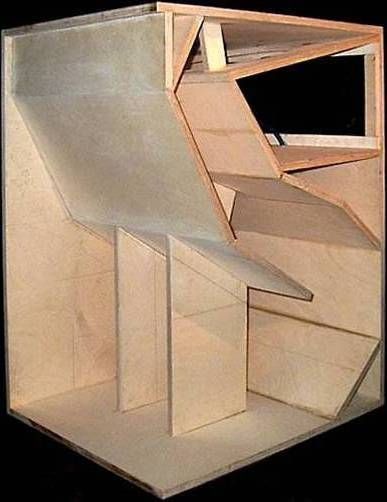

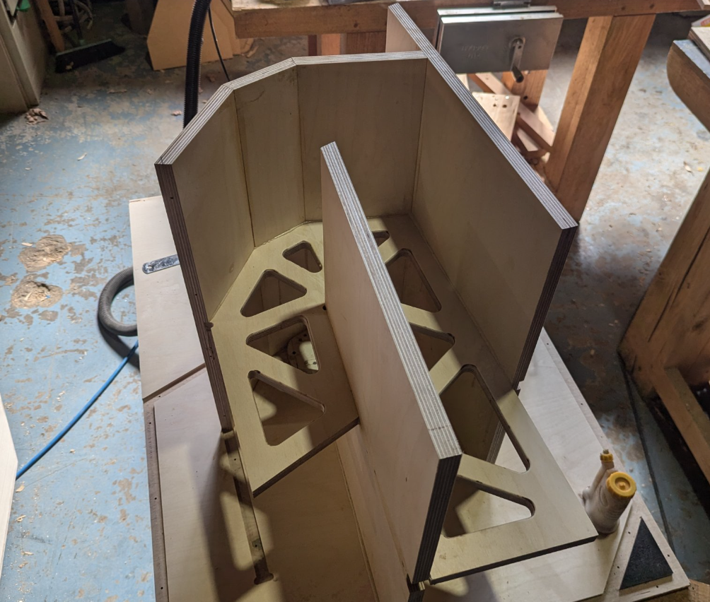

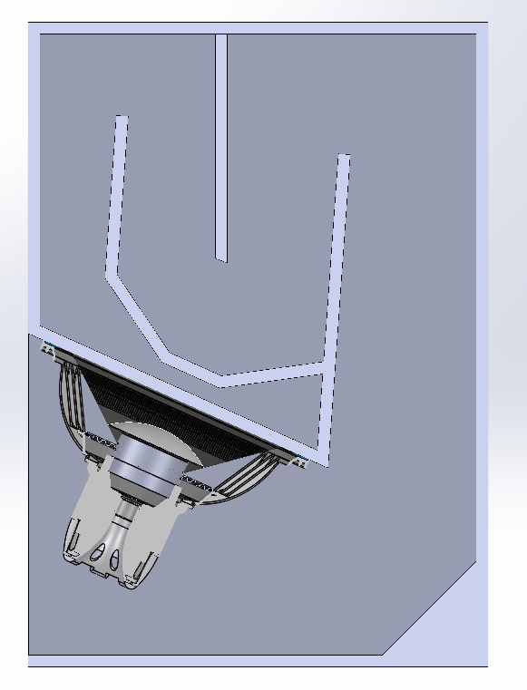

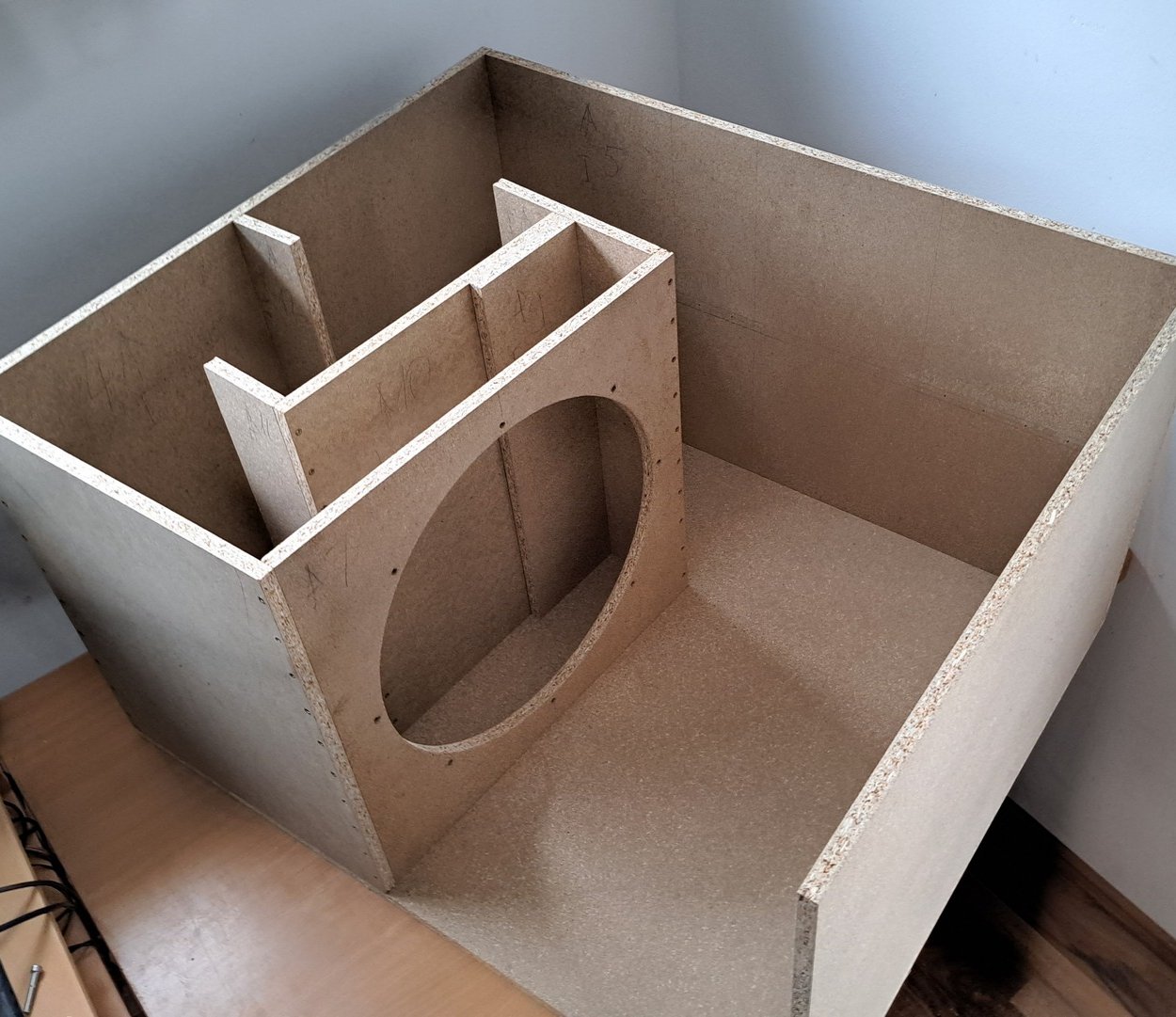

Does anybody have 3D model of enclosure with cone correction? (latest version preferably?)
on post 3,199
deman made fusion 360 3d models and DXF files
he built em also
LINK TO FILES:
FUSION 360 models and DXF
DEMAN POST :
Finally got around to tidying up the files. There's a 3d model in Fusion 360 and drawing files for cutting in Rhino 3d and DXF. It all fits on 2 sheets of 18mm 2440X1220 ply.
All the files for cutting have layers for CNC operations and bevel cuts as needed. And there are layers for the pole mounts (Penn-Elcom M1562) are flagged as optional so you can delete them if you don't need them.
There is a third sheet saved in the folder called TH18 Sub Extras - this isnt needed but has template jigs to cut the rebates with a hand router for the pole mounts and skids (on the flip side of all the other rebates that will be CNC'd) there's also skids and a few spaces to help when assembling the bracing.
I'm not sure the way i did rebates on the bracing was optimal and it needs to be assembles in a specific order so make sure you dry fit everything and work it out. I'm getting a second one cut so will try and make a better build log.
Thank you @maxolini

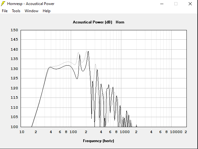

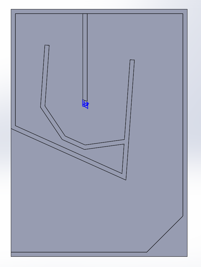

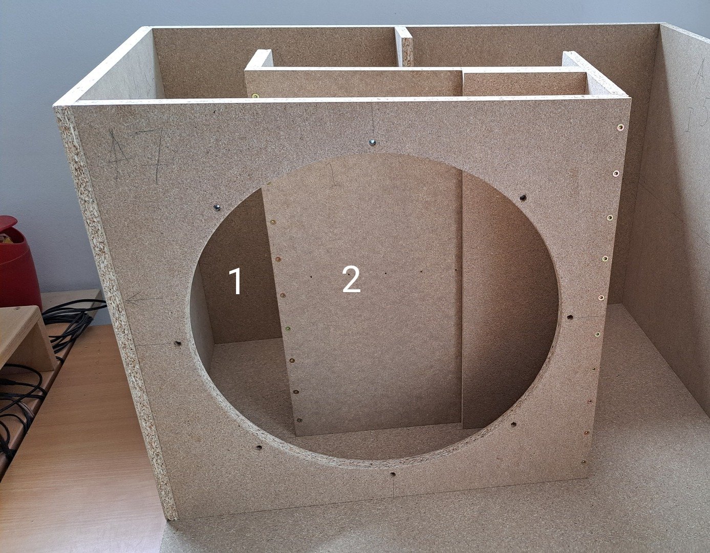

I am wondering about this part, made my version and made it about 15mm shorter as it looks too large in posted version?
BTW did anyone actually compare results with and without cone correction? I have some tapped horns build with original plan for Xoc1 TH18 (no cone correction) and I am curious if there are any noticeable differences.
I guess that topic have been touched many times in different threads , can't recall where are the measurements with and without cone correction but according to some definitions:

but at the end.... looks like without REW or SMAART and a measuring mic... you cant tell the difference between cone corrected and no cone corrected cabinets, so it is not a a matter of life and death.
soo many cabinets built without cone correction not just the TH18 but many others plans, and people love their cabinets
specially in groups of 4 or more.
cabinet count plus proper amplification and processing makes the difference
unless you have OCD i guess you are pretty fine.
