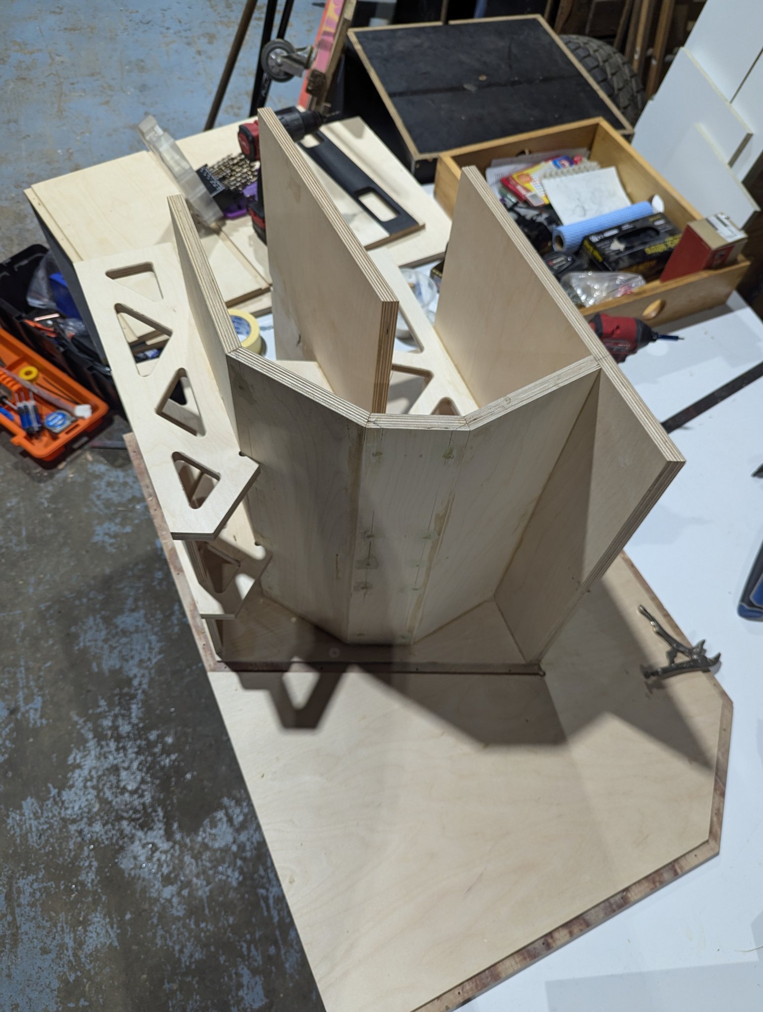

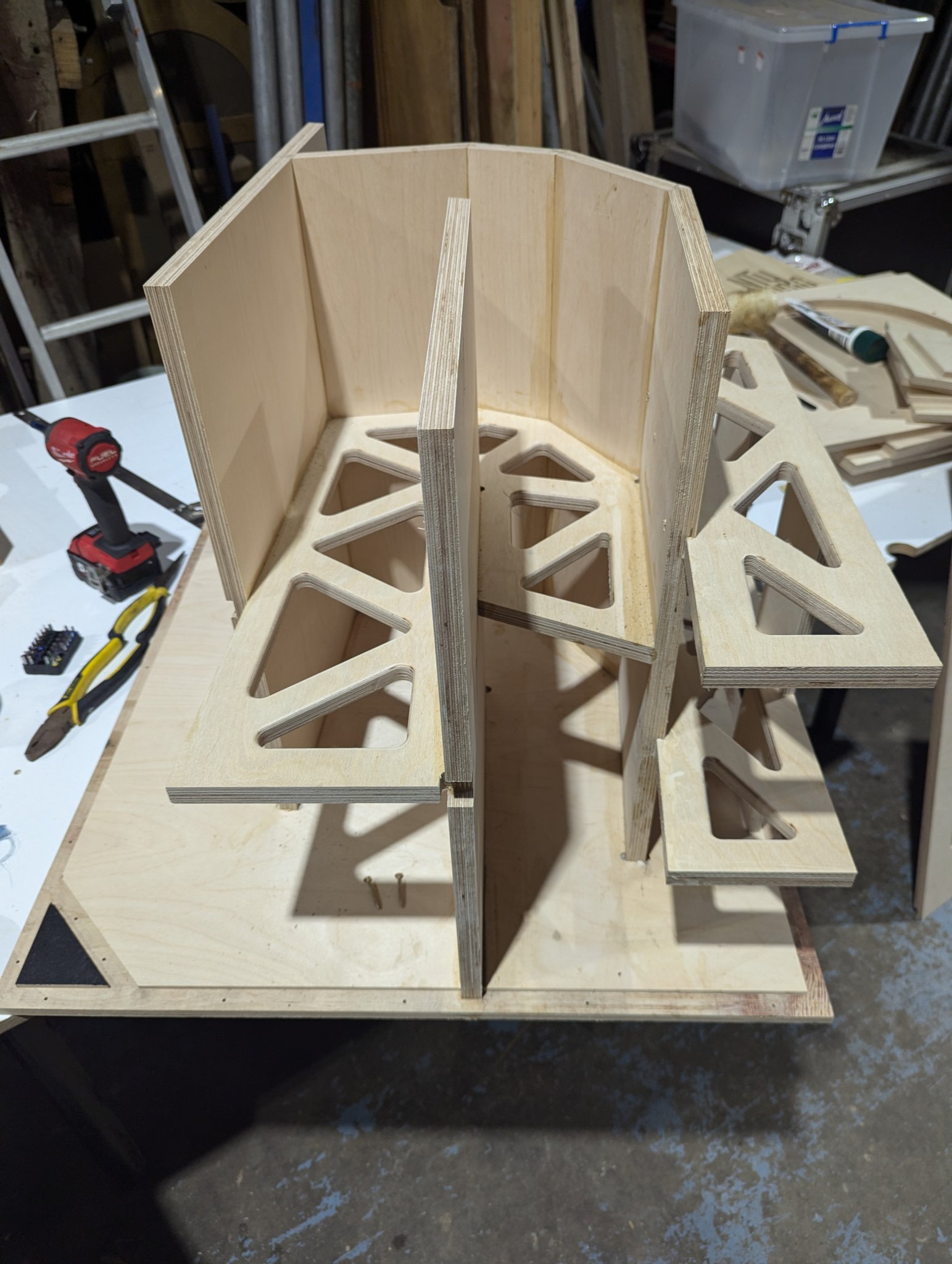

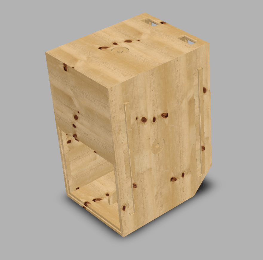

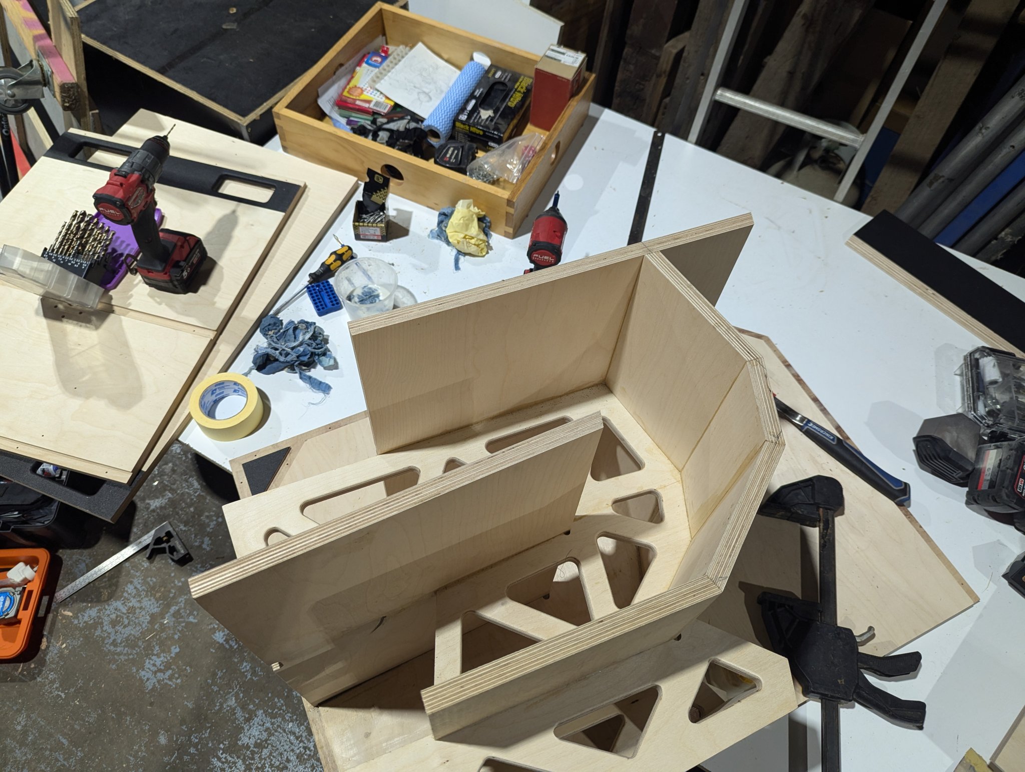

A few more minor updates to add all the rebates, pilot holes for screws (90 degree joins only), handles, pole mounts, skids, grill supports, dish for speakons etc
https://a360.co/3KbZStY
Next step to get the cut sheets into dxf format and get one cut. Hopefully progress may speed up a bit.

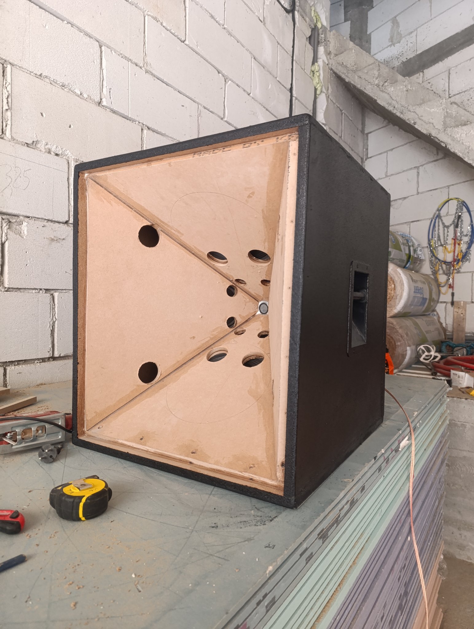

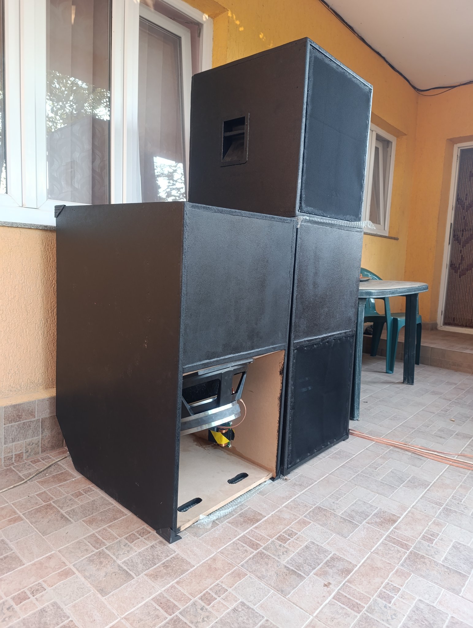

Mono test but will be stereo.
Hi-Fi filter horn used and 35hz subwoofer
https://drive.google.com/drive/folders/10KSkYYXGp2-vUY5Y7wFI06dHrnyk-Jt_
Congrats! Looks great.A few more minor updates to add all the rebates, pilot holes for screws (90 degree joins only), handles, pole mounts, skids, grill supports, dish for speakons etc

what was the wattage used sir ?Mono test but will be stereo.

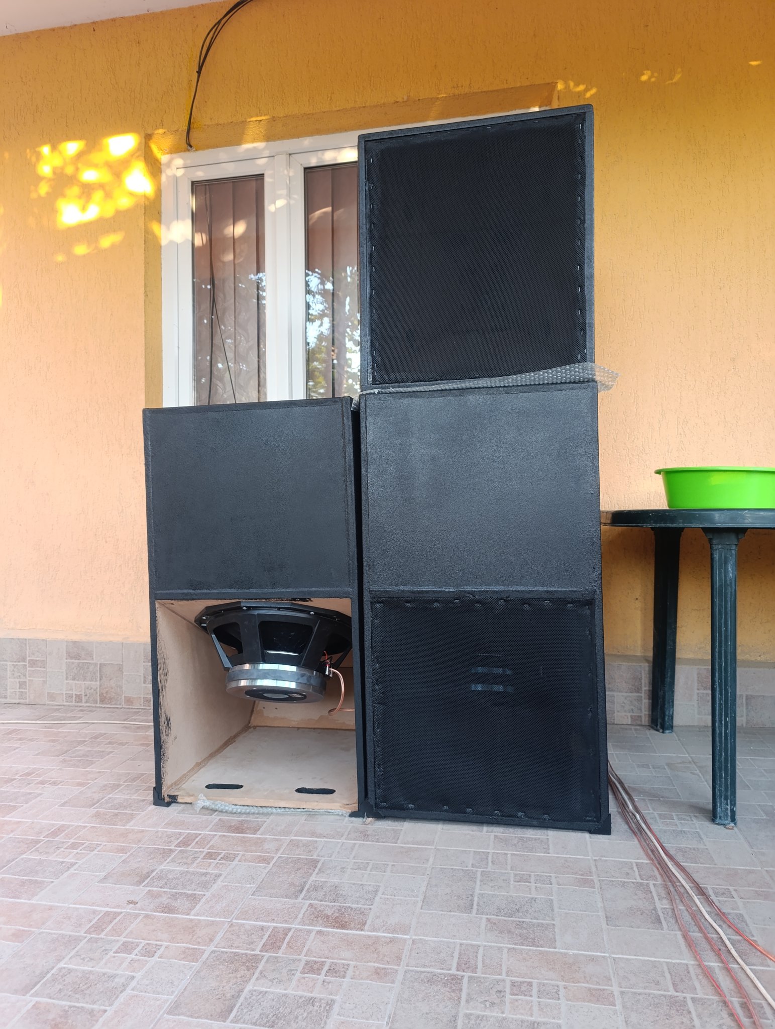

Citronic QP2320 4x450 4ohm for topswhat was the wattage used sir ?
hp-3200 2x1600 4ohm subwoofer
High freq 70-80% no clip
Low freq used 50-60% no clip
Driver 2x BWP18 1500rms 4ohm
Cheap product and unsure longlife for tapped horn pushed.

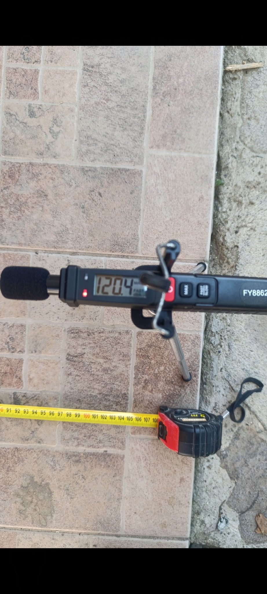

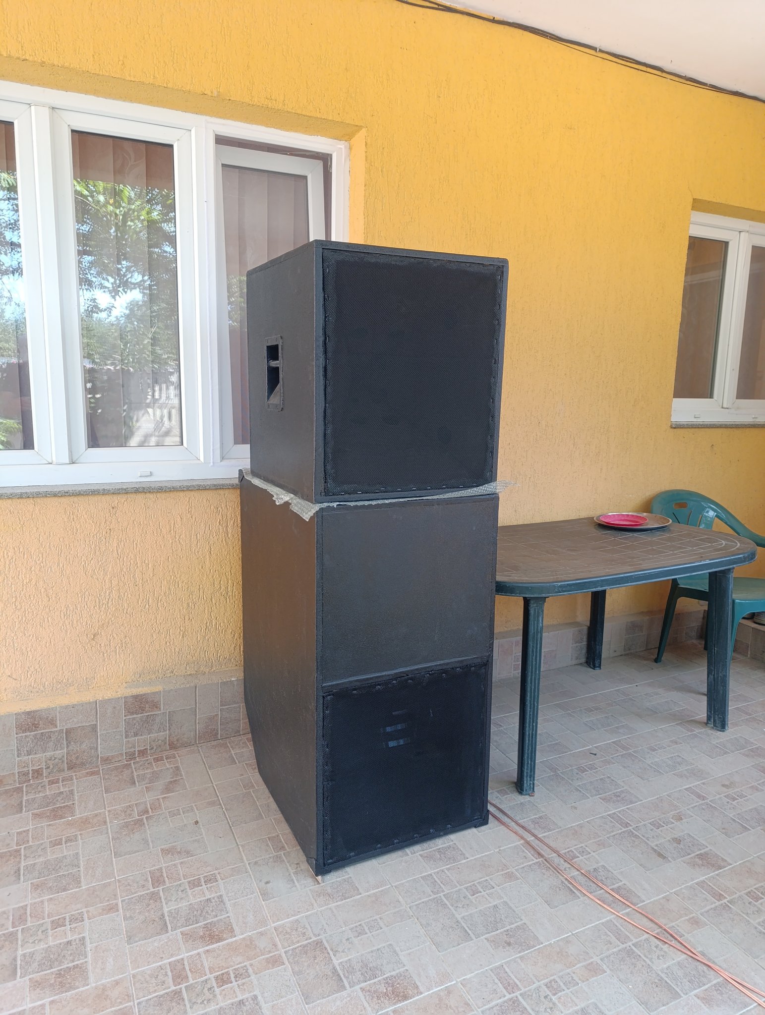

120db peak and 110-115db continuous was impressed by the air pressure at the mouth of the horn being so high. someone told me that he heard the music from 1 km away and someone closed told me he felt the bass how is going far away. just two bins..
Anyway, I got a clear and deep sound beyond my expectations.

thanks for the reply bro. great build manCitronic QP2320 4x450 4ohm for tops
