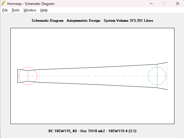

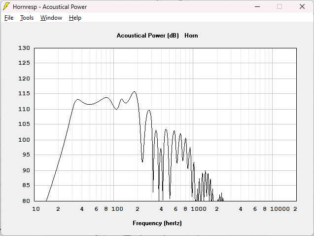

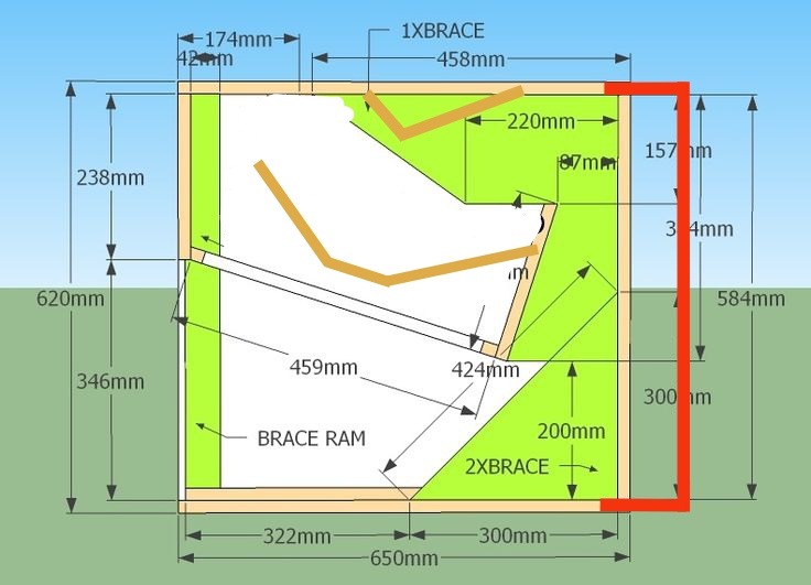

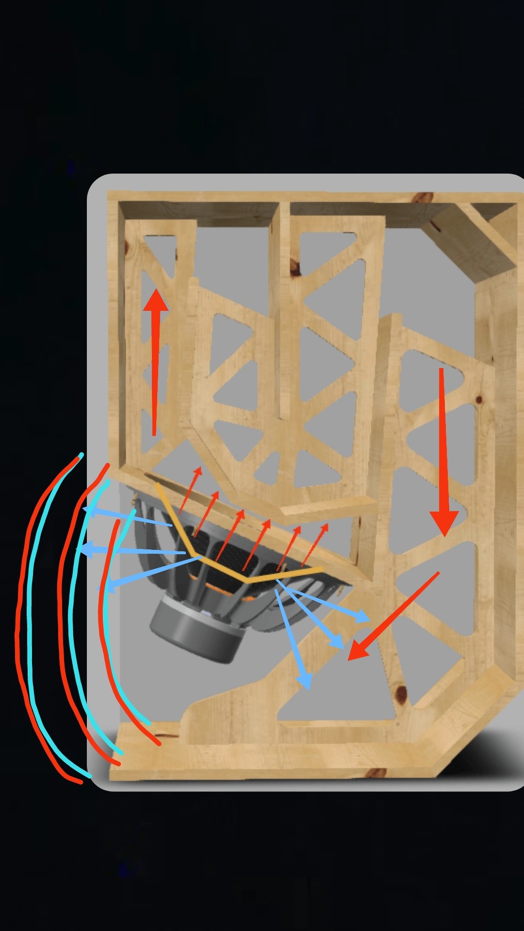

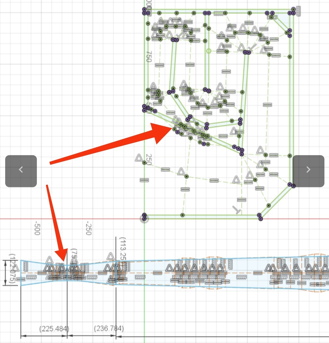

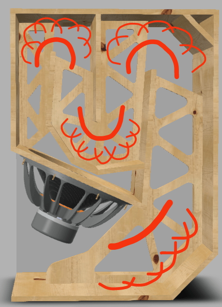

I explained in those pictures how sound waves travel and no need others deflectors, push themselves out and create their own reflections and volume is essential here.
In third picture how the two parts of the driver enter in phase together, here we have an increased power.
Hornresp does't know how driver are installed and we have addition volume.

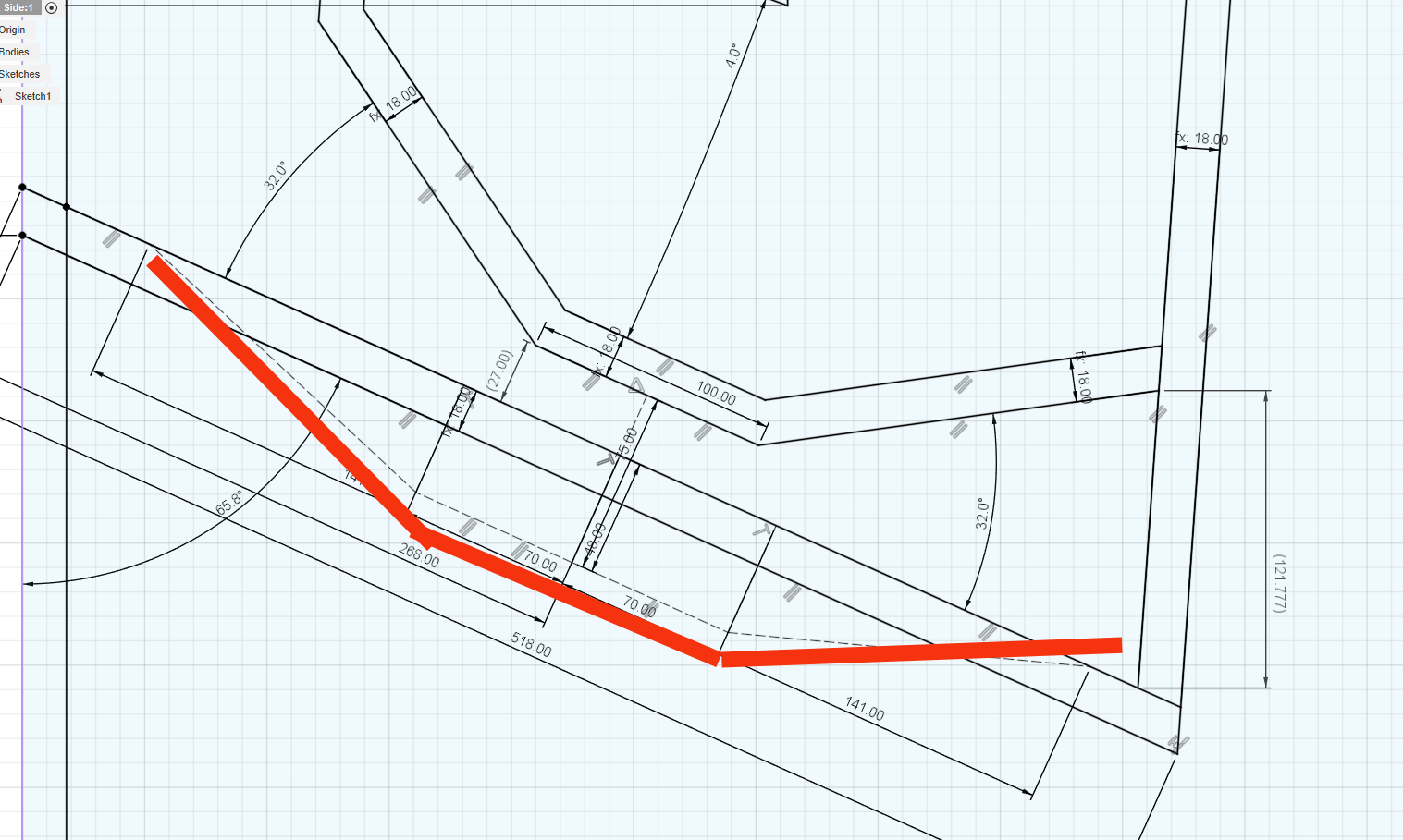

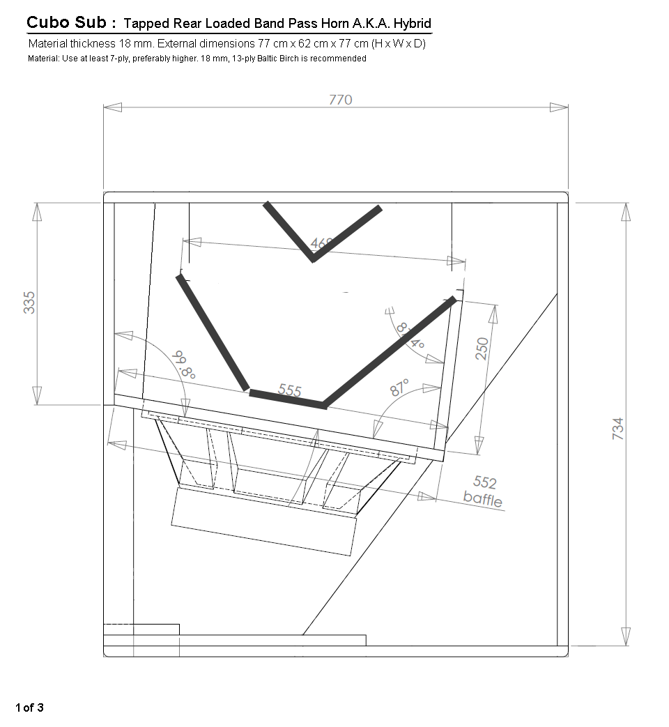

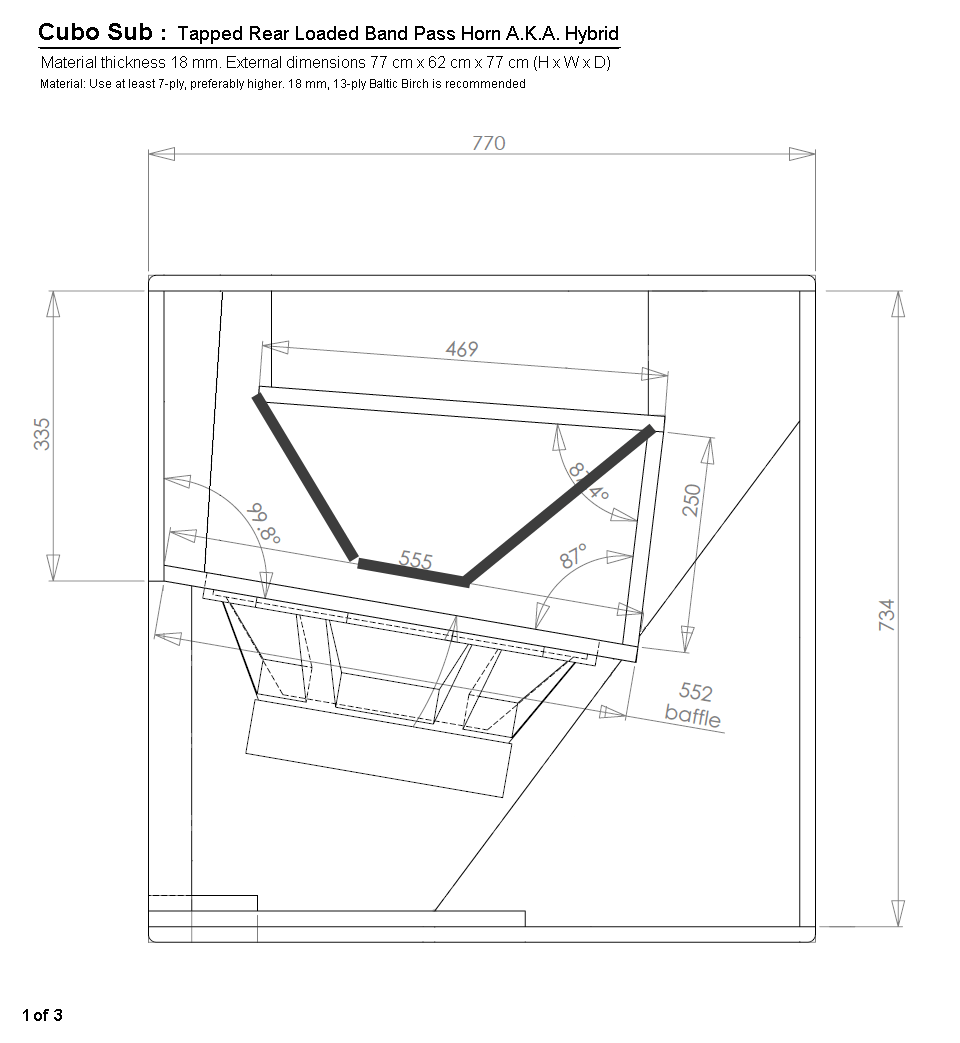

Brothers, let's no end with this model and I come up with a new idea if we could make something compact and easy to transport and compress the driver in the same way, but how effective will it be? being something small but with other advantages. I bring here an 18" cubo model to convert and who has some new ideas and inovation for lite model
