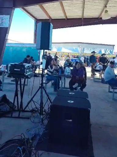

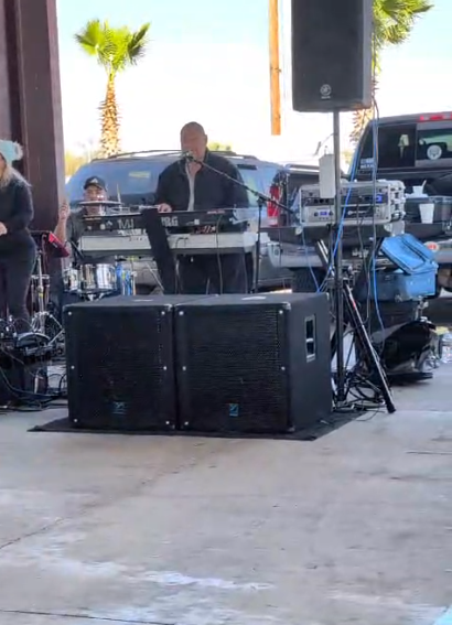

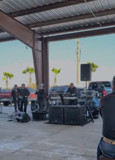

last sunday i run sound for a live band , dance floor was for around 50 people max
with a pair of DSR112's (high pass around 120Hx ) and a pair of yorkville BASS cabinets ( LS608's) driven
by a bridged XLS2500 , i was able to get a nice mix from 40feet away.
the bass cabinets was high passed @50hz ( per yorkville specs)
and people were all happy dancing all over texmex music

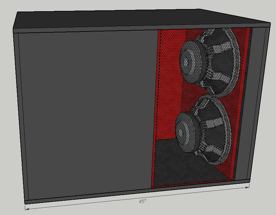

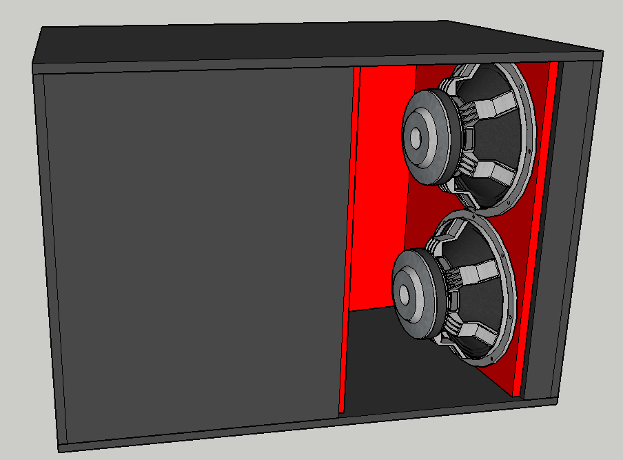

and BTW i am eager to make 4 of these,
just one cab will wipe the floor off the 2 old yorkies
( double 15's TH cabs designed by Art Welter)
called the B Lowrider cabinet

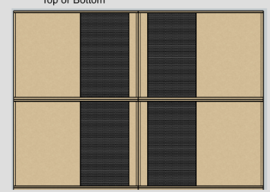

i updated the drawing and added 2 drivers inside

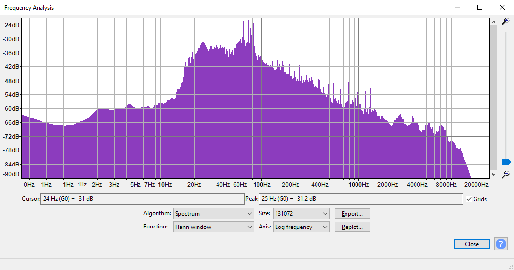

After performing a spectral analysis using Audacity on a large subsection of the audio from the above track, the results are plotted below. This track has significant low-frequency energy between 21Hz and 80Hz. It's interesting how there are three quite distinct, narrow peaks at 16Hz, 18Hz, and 19Hz, and a much broader peak at 25Hz or so. A very long FFT length was needed to resolve them.Here is a bass recording:

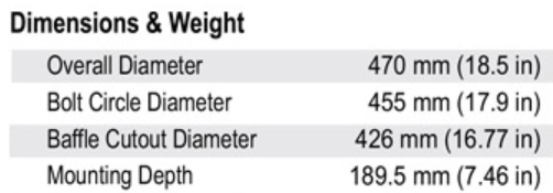

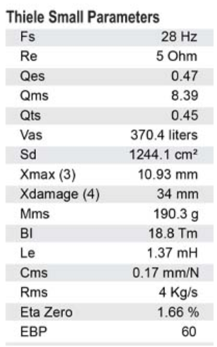

Hi

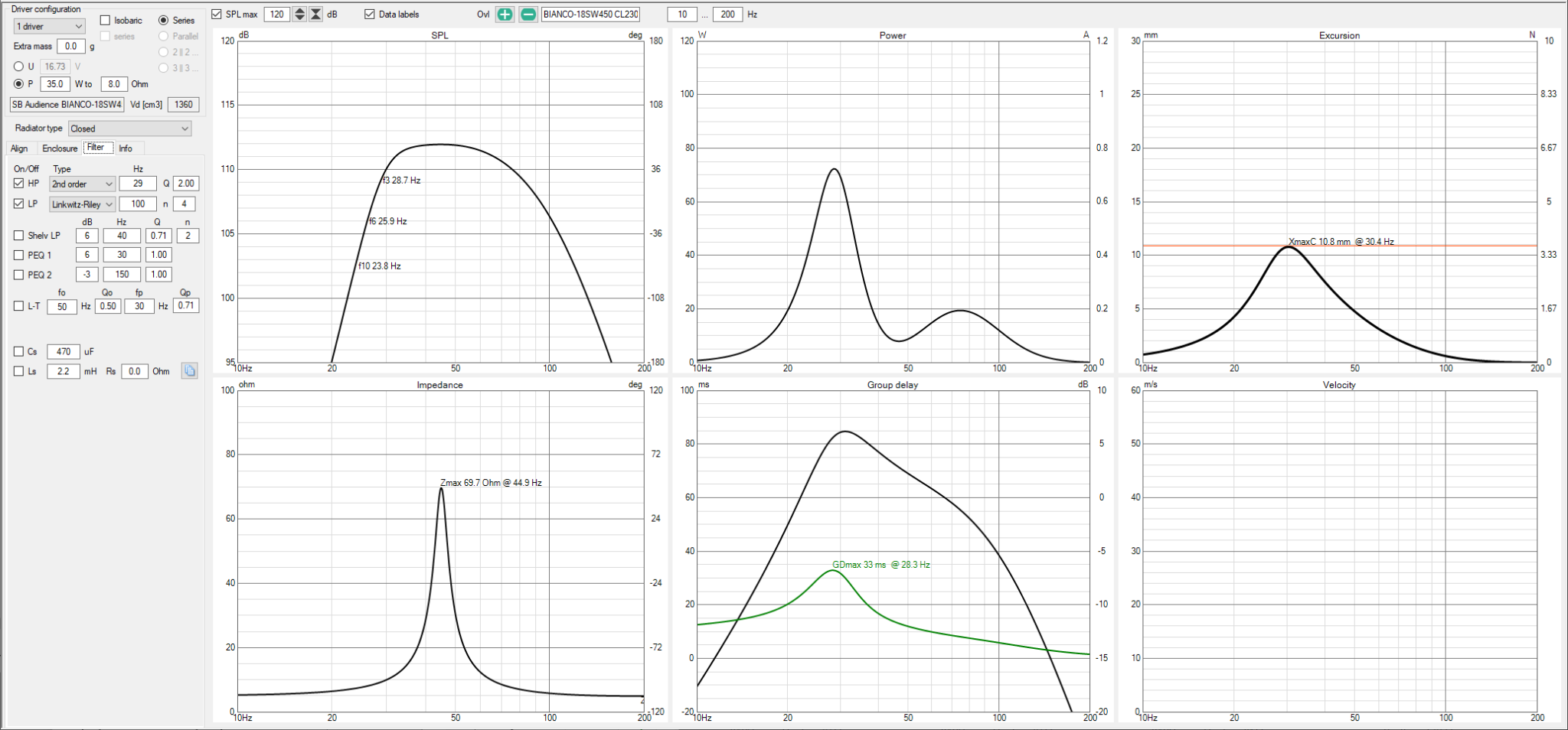

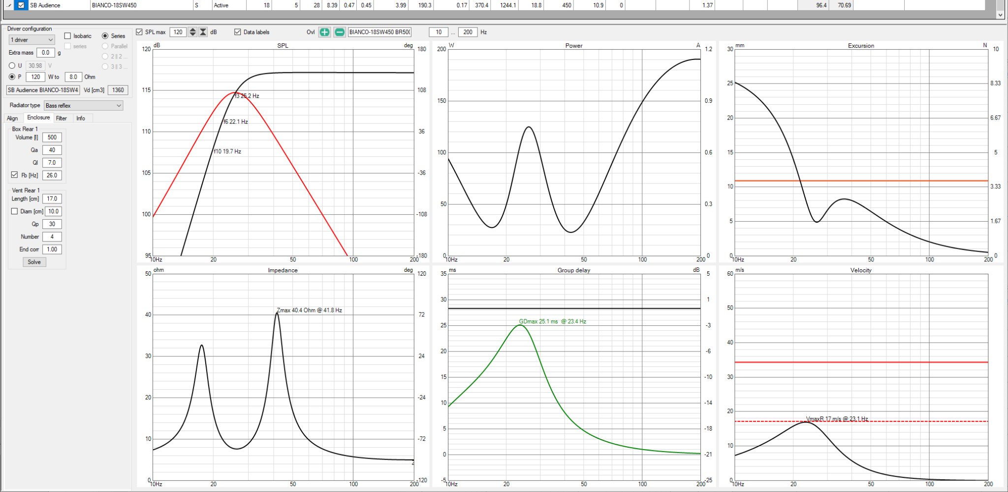

I have a SB Audience BIANCO-18SW450 18" Subwoofer can someone give a box design for this driver
regards
Anand
regards
Anand

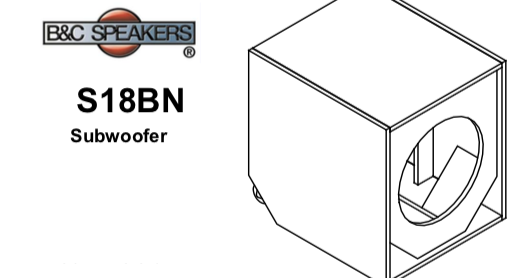

Anand,
The BIANCO-18SW450 is a bit low on BL motor strength for a tapped horn.
It would be better suited in a bass reflex box, something like this S18BN:

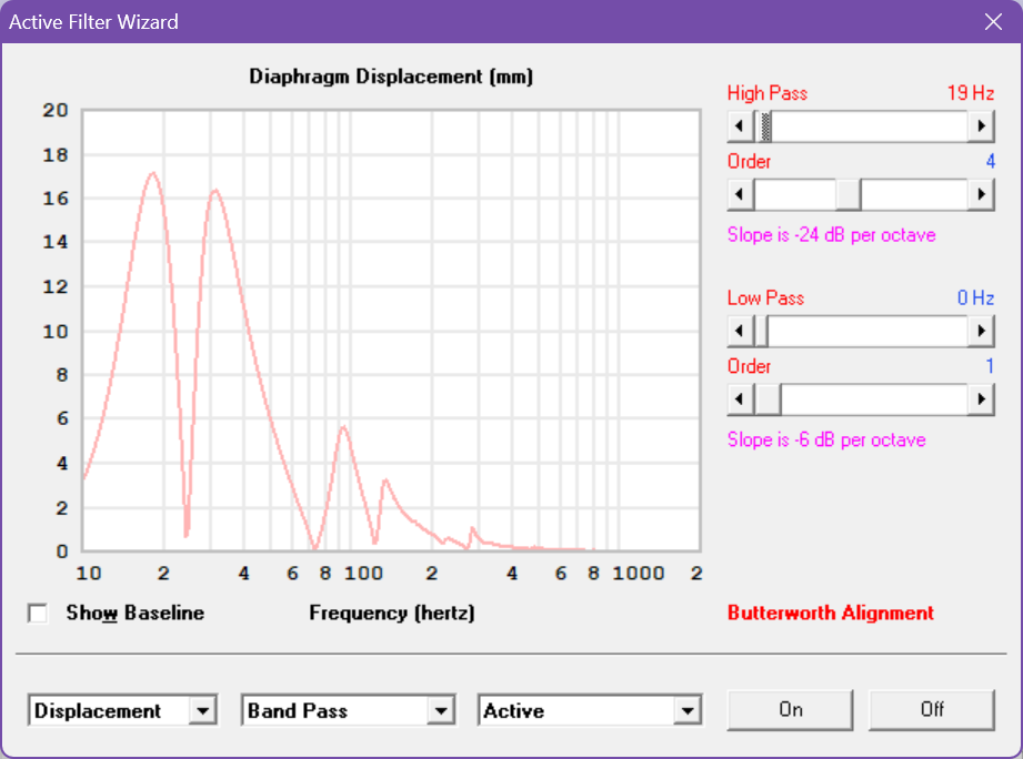

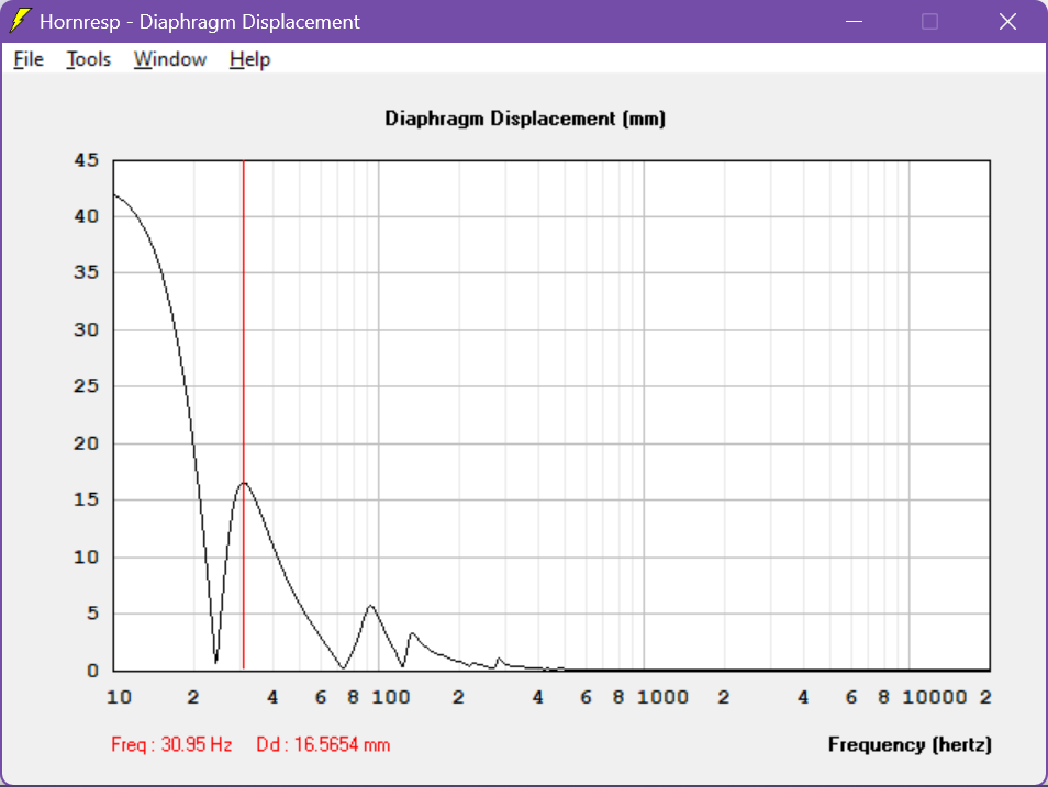

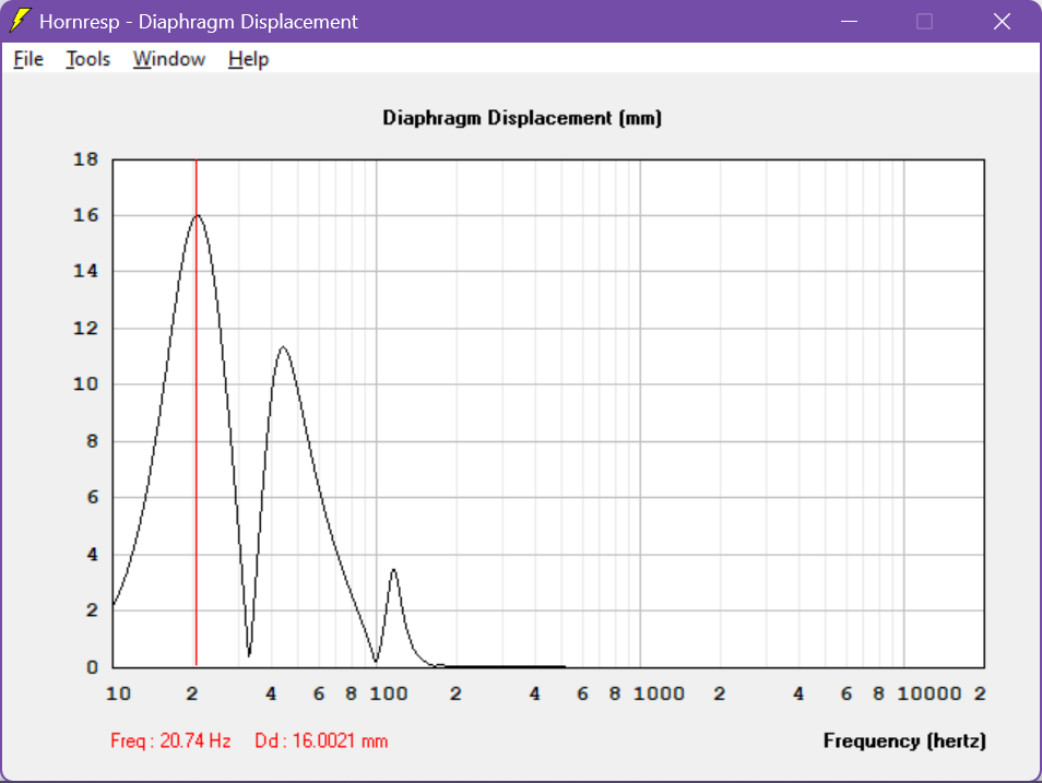

I plugged the BAINCO-SW450's Thiele–Small parameters into VituixCAD. It seems that this driver can have a quite extended bass response in a 500-litre vented-box enclosure tuned to 26.0Hz. The −3dB low-frequency cut-off point is a quite low 25.2Hz. it can produce around 117dB SPL for 120W re 8Ω, only exceeding its linear Xmax below about 20Hz. It is highly recommended that an infrasonic filter be applied in the interests of driver protection.I have a SB Audience BIANCO-18SW450 18" Subwoofer can someone give a box design for this driver.

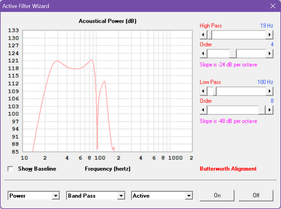

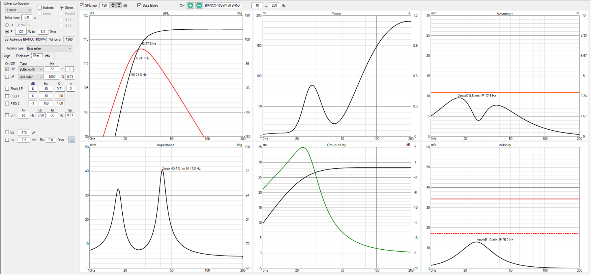

Adding a 2nd-order 22Hz Butterworth high-pass filter produces much reduced infrasonic driver cone excursion, while only raising the subwoofer's cut-off frequency by 1.3Hz. The results are shown below.
A 230-litre closed-box enclosure with a high-pass peaking filter and a low-pass filter in action produces the following simulated response.

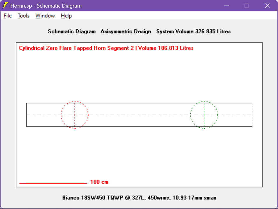

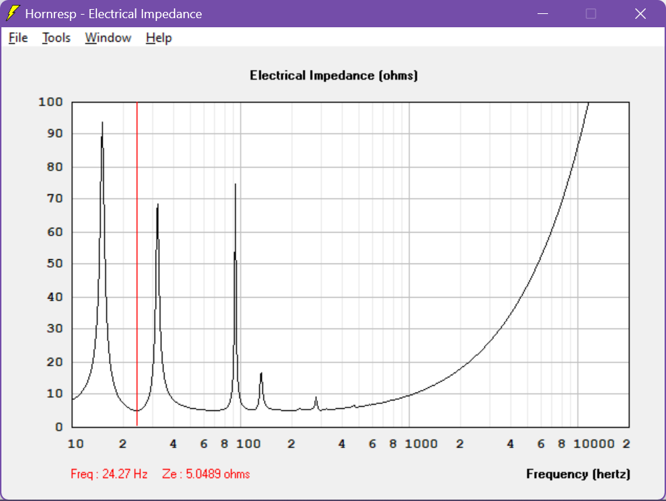

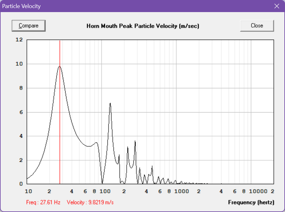

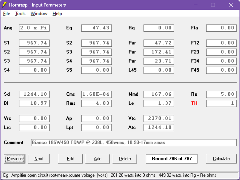

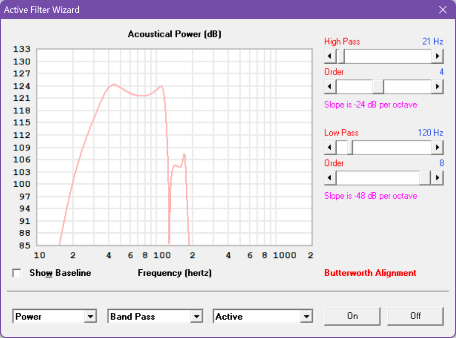

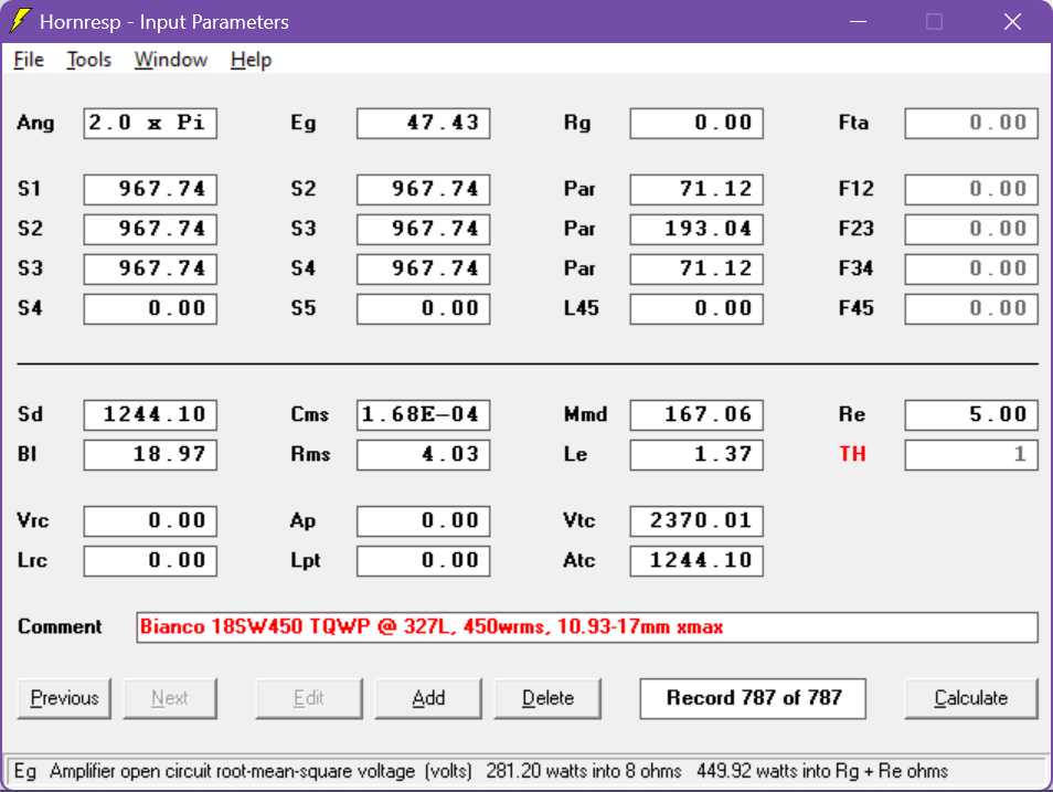

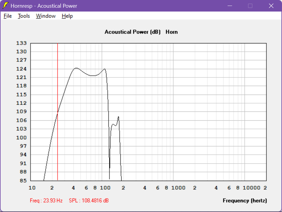

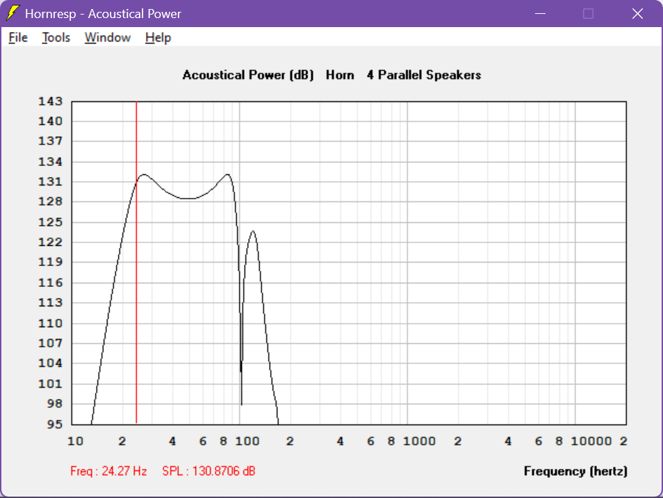

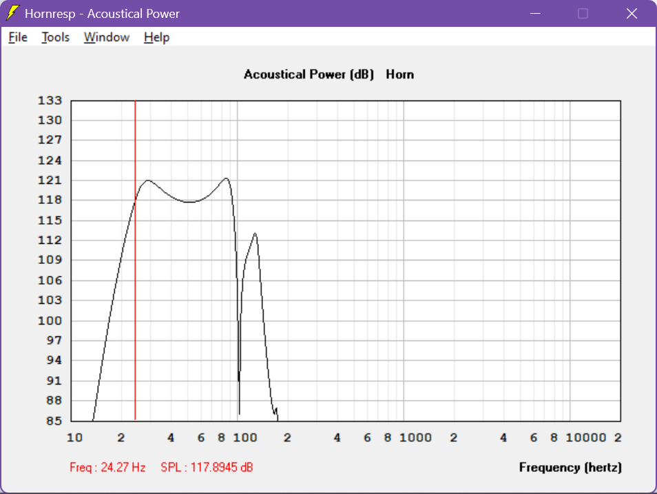

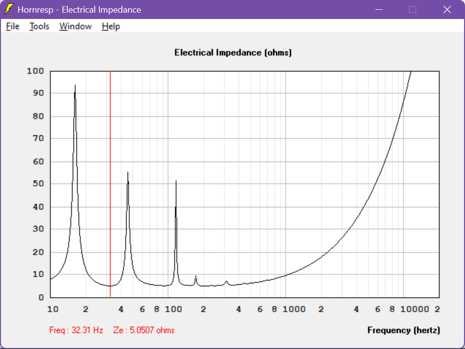

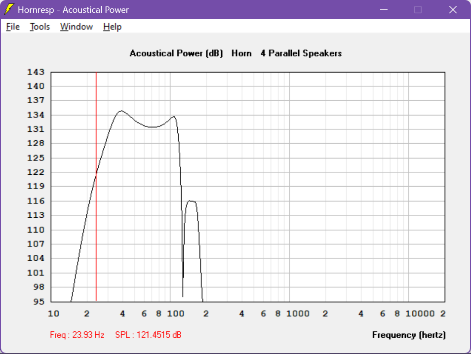

11 foot long 327L (Chevy small block V8) straight flare TH (TQWP or TQWT) = 118dB @ 24hz ground plane outside or 130dB @ 24hz in a corner, vehicle, or 4 enclosures ground plane outside.

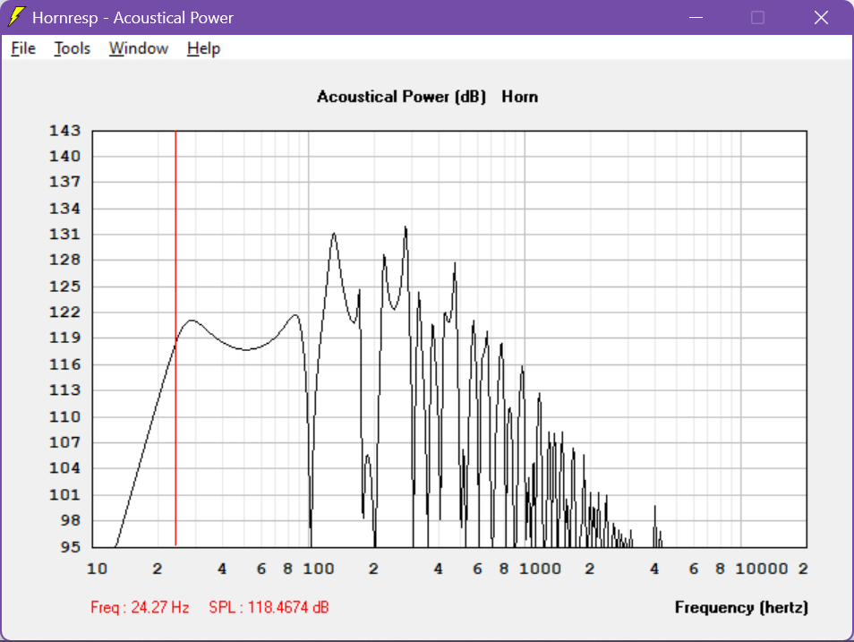

An 8th-order low-pass filter, such as the one simulated, to tame all those highly-excitable upper-frequency resonances seems to be a real necessity. A little bit of EQ in the dip between the two SPL peaks would flatten the response by about 3dB. A closed-box or a vented-box system seems to be much easier to implement, but if a maximum SPL output capability is needed, then the tapped-horn enclosure seems to be able to supply it quite well.

327 liters is 19,955 cubic inches.11 foot long 327L (Chevy small block V8)
A Chevy small block V8 has 327 cubic inch displacement, 5.36 liters.
The air volume occupied (filled) by the Bianco-18SW450 driver is 7.32 liters, 447 cubic inch.
It would be something if subwoofers could handle the horsepower a car engine can produce..
