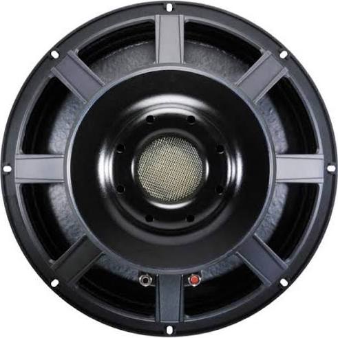

That vent should look more like this speaker.
