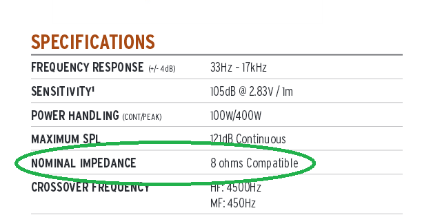

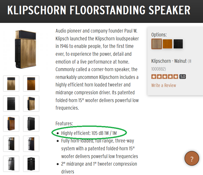

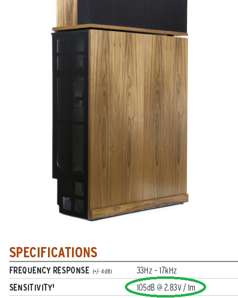

It seems that even Klipsch can't decide which way to go 🙂.
105 dB @ 1W / 1m in one place (see Attachment 1)
105 dB @ 2.83V / 1m in another (see Attachment 2)

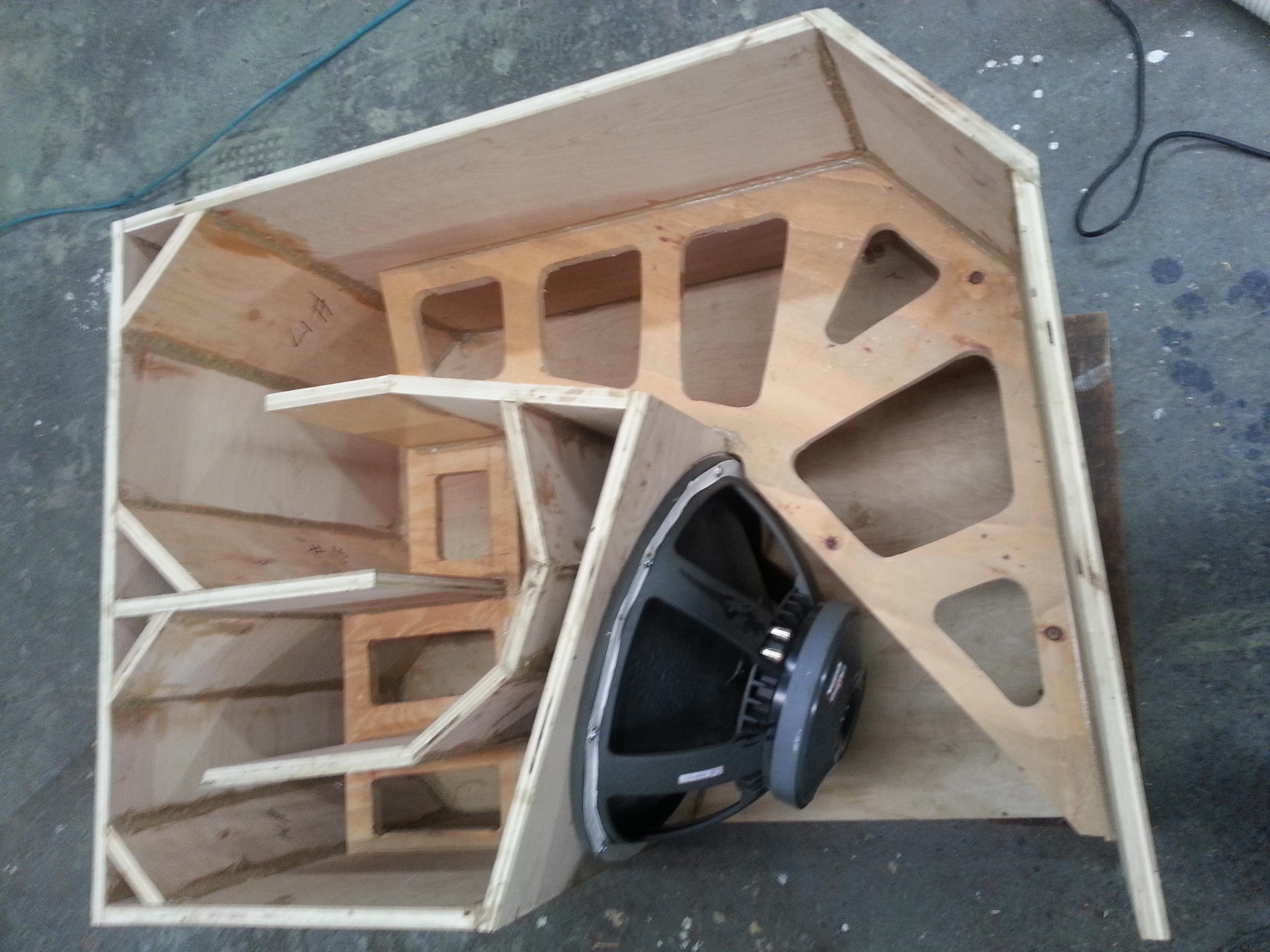

One more question and related to build. I've seeing people using screw over nail working with polywood, Is there any specific reason? If it was different wood like MDF the reason is clear once it's compatible with nail.
To use removable perforated (or extruded) metal grill is necessary to change a little one panel shape adding material as highlight in red. So it creates a parallel surface with bottom panel.
If you're gigging the boxes heavily, screws just make them a tad stronger for rough handing, otherwise nails are fine.
Hi LORDSANSUI,
I used to only use screws, but since I've gotten a number of air nailers for other construction projects I've come to realize that nails do a fine job too.
The difference is in the clamping force, with screws at 8" intervals you will not need clamps, with nails at even smaller intervals you may still need to clamp, and you may need more drying time for the glue.
Most guys that put a lot of boxes together in the diy community recommend polyurethane glue, e.g.: Loctite PL Premium; and nails. I have had good luck with regular "yellow" carpenter glues, e.g.: Titebond Original; with nails and with screws. Both glues are widely available, e.g.: Home Depot. PL will do a better job bridging small gaps, but for horn construction you don't want "small" gaps, oh well. I like to pretreat edges with a wipe of carpenter glue, and let it soak in, then reapply glue prior to putting the wood pieces together.

Hi Oliver,
Klipsch gives the nominal impedance as "8 ohms Compatible", so I guess the 1W / 1m input voltage is calculated assuming an 8 ohm load, meaning that:
105 dB @ 1W / 1m
105 dB @ 2.83V / 1m
are one and the same, for this case at least 🙂.
