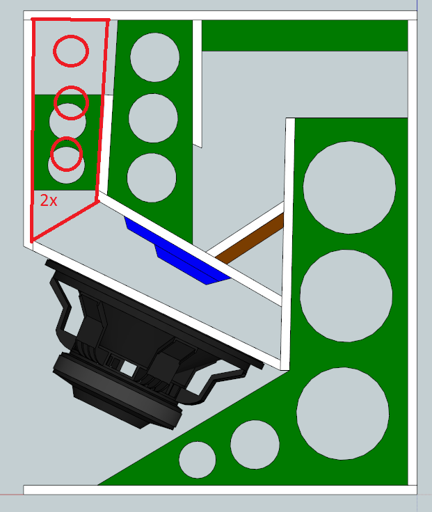

Taking advantage of this post here are some images regarding bracing, cone correction and grip.
It has enough bracer for 800W cab?
Green = Bracer
Blue = Cone correction
Brown = Grip

Thanks for your suggestion Oliver.
I extended it till the baffle and add two additional small bracer between cone correction and baffle. Do you think it's necessary or too much? I already saw doubling baffle but never saw people adding bracer there (my experience is too short).
The plan is to build the cab in polywood 15mm, what thickness would you suggest to build the bracer? ? 12mm or 10mm?
I'd just use the same plywood that is used for the other panels for the braces. I like the little braces from cone-correction to driver baffle, that's an area that needs as much support as it can get, and you made the internal width a little larger than necessary, so additional support cannot hurt. Also, add a second layer just around the sides and bottom of the mouth about 2"-or so-wide, than use a removable perforated (or extruded) metal grill.
