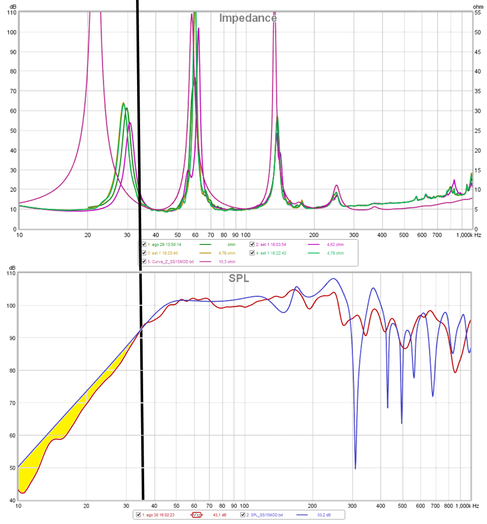

i see the same dip in the sim as the FT30,witch is absent in realety.
i'm curius why that is.

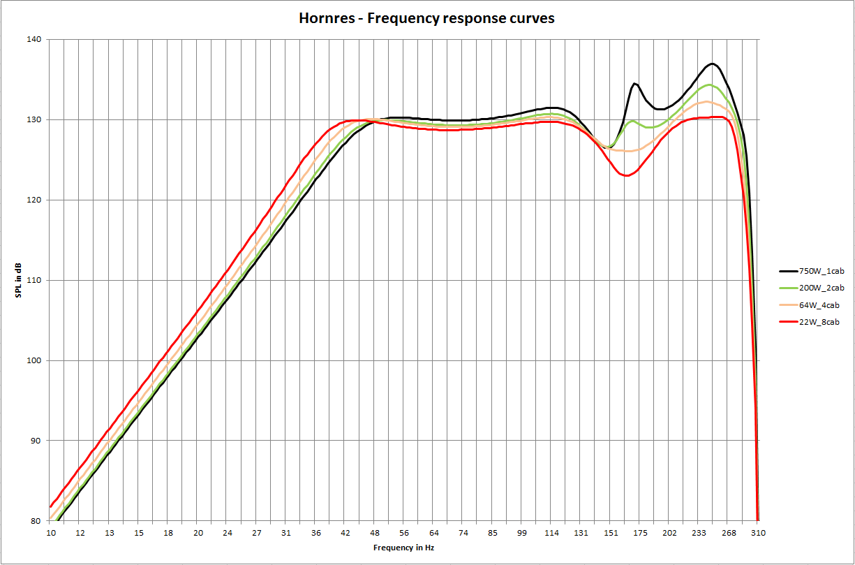

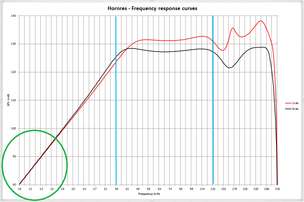

The result is below, I used the same variants for 130dB SPL (Post #162 - table inside image) and looks like the lower frequency upper limit for SS15MOD+HPX2150 is ~141Hz, probably would be better to keep Xover under this value (lazy set up 😀 )

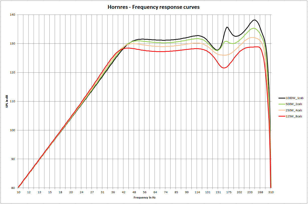

At post #162 there are some simulations results and it's easy to check reading the columns that when you double the power input the output SPL will increase 3dB, but while doubling cabs the result was little different for some reason. You can double check the table if it's needed.
What weltersys suggests at post #165 should be right, and I was expecting the same, but wasn't the case, see the attachment #1 the results didn't provided the same output SPL while at the attachment #2 I achieve the same output SPL with different power ratio.
weltersys ratios:
1 cab = 1000 Watts/cab = 1000 Watts total Power ratio=8
2 cab = 250 Watts/cab = 500 Watts total Power ratio=4
4 cab = 62.5 Watts/cab = 250 Watts total Power ratio=2
8 cab = 15.625 Watts/cab = 125 Watts total (reference)
The ratio I was able to achieve the same output SPL (130 dB)
1 cab = 750 Watts/cab = 750 Watts total Power ratio=4,26
2 cab = 200 Watts/cab = 400 Watts total Power ratio=2,27
4 cab = 64 Watts/cab = 256 Watts total Power ratio=1,56
8 cab = 22 Watts/cab = 176 Watts total (reference)
It is not clear to me what it is exactly, that you are trying to achieve
I was playing around with multi cabs to better understand the effects so I came with the idea to plot the graphic on post #163 to make the result more friendly for others.

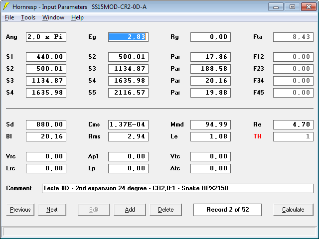

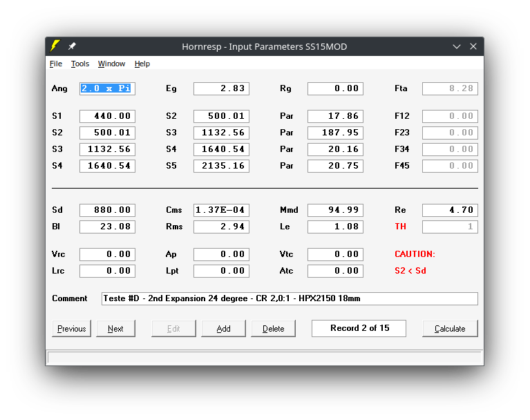

Q1. Would it be possible to post a screenprint of the input parameters window for your test example?
Q2. What value are you using for the "load impedance in ohms" when calculating the input voltage Eg required for a given power?
Q3. Are the multiple cabinets connected in series, parallel, or series/parallel?
Kind regards,
David

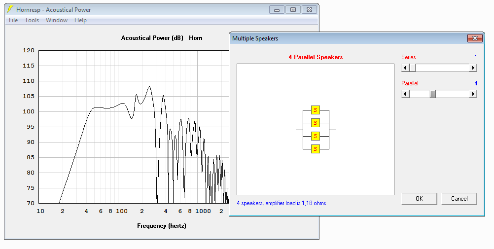

Hi David,
below the informations
See attachement #1
8 ohms
All variations were simulated in parallel using the Tool "Multiple speakers..." at acoustical power screen. See attached # 2 as example for 4 cabs.
See attachement #1
8 ohms
David

Hi LORDSANSUI,
Thanks for the additional information.
I will investigate further, and let you know what I find.
Kind regards,
David
weltersys ratios:

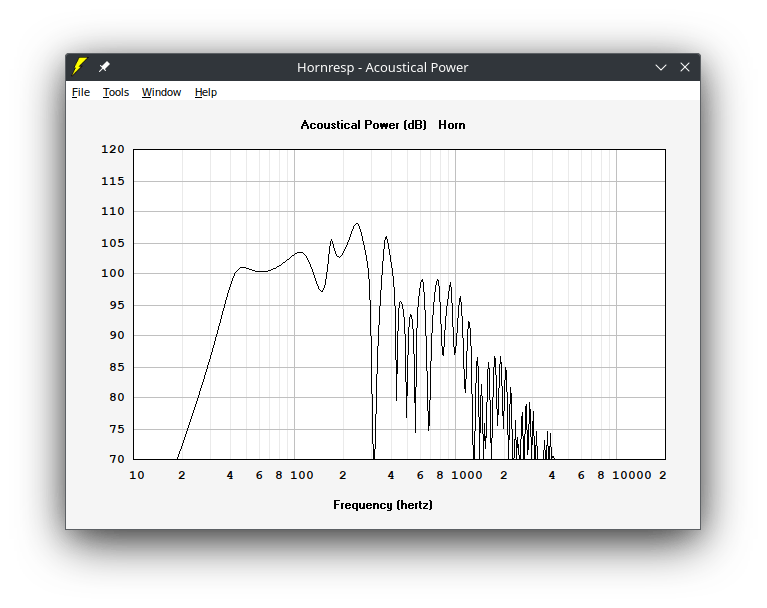

I have checked the Hornresp multiple speakers model and everything appears to be in order. The weltersys 1 cabinet versus 8 cabinets total power ratio of 8 assumes that the drivers in the multiple cabinets act as one large "composite" driver. This idealised model only applies at low frequencies. Your calculated total power ratio of 4.26 is applicable at some higher frequency, where the composite driver model no longer holds true.
Sanity check of weltersys ratios using your tapped horn test example:
1. Set frequency range to 1 - 2000 Hz
2. Set Eg = 89.44 volts (1000 watts into 8 ohms)
3. Sample acoustical power response at 0.1 Hz
Total electrical input power = 1701.9230 watts
Sound pressure level = -79.3340 dB
4. Set Eg = 11.18 volts (15.625 watts into 8 ohms)
5. Sample acoustical power response for 8 speakers in parallel at 0.1 Hz
Total electrical input power = 212.7404 watts
Total electrical input power ratio = 1701.9230 / 212.7404 = 8.0000

Hi David, thanks again to help, but looks like we reach to the point that the Math are not helping real life. What I mean, this design is planned to be used at the bandwidth starting from 36Hz till 130Hz as indicated in the attachment #1 by the blue bars, so in that bandwidth we can see that the response from 1cab (Eg=89,44) are not aligned with 8 cabs (Eg=11,18 - parallel).
In additional, you made the math at 0,1Hz 😱 😀 considering that human being can rear just over 20Hz, the result is no useful, the curves are overlapped almost till 15Hz, still not useful.
Based in the passband, while doubling the input voltage the SPL increases 3dB the same don't happen when doubling cabs.

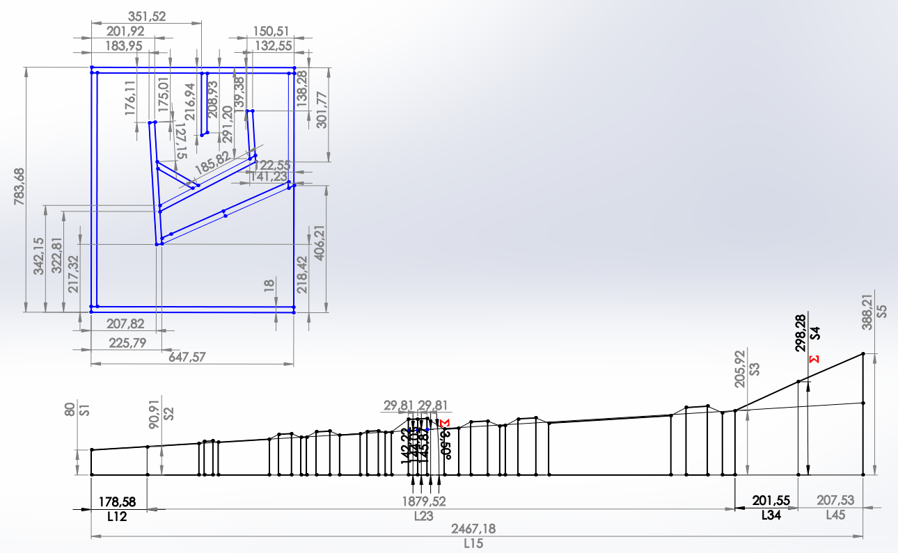

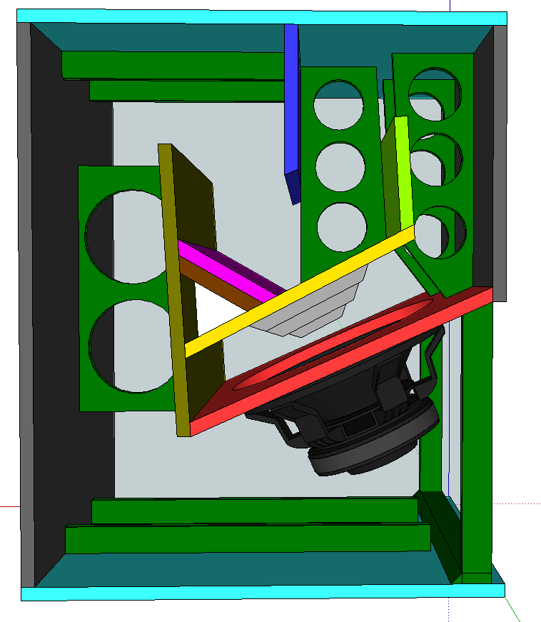

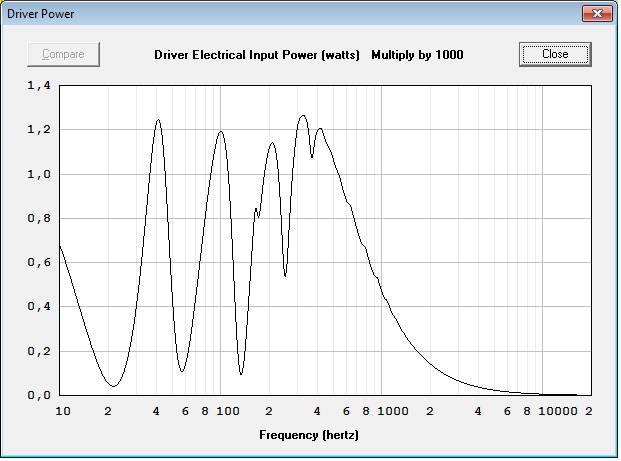

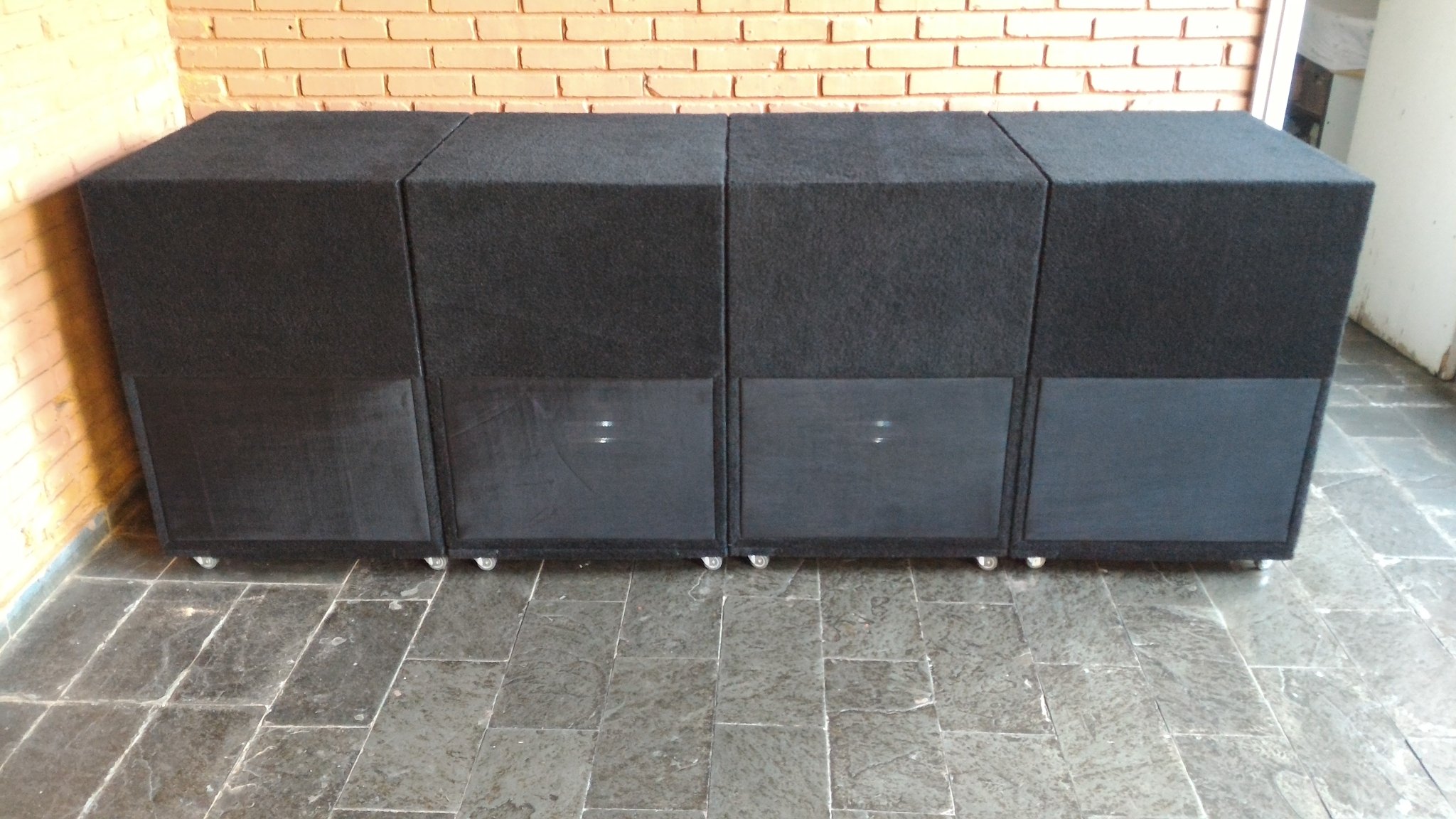

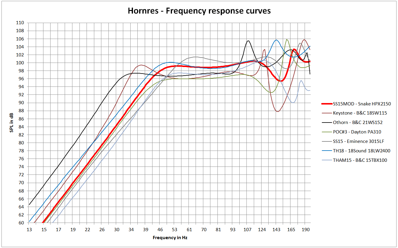

Find attached all the information I think remains useful.
Hornresp Input
Hornresp SPL
Benchmark (SPL)
Sketch

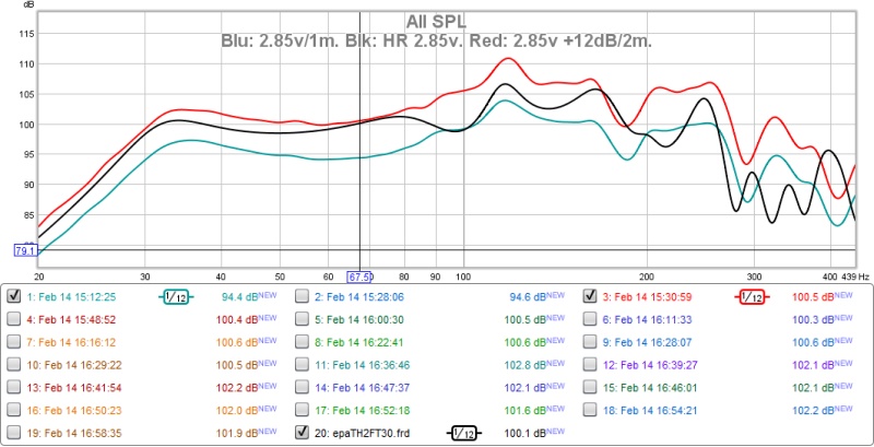

Measurements vs Simulation
Bracing
Hornresp txt file
3D from Google Scketchup
3D from Freecad
This model fits better for drivers with intermediate motor force and it was tuned to as flat as possible in this case.
In the benchmark you can see that in the upper range some designs shows peaks as spike, mine show a small dip witch I think is better for integrate it with tops. In the measurement the dip was also smooth due to cone correction improving even more the output SPL.
