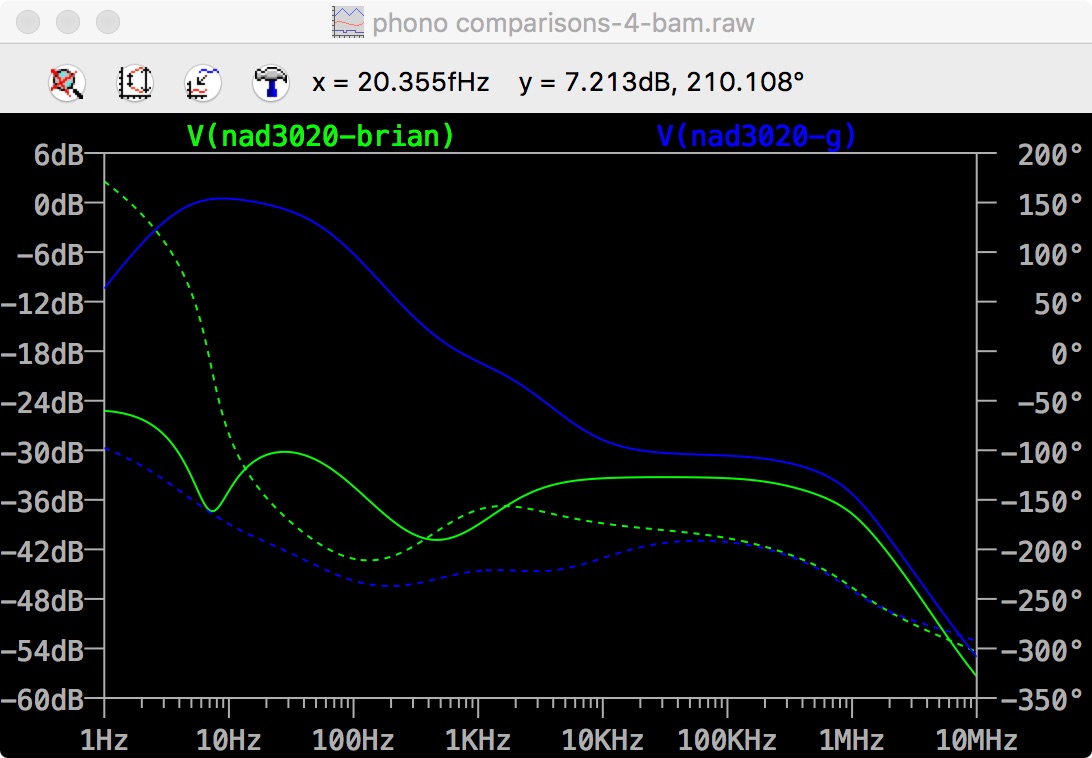

Performance is a priority. And I'll listen to all the advice I can get. I may cherry pick from it. Let me see if I understand what items on my Boar#1 latest diagram are at odds with the advice so far:
a) Shunt Regulator:
i) don't need it at all and can rely on upstream regulator (can by bypassed)
ii) use a simpler shunt regulator (can be built without current mirror using existing pcb layout too if desired with higher Zout)
iii) stability concerns with Darlington device (can be built with regular BD139/BD140 if desired with higher Zout) - I'll add a zobel to the shunt output too just like any other negative feedback 'amplifier'
b) Buffer:
i) some folk don't like them - it too can be bypassed / not installed on the pcb but I think it'll be beneficial to the phono amp in driving a volume pot.
ii) an i.c. would be better - ? no argument here, but this is an example of where personal preference takes over. Hopefully my buffer is both simple (undamaging) and effective
c) Phono amp: - I've pretty much taken this from the NAD. I like the historical reference, the circuit simulates just great and has gobs of headroom. I'm not sure what advice I missed on this one regarding the design except
i) don't use a small cap on the input as it raises input impedance at L.F. which increases noise. I have doubled the value from 0.47uf to 1uF.
What ese did I miss ??

NAD phono improvements post #257.
Got it 😀
Purely from a historical interest perspective, this also ensures that the -ve rail can be -25V instead of my -30V so operating points are the same.
