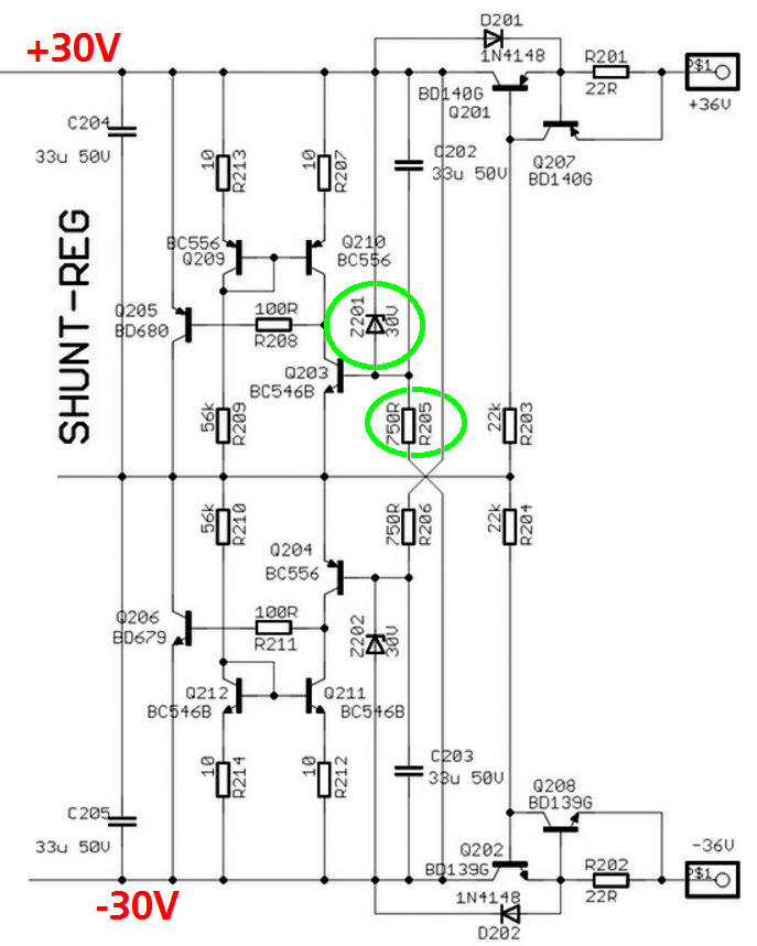

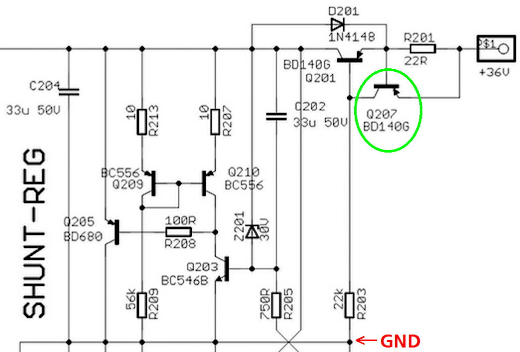

I have a few questions about Q207 in the schematic attached to post #320 (copied below)
1. What is the worst-case scenario that causes the very highest power dissipation within Q207 ?
  • Power switch-on?
  • Power switch-off?
  • Charging up all downstream capacitors from 0V to 30V?
  • Downstream fault that shorts output to GND?
  • Output not connected to any downstream load?
  • High temperature?
  • Some combination of the above?
2. Numerically, what is the very highest possible power dissipation in Q207 ?
3. Which SMD packages are rated to handle Q207's max possible power dissipation, comfortably? Which SMD packages absolutely cannot handle Q207's max possible power dissipation?
4. Which thru-hole packages are suitable for Q207's max power? Which thru-hole packages are unsuitable?
_
I didn't look too carefully at the corner cases on Q207 but I can't see it dissipating very much power at all, very little actually. You may be asking because I chose a TO-126 part. My thought behind this choice is that it's convenient to mount on the heatsink along with the main pass transistor Q201. There is some benefit in having them thermally coupled for stable current supply - overkill but it costs me so little.
Output current equals (VBE_Q207 / R201).
If you want output current to be constant and independent of temperature, you can either
* Choose an R201 which has the same temperature coefficient as VBE_Q207 (about -3000 ppm per degree K) and thermally bond them together to guarantee they are always at the same temperature. There don't seem to be any thru hole resistors with that tempco; in SMD you could use the Panasonic ERAS, ERAW, ERAV
* Find a way to operate Q207 at constant temperature, independent of supply voltage, independent of load current, independent of the temperatures of the other transistors. And operate R201 at constant temperature as well.​
Thermally coupling the control transistor Q207 to the pass transistor Q201 makes the output current variation bigger, not smaller.
Good catch Mark ! - in this case, I would change Q207 to a TO-92 device and leave it free-standing, not on the heatsink. How did I get to this point ? - I used a diode + bjt current source in another project and thermal control was better with the diodes and bjt coupled. However, that was a different circuit. So far, in this project, I haven't used SMD transistors. I have some in my junk box but it hasn't crossed my mind to use them here (yet).
