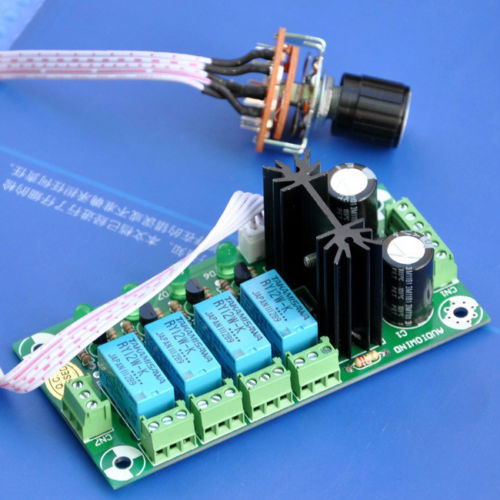

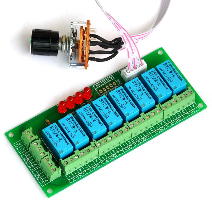

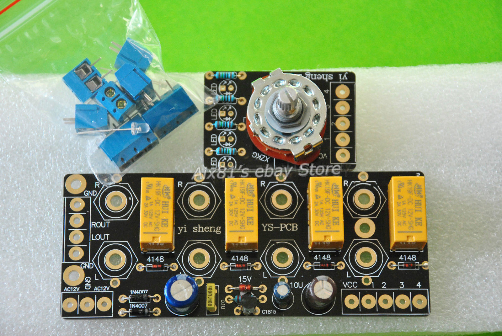

Whilst It's nice to design my own input selector, it's a rather mechanical process of layout space for some relays.
I'm having doubts that it's worth the trouble after seeing some ready made stuff available on ePay. There's a balanced input option which I could use to switch the signal and the signal ground lines. All I have to do is hit 'buy now' and the darn thing will turn up ready to be bolted into the chassis. This is really tempting.
Will you switch ground also ( only needs one ground )? Make before brake time constants using NE555 if space allows? I have used fancier solutions and always came back to them. You can serial connect them which seems better than the NE555 data sheet. If so a transistor every so often to account for voltage losses. 12V relays work OK at 13 to 9 VDC. In this use the open collector transistor used for repating waveforms can be commoned to reduce losses and raise current output ( circa 350 mA ). Use high senstivity relays to keep load minimal.
Joined 2009
The balanced options provides a means to switch two signal lines per channel so this would seem to be the way to go if I want to switch grounds. Some engineering may be needed on the timing aspect but is probably doable one way or another. I'd have to take a careful look, these Chinese boards are not always what they seem and could end up costing more effort than it saves.
Release time is usually faster than operate time in relays. One option to create make-before-break is to use them in reverse - all on, and use the NC contact to do the desired input connection.
That's not bad. On my system although built for pennies the switched grounds make it one of the better ones compared with ones that's friends have. My speakers are 99 db/watt so really show it. Mixed ground noise must be a very high distortion factor if people are excited about - 90 dB distortion. Hum and RFI are distortions. I don't mind having what my sources have, I don't want what isn't them.

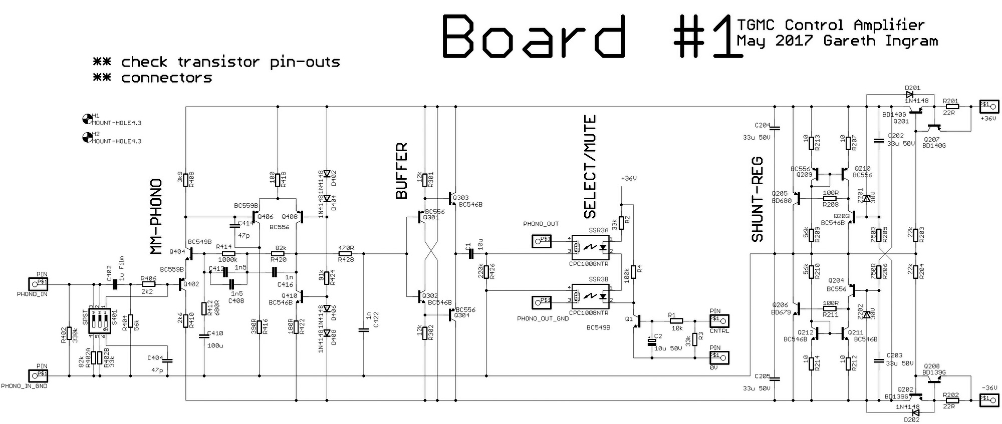

Board#1 - the Phono Stage
I was finding the layout cramped and not to my liking. So I took a step back and am now exploring a suggestion made earlier in the thread to focus on the phono stage. By making the first board the phono module there is more space to layout the circuit.
In fact, it looks as if this first board would be suitable as the main meal in a stand-alone phono amplifier, without being part of a more complex pre-amp. If anybody fancied building a dual-mono phono-amp then this would be a good place to start. I rather like that.
