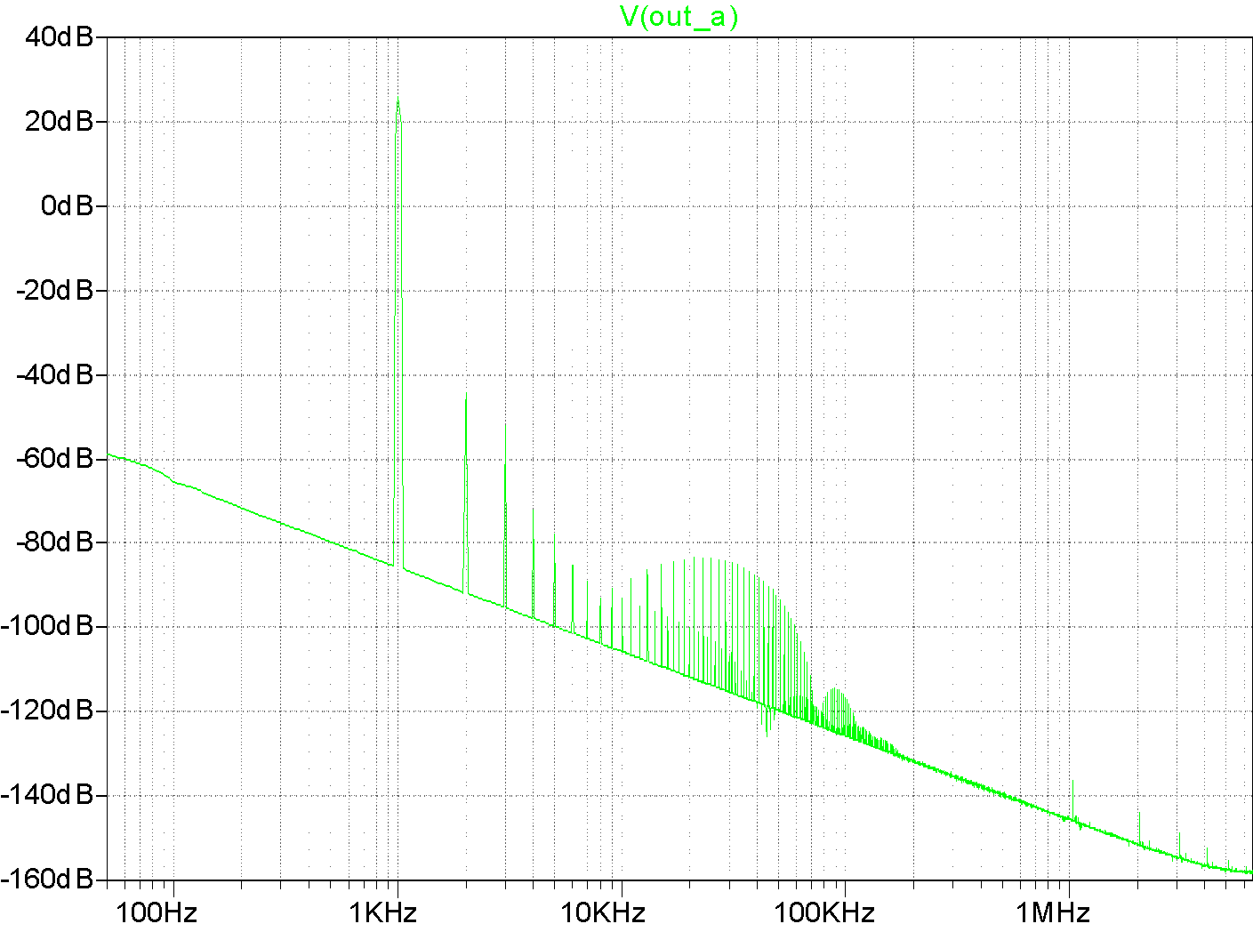

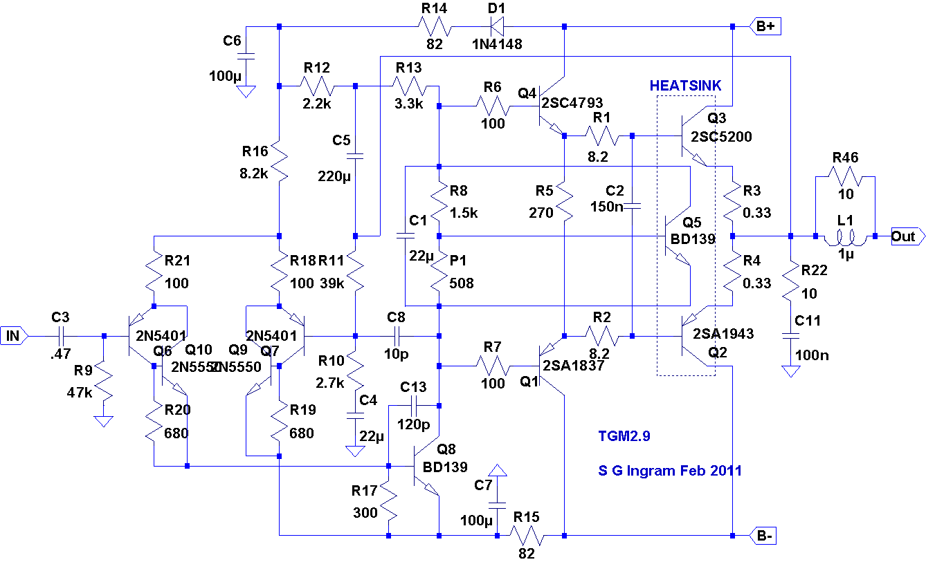

This isn't my amp. I offered the TGM2 modules to a friend, who supplied the heatsink for me to attach them to. The modules were no longer being used since my HT set up was only using 3 already built channels in my DIY unit and there aren't any other projects to use them for since I'd like to try something new. However, I thought it would interesting to try them out on the higher rail voltages which I've not done before, so I decided to donate some time to it. I've attached the as-built schematic and simulated fft when dissipating 50W into a 8 Ohm resistive load.

Why put a series resistor with C8? What is the effect that is tuned?
Very nice Bigun.
1u for L1 is large. I found in simulation that sometimes as low as 200nH was enough (determined by hanging a very large capacitor off the output, with and without various values of inductance). Also, C11 in most cases can be 10nF (maybe higher if R22 is inductive?). Both of these changes will help HF I think.
- keantoken
Hi Keantoken,
I'm afraid I guessed at the value of the output inductor based on what others have claimed for their home-made inductors. What I did notice though, was that there was always a bit of ringing on the square wave test with sufficient levels of capacitance at the output and even gobs of Cdom didn't eliminate it - of course an ultra-fast square wave is a brutal thing too. I didn't try a series resistor with the phase lead cap but that makes perfect sense to try.
The zobel (C11) was adopted from TGM1, which at the time was based on information I could find from similar designs such as AKSA, DX etc. rather than from a proper understanding of it's function.
Well my word is not always right, you should ascertain the facts for sure in your own studies. Each amplifier has it's own appropriate network. Symasym used 500nH. It is very possible to determine what is the best output zobel empirically. IMO, these things can only be determined for certain using a real prototype.
Bigun, if you connect a capacitor directly to the output, your load effectively becomes a resonator (whether with the output zobel or simply the inherent inductance produced by the feedback mechanism of the amp). With a finite output impedance, some ringing cannot be avoided. That is, unless your amp has such high output impedance that the RC filter formed by the cap absorbs the frequencies which excite the resonance. And then you'd see a stable square wave, but, is it really better, or just different?
Up to a point, adding more compensation only serves to turn the amp into a crude lowpass filter. If at this point the amp is still not stable, it means you have an internal resonance and a new type of compensation must be added or the current compensation reworked. This is where a lot of people give up and deem the design "unworkable". Compensation is not simply something you do after the fact to complete a design - it is its own science. Perseverance pays off.
- keantoken
There is some math involved for the optimum value of the output inductor but it escapes me. AndrewT knows it (I'm sure). It has little to do with the compensation of the amp itself.
Self recommends between 1 to 7uH in his book and advises that all high feedback amps should have one, to guard against capacitive loads.
