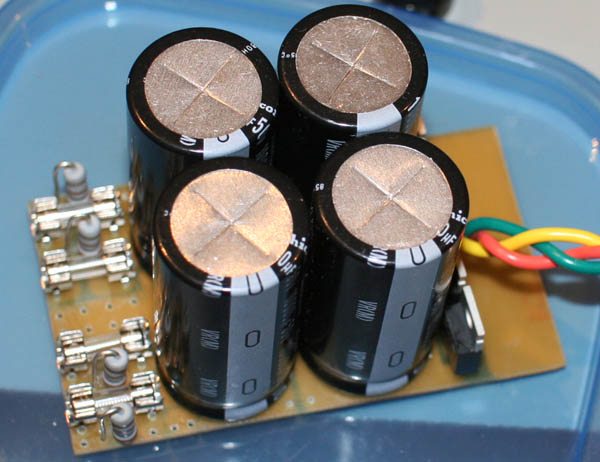

PSU is 'finished', ready to have output wires soldered in.

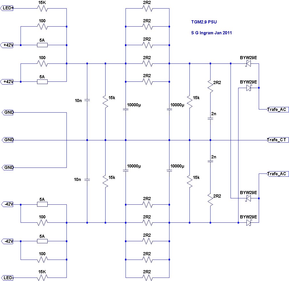

Here's the as-built final schematic. Produces 42V at no-load, takes a few minutes for the bleeder resistors to discharge the caps.
Soft recover diodes, 50V caps.
100R in parallel with 5A fuses helps keep the rails up if a fuse is lost and allows no-load preliminary test of amp by connecting with fuses removed.

Sweet! You don't have any high frequency bypass caps after the rectifiers though. A small issue that can be fixed if needed by tacking them on on the board bottom. 100nF ...(dirty word warning!!)...ceramic.
Joined 2009
Good idea. In fact, the high freq bypass on the last pair of caps are also ceramic - nice Japanese one's from an old Yamaha receiver. I'm less worried about Ceramic in the PSU but more nervous of using them for something like Cdom.

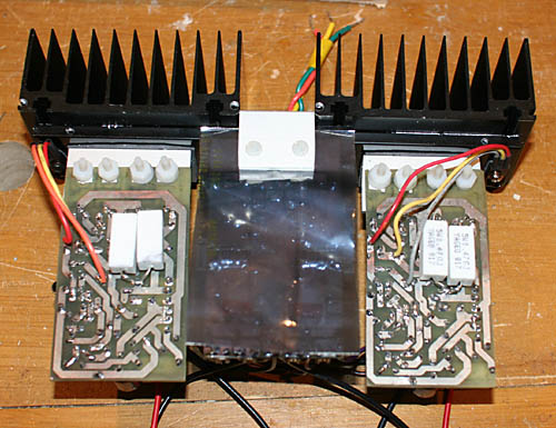

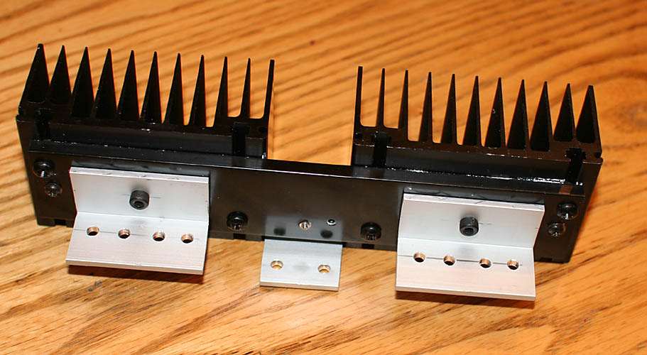

I'd be interested in some ideas and thoughts from the forum on this next step in the process.
I've got a heatsink now, pulled out of an old chasis. The two TGM2 amplifier boards and the new power supply all need to be mounted to the heatsink so that I end up with a simple 'module' to install back into the chasis.
I was thinking of a simple 'L' bracket.
But I'm toying with the idea of reusing the big power transistors still stuck to the heatsink. I'd have to mount the pcb's to the heatsink with a small bracket and then fly wire the power devices to the existing pcb's after first removing the existing TO-220 power devices.
The benefit is a better thermal design for the power output devices - very attractive proposition. As you can see from the photo, the fly-wires could be short but not zero length. Although I've seen other amplifiers use off-board power devices I'd be interested to know from those of you with the relevant experience how much trouble I might be getting myself into if I go that route ?

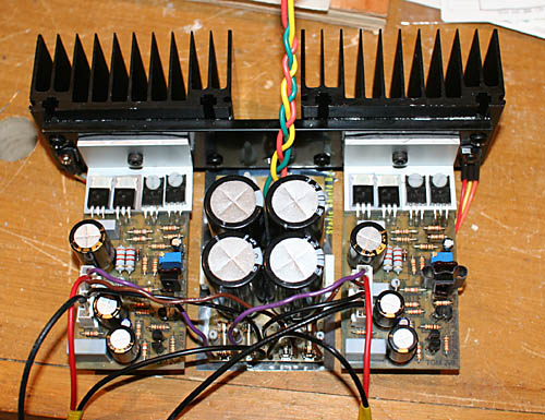

I've attached the pcb's to the L brackets and installed the wiring. A flap of anti-static bag was cut and attached underneath the power supply pcb to ensure adequate isolation from the floor of the chasis.
The LTP tail resistors have been increased from 6k8 to 8k2 to allow for the higher rail voltage.
I'll wheel in a bench top supply with a current-limit to test it out before I plug it in.
Lookin good!
Did you test the power supply board?
There are a lot of junctions before the heat from the output reach the heatsink, did you put thermal grease at each join?
BTW, what happened to your idea in post #204, to use the larger devices already attached to the heatsink? What were these anyway?

Hi John,
Thanks for taking a peek... yep I've tested the psu to the extent of measuring the voltage under load (haven't put a CRO on it yet) and found that the SMD resistors in the rails, between capacitors, were dropping too many volts so I strapped them with a good olde fashioned thru-hole 0R33. Otherwise seems good.
I don't have any thermal grease - I've used something my work colleagues call 'gap pad'. It comes in sheets, feels like rubber. To use it you cut a piece out the size you want and peel off the plastic from both sides. Put it between the two parts you want to thermally couple and then bolt them together. The stuff squishes out between the two parts. Not yet sure I'm going to be happy with the large thermal distance between the Vbe multiplier and the output devices - the Vbe multipliers are bolted directly to the heatsink rather than the same bracket the output devices are bolted to. I may end up looking to glue the Vbe multiplier directly to an output device.
I didn't see a solid way to mount the pcb's to the heatsink without a bracket and not having metal in my junk box I was ultimately at the mercy of what I could find at Home Despot, so I abandoned using the existing parts. I don't know the history of the original parts - they are the same as what you used on Patchwork.
Ah, that isolation material should be good. I have thermal grease but stopped using it in favour of a wax/silicone based lube in a stick form. It is what I used (along with mica washers) in my 6 channel Patchwork and that has been running for nearly 2 years without a problem. Any future projects will be the stick lube and a thin layer of water based urethane on the device itself for electrical isolation.
The vbe multiplier may be fine where it is, depending on the idle current you'll run and the case configuration. Still, given that they are on flying leads, you can easily get them closer to the outputs. If that gap pad is adhesive, maybe use it to glue them down. At least you have a chance of cutting them free if you want to change something, unlike epoxy.

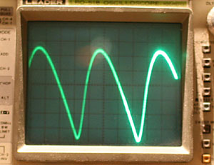

I put a scope on the power rail at regular idle current. Get around 30mV pk-pk of ripple. The ripple doesn't appear to have any nasty h.f. content so the CRC is doing it's job.

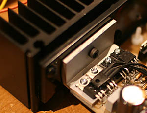

I've used Silicone to glue the Vbe multiplier onto the output power devices. Wow, MUCH better bias stability - rock solid now, although not tested into a dummy load yet.

Gareth,
If you fail to tighten down a single output device, it will quickly heat more than others and hog the current, particularly with a small Re, rapidly entering thermal breakdown. The equivalent with an auto engine is tightening the big end bolts (or is that Bigun bolts?) to the precise specified torque.
BTW, sharp transitions on ripple are equivalent to HF by Fourier analysis. The key is probably to have really good PSRR.

Hugh,
Thanks for the advice - I'm sure you recognize some of your inspiration in this design.
Yes, I found that I was looking for the hottest device and then tightening the screws, going on until all the devices were well behaved. But, with the Vbe multiplier on the main heatsink there was just too much distance between it and the power devices and no amount of screw tightening would make it stable enough in my opinion.
I did have the joy of experiencing full thermal runaway, once on this project and once with an old Ford - cracked the cylinder head!
