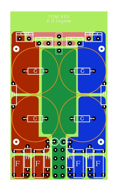

My next step at this time is a proposal to make a Stereo-only version of TGM2, modules mounted to a larger heatsink. For this purpose I'm going to make a new power supply with the same design as my original (used in Home Theatre setup) and same high quality components (ultra low ESR long life 105degC Nichicon filter capacitors for example).
The schematic and first stab at a layout is attached - showing a pcb about the same length as the TGM2 amplifier module itself (shown alongside it).

I think a bit more capacitance might be better, so I've redesigned based on some larger caps. This allowed the board to shrink slightly. I have a few SMD chip capacitors I will mount underneath to bypass the large caps.

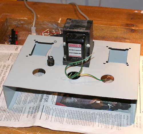

Also made up a test chasis to provide a source of low voltage AC to test that the psu board is working properly after it's made.

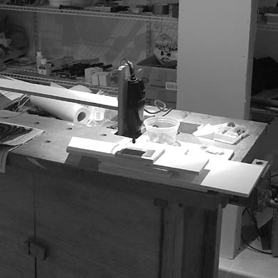

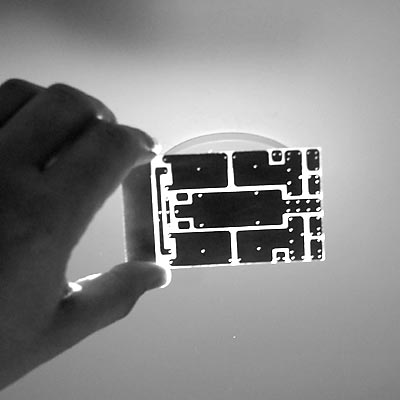

Making the psu pcb. First the iron on toner transfer with ye ole magazine paper, then into the etch bath. I use special ex-Lasagne basins - that way you get to eat and do DIY. I use two of them nested with bottom one full of hot water to make a bath for the top tray full of Ferric Chloride. I recommend chopsticks for dual purpose of stirring and flipping around of pcb during the etch.
Holding up to the light shows fairly clean etching - not perfect but plenty good enough.
Next the toner is removed and it's ready for the drill press - itself a DIY creation.
Progress is made!

I love the smell of dissolving copper in the evening!
Experimenting with b&w photography? Adds a vintage, 50's look to the proceedings.
Might that be muriatic in the morning (like a poor man's napalm) 😀 It seems the m.o.a.n. "thing" is serious business. Us 3 probably churn out more than 1000's of verbose (blah, blah, blah) DIY'ers. 😀. Canadians and Australians seem to build the most and the best. 😎
Another magazine abuser 😎 ... he hee ! FeCl .. too expensive ! My trick is to get the etchant rather hot. (the board below) with minimal etched surface took 140 seconds. Perfect with no pits. Gotta show the 1 pixel hairs on the dog to john ... next "etchfest" (soon). PS's are fun, aren't they... BG ! Big traces , lots of tinning .. making the layout streamlined , big fun. 😉

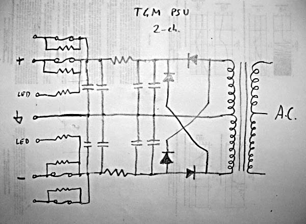

Well that little transformer I set up as a test station was too low voltage to be relevant so I swapped it out for two bigger ones that each generate 30V A.C. - much closer to the final application which uses a 30-0-30.
I didn't wire it up wrong, honest...:headbash: But I happen to know, that if you accidentally swap the centre tap wire with one of the AC wires when you connect the transformer to your power supply board it becomes a very good voltage doubler and makes the over stressed capacitors quite warm. Of course I didn't do that, but I thought it worth mentioning !
I did that and I also broke my own rule, no bulb in place.
The only damage was a blown 3886. All the other components were perfect.
Now that you've told me it is a voltage doubler, that explains what went wrong. I will draw it out and see the circuit.
