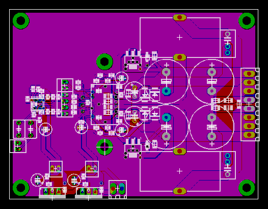

I'm sitting at my PC, and inbetween job hunting I'm starting to convert Brian's schematic to through hole components. I'm looking at 12mm spacing for the resistors, a compromise between size and general availablity, and MJE15030s for the regs. Apart from the input caps, where I will allow for the option of bigger ones, I'm thinking 5mm pin spaciing for all the film caps.
Al, 12mm spacing for the resistors is pretty large and will take up a lot of room. I would go with a smaller spacing if possible. I made packages for the output filter caps so that either 5mm or 7.5mm lead spacing types could be used. I plan on using 5mm lead spacing polyester film types initially.
The transistors that regulate the 12V gate supplies should have a reasonably high DC current gain (~100) and a minimum Vce rating of 60V. If you choose a transistor with a lower gain I would lower the value of R11 and R12 to allow more current to bias the zener. Be careful of the power dissipation in R11 and R12 if you lower their resistance.
Also, you could use either a 12V or 13V zener. I would probably choose to use a 13V zener, but wrote 12V in on the schematic.
Hi Brian
12mm for the resistors seems to be a good compromise, it allows most 1/2 and 1/4 W through hole resistors to be used. Yes, the size of the board will be compromised, but I'm good at compact designs, and this supposed to be a little different to yours! 😉
I misread the datasheet for the gate supplies, now I've checked, I've seen they need a lot less current than I originally assumed, so something like an BC546B or C should work well, unless you know better of course!
12mm is a good compromise, but the majority of the resistors need only be 1/8W or lower. Anything larger is just eating up a lot of space and could compromise the position of other important components.
You're right that the gate supplies don't need much current at all. I over engineered them on purpose because the draw from those supplies will be pulsed current at the rate of the switching frequency. You can certainly get away with lower current transistors. You can put a resistor in series with the collector to shift some of the dissipation away from the transistor as well. A TO220 transistor would easily be able to handle the dissipation.
After reading the data sheet one more time... I've decided that it would probably be best to just leave the OTW and SD pins disconnected. The reset pin will still be connected to 3.3V through a resistor and to ground through a switch so the reset function can be toggled by the user. Other than that, my layout is finished.
What I understand is that OTW and SD would be connected to a microcontroller to make further operations, other than RESET, in case of errors: turn down volume, send a message to a display, light leds.... We can survive without.
