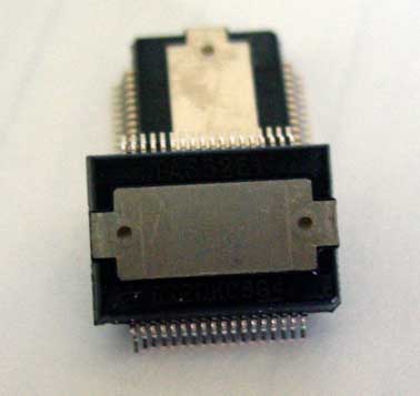

The chips came in the mail today. Thanks Al!

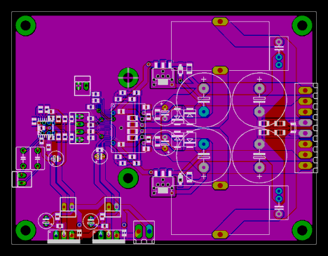

Now that the weekend and the booze are all gone it's time for an update. The layout is almost done. I still need to connect pins 8 and 16 to power ground at one place and have an idea of how I want to accomplish that without moving too much around. The other things that need to be done are routing some of the traces for the reset and protection connections.
I do have a couple questions regarding the reset, SD, and OTW pins for mp8 and/or kims if they'd be able to help us out. I wanted to use a switch to be able to control the reset pin, so the reset pin would be connected to 3.3V through a pullup resistor and to ground through a switch. When the switch is closed, reset is grounded and the chip goes into reset state. When the switch is open, reset is pulled high and the chip is operational.
*Is it ok to use the Vreg pin as the 3.3V source for the pullup resistor?
Since OTW and SD and active open drain ouputs, I was hoping it would be ok to connect both OTW and SD directly to the reset pin so that the chip would be forced into reset mode if a fault occured.
*Is it ok to tie OTW and SD directly to the reset pin?
I also tidied up the silk screen layers and started working on gathering basic specs for the components. I have a pretty good idea of what I want to use for most of the parts so that shouldn't be too tedious.
The attached image of the board is with both layers turned on, so it's a little difficult to see the details but you get the idea. I'll post the schematic for this layout once I figure out what to do with the reset and protection connections.

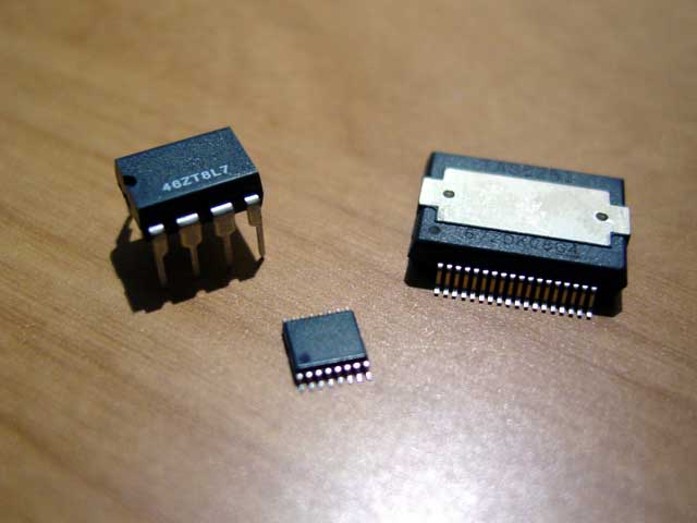

Anyway, the TPA2001D1 samples arrived and boy are they tiny little fellas! They're the same size body as an SO8 package but with 8 pins per side instead of 4. I would imagine some will have trouble soldering this guy. When we get to that stage I can solder that part on for people if necessary.

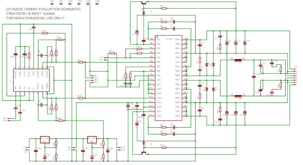

I got tired of waiting and connected things as I saw fit. Jumpers/resistors can be left out if the sd, otw, reset connections don't work. They're not that big of a deal anyway.
As promised, here is the schematic. I will make sure I have the correct information for all the parts before exporting and uploading the parts list.
