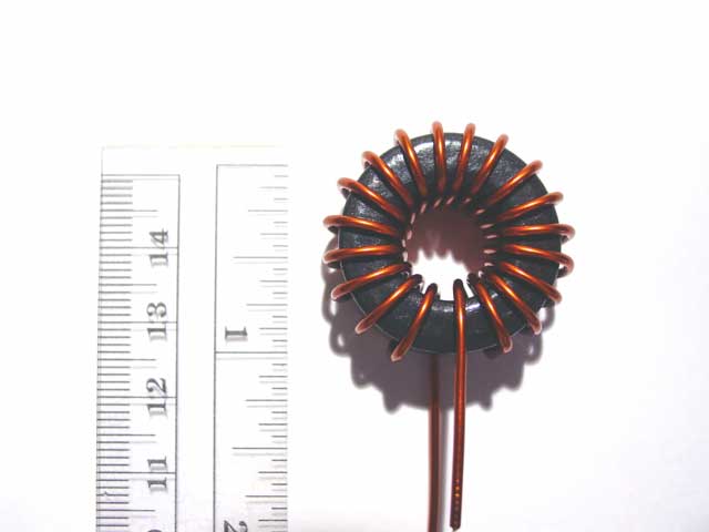

You can find the MPP T106 cores listed here: http://www.cwsbytemark.com/prices/mpp.php
The ones I will order are part number CM270060. They're made of molypermalloy (MPP) with a permeability of 60.
Here's a link to the technical data for the T106 cores: http://www.cwsbytemark.com/CatalogSheets/MPP PDF files/40.pdf
It takes 2.5 feet of 18ga wire to get 18 turns on the T106 cores (with some air gap between windings). The finished inductor should look something like the attached photo. I'm changing the wire gauge from 16 to 18 because 18 is hard enough to wind and shouldn't make much difference over 16ga.
I believe Thomas had measured the inductance of his T106 MPP cores (permeability of 60) to be about 11uH with 13 turns of 16ga wire. It shouldn't be much different with 18ga wire.
Yep, 13 turns on those cores isn't hard to do. It is hard to keep the 16 and 18 ga wire flat to all sides of the core. At least you'll have a hard time breaking either the core or the wire if you pull really hard.

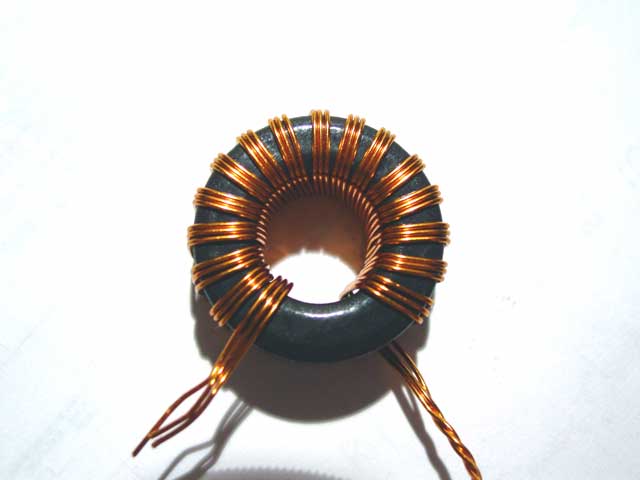

I also tried winding a core with 3 0.7mm diameter wires side by side. This tried my patience a little but it can be done and looks pretty cool. Don't know if it would sound any better than the single 18ga wire or not but the windings are much closer to the core all the way around.
