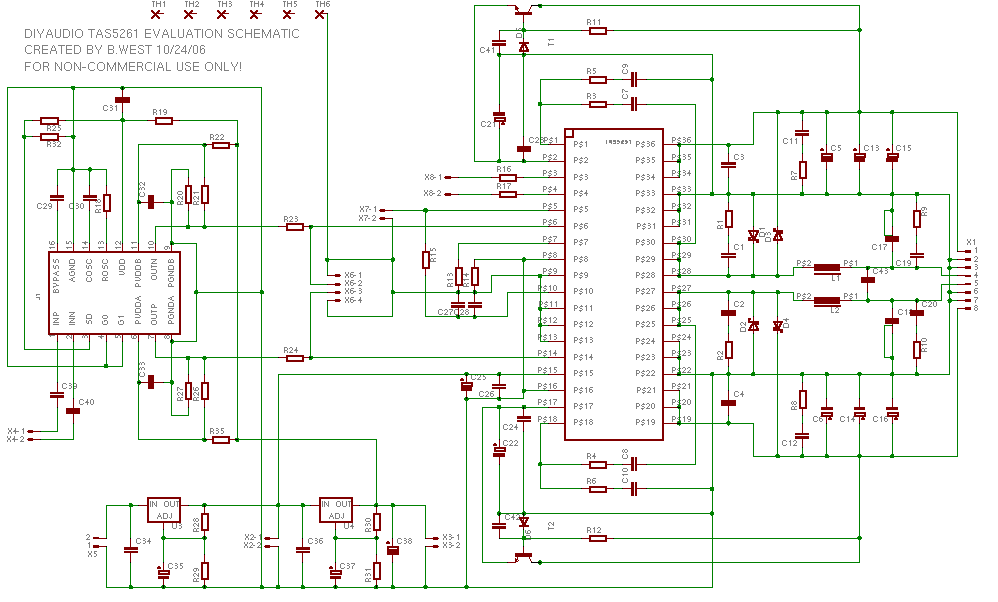

on your BOM these caps are double?
C13,C14,C15,C16 1500uF 63V FC E7.5-18 P10356-ND 4
C13,C14,C15,C16 1000uF 63V FC E7.5-18 P10355-ND 4

I've been scouring data sheets and have found what appear to be good alternatives to some of the larger electrolytic caps. Attached is the full, updated bill of materials for my evaluation board (EVB). It includes part designators, a detailed description of the part, the package footprint, digikey part number, and quantity needed for ONE board.
The lines next to each other in bold indicate different parts that will work with the board. The recent changes that allowed me t reduce the price was the change from large electrolytic Panasonic FC caps to United Chemicon KZE caps with the same rating. The United Chemicon KZE caps have even lower ESR ratings than the FCs and are cheaper, so I figured we could give them a try. I also included the information for 1000uF and 1500uF caps although the kits will include 1500uF KZEs.
I've also added some standoffs and screws to the BOM since we'll need some way of mounting these boards 🙂

" ... I've been scouring data sheets and have found what appear to be good alternatives to some of the larger electrolytic caps. ..."
Best way without making circuit board real estate too excessive: just "snub" 'em.
Parallel the needed electrolytic with a lesser value poly "audio quality" cap. These can be in a ratio of anywhere from 20 to 1 to 1000 to 1. Ex: The main, fat 1000 uF electros could have a 1.0 uF poly / audio quality cap in parallel = snubbing down the master PS filter(s). This "sweetens" the leading edge of any "noise" that be might get through, the larger the Poly value, the "sweeter" to the point of almost complete elimination of any noise getting passed through the caps. The poly "audio quality" caps generally are much faster responding to rapid changes than the fat electrolytics ... the "sweetening" effects of the audio quality caps responding faster to the more dramatic changes in power requirements (mostly voltage changes) that may be passed through to the output stages in the form of temporary reduction in the dynamics of the fat electrolytics. == It does work as many of the folks building tube amps will testify.

FastEddy said:Best way without making circuit board real estate too excessive: just "snub" 'em.
There are 4 caps on each power rail - 2 large 1500uF electrolytic, 1 small 100uF electrolytic, and 1 0.1uF ceramic right between the power and ground pins of the chip. Poly caps are great for bypassing but they take up 3-4 times as much room as the ceramic bypass caps do. Plus, ceramic SMDs have less parasitic inductance than any through hole cap.
There are also snubbers (RC in series) between power and ground right by the chip pins. This is where surface mount parts give you and advantage. You can have more optimal placement, less parasitics, and they're usually cheaper than through hole parts. If you're not afraid of soldering them, they're definitely the way to go for class d.
Also, I made some little changes to the schematic. Attached is the schematic for the boards that I will be ordering. Designators match the full BOM that I posted above.

" ... 2 large 1500uF electrolytic, 1 small 100uF electrolytic, and 1 0.1uF ceramic right between the power and ground pins of the chip. Poly caps are great for bypassing but they take up 3-4 times as much room as the ceramic bypass caps do. ... "
No problem-o = there is plenty of room off-board for those of us desirious of flavoring or sweetening up our power rails with extra plastic caps or whatever. I plan on driving mine from +24 VDC and the supply will have plenty of the goodies that I appreciate ... I'll let you all know about any successes ... or not.
