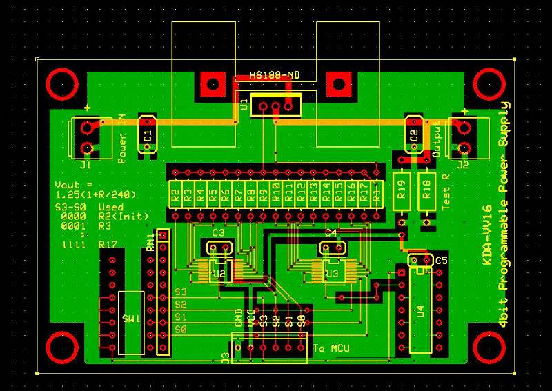

I ordered attached, instead of LAB PS.(using LM317 - FET Switch)
It will control 2V - 13V PSVC(0-15dB), from MCU.
