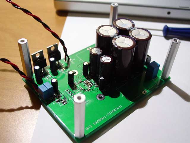

I test fit all the non surface mount components on the board and it looks pretty menacing with the large supply caps and inductors sprouting from the one side of the board :devilr:

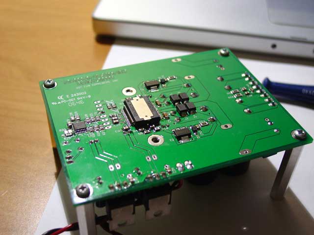

I got one board fully built up except for the inductors. I managed to find some 1kohm 0805 resistors from another project, so I just soldered two of them in parallel to get 500ohms. That sets the 3.3V supply closer to 3.5V but is fine for testing.
I found a 15VDC wallwart supply, connected it to the 15V input, and tested the TPA2001D1 circuit. It works very nicely with an iPod as the test source! I had to change R23 and R24 from 10kohm to 0ohm because the 10kohm resistors and the input capacitance of the TAS5261 combined to form a low pass filter that created a sawtooth wave at the inputs of the TAS5261. Changing the values to 0ohm allows the square waves to pass through unattenuated. The square wave produced by the TPA2001D1 is nice and clean on my scope. It should be considering there are 3 levels of filtering for this chip's power supplies.

I'd like to point out that the board is intended to be mounted with the chip facing upwards so that a heatsink can be placed on top of it. If you choose to mount the chip directly to a metal case you may cut the long standoffs to shorter lengths and place them at the four corners for better stability. For testing they will just sit on my desk/bench with a heatsink rubber-banded/zip-tied to the chip.
Stay tuned for more tomorrow.

" ... If you choose to mount the chip directly to a metal case you may cut the long standoffs to shorter lengths and place them at the four corners for better stability. ..."
Advise from afar:
1) For those of us concerned about such things: there is the possibility of long term galvanic activity when fastening to a steel chassis (and some other types of metal). I advise using the stand offs of the type found in electronic surplus houses ( as Brian has indicated he is obtaining) and an aluminum chassis = no galvanic activity questions.
2) The actual length of the stand offs should be almost exactly equal to or very slightly greater than the gap between the circuit board and the metal plate of the chassis ... If the stand offs are too short they can distort the circuit board upon tightening the mounts = possible board breakage or reliability problems = especially critical in mobile applications. (I intend to use plastic / nylon mounting screws on my mounted board so that they can not be tightened too tightly ...)

FastEddy said:
Advise from afar:
That is excellent advice. The standoffs included with the parts kits are aluminum with an iridite finish (whatever that is); 4-40 thread size (6 screws will be included as well). Also, the pads that touch the standoffs are not electrically connected to the board in any way. One of the through hole pads next to the TAS5261 is connected to AGND, as it is recommended that the heat sink connected to the TAS5261 heat slug be grounded.

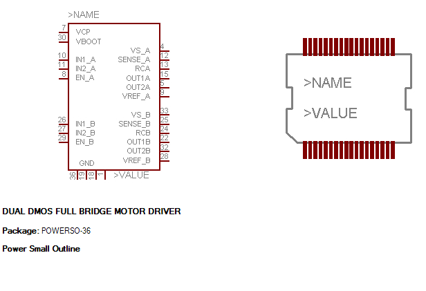

Instead of the layout could you post the TAS5261 library file. That is all I really need. I also called TI and requested the recommended PCB footprint for this part. If TI recommends dimensions other than the used library, I will post the corrections to the DKD (R-PDSO-G36) footprint.

Yes, I can post the footprint I used when I get home. It's a modified version of the PSOP-36 package that is actually somewhere in the eagle libraries. I found it once but can't remember which directory it was in.
Did a quick search and this is what I found. The L6207PSO36 from ST-Microelectronics. Don't know whether this is the one you mean.
Regards
