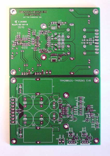

Lookin' real good!!
(Next rev. I might be asking for the impossible: surface mount parts on one side, taller passive / active parts on reverse side. The idea would be to mount the board flat with the sm chips down, thermally connected to a flat aluminum case bottom to act as heat sinks for the board chips, the tall caps & coils, etc. sticking up = thus making for installation in a very slim height case.)
The parts should be here next week. Time permitting, I should be able to have a board built and ready for functional testing late next week. If all goes well I'll start putting everyones orders together. If you just ordered a board and cores/wire your order will get shipped out sooner than those with parts kits.
FastEddy said:Lookin' real good!!
Ed, you can do that with this board! I designed it that way from the beginning 🙂 It is intended to be mounted with the TAS5261 thermally connected to a flat aluminum heatsink of any size. The TAS5261 is the tallest component on that side of the board.
The wound toroids will have a height of about 1.25" off the board and the 4 large electrolytic caps will be the tallest components at 35.5mm for the 1500uF 63V caps I'll be using.
" ... I designed it that way from the beginning It is intended to be mounted with the TAS5261 thermally connected to a flat aluminum heatsink of any size. The TAS5261 is the tallest component on that side of the board. ..."
Well, Super!! (I didn't catch you napping) ... good approach = low profile board w/ large heatsink covering about the same sq/in. as the board itself plus a little more width & depth for connections, knobs, etc. = makes for a nice small container.
