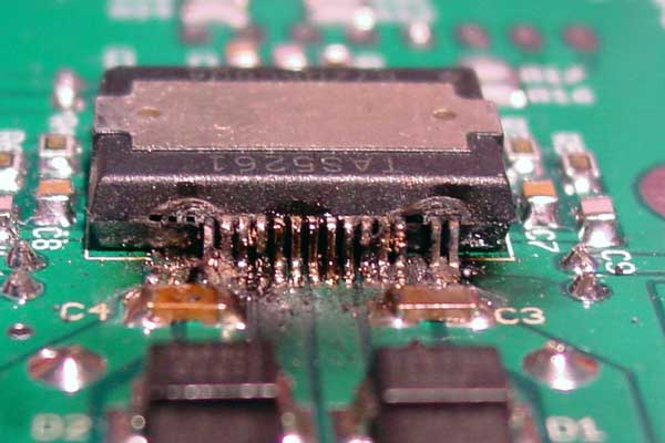

Well, there still hasn't been any smoke, but earlier this morning there was quite a shower of sparks that came from my desk while testing near full power... You can see the extent of the damage in the attached photo. No other component showed visible damage. I'm not sure exactly what caused such a catastrophic failure, but the TAS5261 wasn't the only part that bit the dust. Also on the casualty list was the TPA2001D1 and the two zener diodes that serve as the reference for the 12V gate supply transistors (not sure how they could have been fried unless a very high surge current was drawn through the gate supplies when the 5261 failed). Surprisingly nothing else was bad, including the bypass caps right next to the power pins of the TAS5261. Even so, I replaced them and the other dead parts earlier today, as well as changed the values of a couple others, and the board is up and running again.
Amazingly enough there was zero damage to the PCB except for some solder mask that was vaporized along with the power pins of the chip. Now that's a quality PCB!
While I'm not too sure, my gut feeling is that the damage was caused by my wiring job and the TPA2001D1 sending a not so nice signal to the 5261. I had some very bad pops, noise, and oscillation on my test speaker when I had just connected the input ground and signal to the INN and INP on the board. But I forgot that INN and INP are connected to the 2001 through coupling caps. When I connected the 3.3V supply ground to my preamp ground all the humming, popping, and harsh noise went away.
My ground wire between the two was less than optimal, as it wasn't even soldered (don't be careless when dealing with higher power circuitry), and could have moved around and caused a pop or transient that the 5261 tried to replicate but could not and a result failed quite spectacularly.
One change I made was to raise the value of the current limiting resistor to 27k which should lower the current limit threshold to something around 13A. Even though the current limiting protection circuitry isn't fast enough to stop a current surge similar to what may have happened in my situation, every bit helps while testing.

" ... I'm not sure exactly what caused such a catastrophic failure, but the TAS5261 wasn't the only part that bit the dust. ..."
Dust, cat hair, belly button lint ... contamination between the chip leads?... Any of these plus minute solder errors or trace spacing ... happens all the time. 😡
I hope you don't use up too many boards & chips before you discover the root causes ... keep the faith.
(13 amps is quite an electron flow for those tiny traces. If you can isolate which one blew up first or is at the center of the burn area, then you might have the answer.)

All joking aside, I was pretty pissed when I saw the sparks fly. I hate seeing things blow up like that mainly because then I know I have repair work to do.
There wasn't any contamination between the pins because I thoroughly cleaned the board off with a brush and denatured alcohol. I cleaned the board even better after I replaced the chips and the other components.
I've got some spares of all the parts but unfortunately the 5261 chips are the ones I need to be careful with. I don't think I'll use up any other boards because if the board wasn't harmed after that last incident I don't see how you could unintentionally damage it otherwise.
You can see in the photo that the PVDD pins on both sides of the chip were what fried, not the traces connecting them to the caps. The PGND and output pin connections looked intact for both bridges, so high currents killed the high side mosfet first on BOTH bridges. Keep in mind that the PVDD pins for each bridge are electrically separate on the PCB and are connected together back at the positive terminal of the large 33,000uF cap. There are schottky diodes between the output node and ground and the output node and the PVDD rail so that if the output node voltage swings a diode drop above the PVDD potential or a diode drop below the ground potential, the diodes will conduct and prevent the voltage from going any higher or lower which can damage the chip. It's possible that the initial overshoot of the PWM output signal caused the upper diodes to conduct and boost the rail voltage above the breakdown voltage of the internal FETs, causing them to break down and fail short circuit.
That's one theory anyway...

I didn't thoroughly examine the PCB layout ... looking for trace problems (trace too small, traces too close, etc.). Thirteen Amps is about 8 X 10^24 electrons = enough to weld steel ...
What do you think here?
thomaseliot said:What kind of transformer have you?
I never payed attention to that maximum of 52.5V.
I have a 250VA with 30VAC secondaries. The rail voltage is about 46V with a nominal 120VAC line voltage, a 25A IR bridge rectifier, and a 33,000uF filter cap.
The maximum recommended voltage between the PVDD and PGND pins is 52.5V but the absolute maximum rating is 71V. It should be able to withstand a reasonable overshoot without damage. I wasn't watching the switching waveform when the chip went into fireworks mode so I didn't see what kind of overshoot there was. It's hard to accurately capture that sort of event on my scope anyway.
FastEddy said:I didn't thoroughly examine the PCB layout ... looking for trace problems (trace too small, traces too close, etc.). Thirteen Amps is about 8 X 10^24 electrons = enough to weld steel ...
The power traces are as wide as three pins near the chip and as wide as the large cap pads elsewhere. 13A is a lot, but it's only a pulse unless the output is near the maximum rail voltage into a 4 ohm load. Don't forget the PCB is 2oz copper as well.
13A is also enough to vaporize the pins on a PSOP-36 part 😉

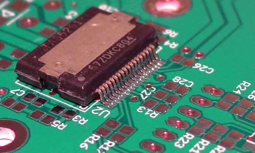

Attached is a photo showing a sample of my hand soldering.
I wil post an updated parts list when I make changes to my current BOM. Don't worry, there weren't any drastic changes.
